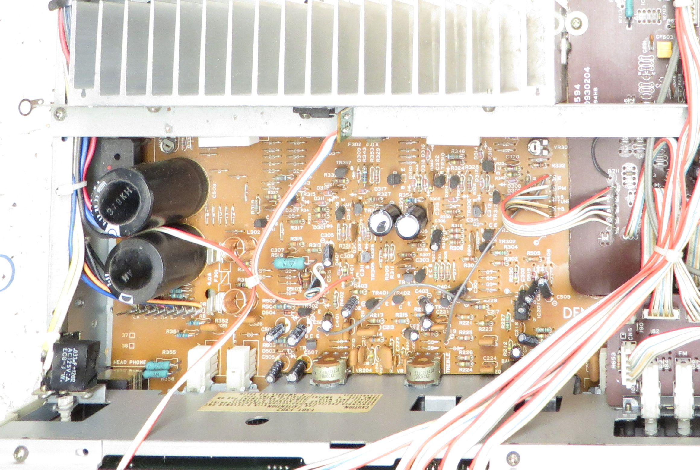

I recently found our old family receiver and put it in my room only to find out that the left channel was not working.
I opened it up to find that the left channel fuse was blown. I could not seem to find a match for that fuse type, but I found some PICO fuses in China that matched the 4A 125V.
After soldering it to the bottom joints of the fuse holder and regaining the connection, the channel still does not work, maybe something further upstream is damaged?
I have 0 experience with receivers or audio and could not find a schematic for the DRA-300. Just hoping someone might have a suggestion or schematic. I got a scope, meter etc

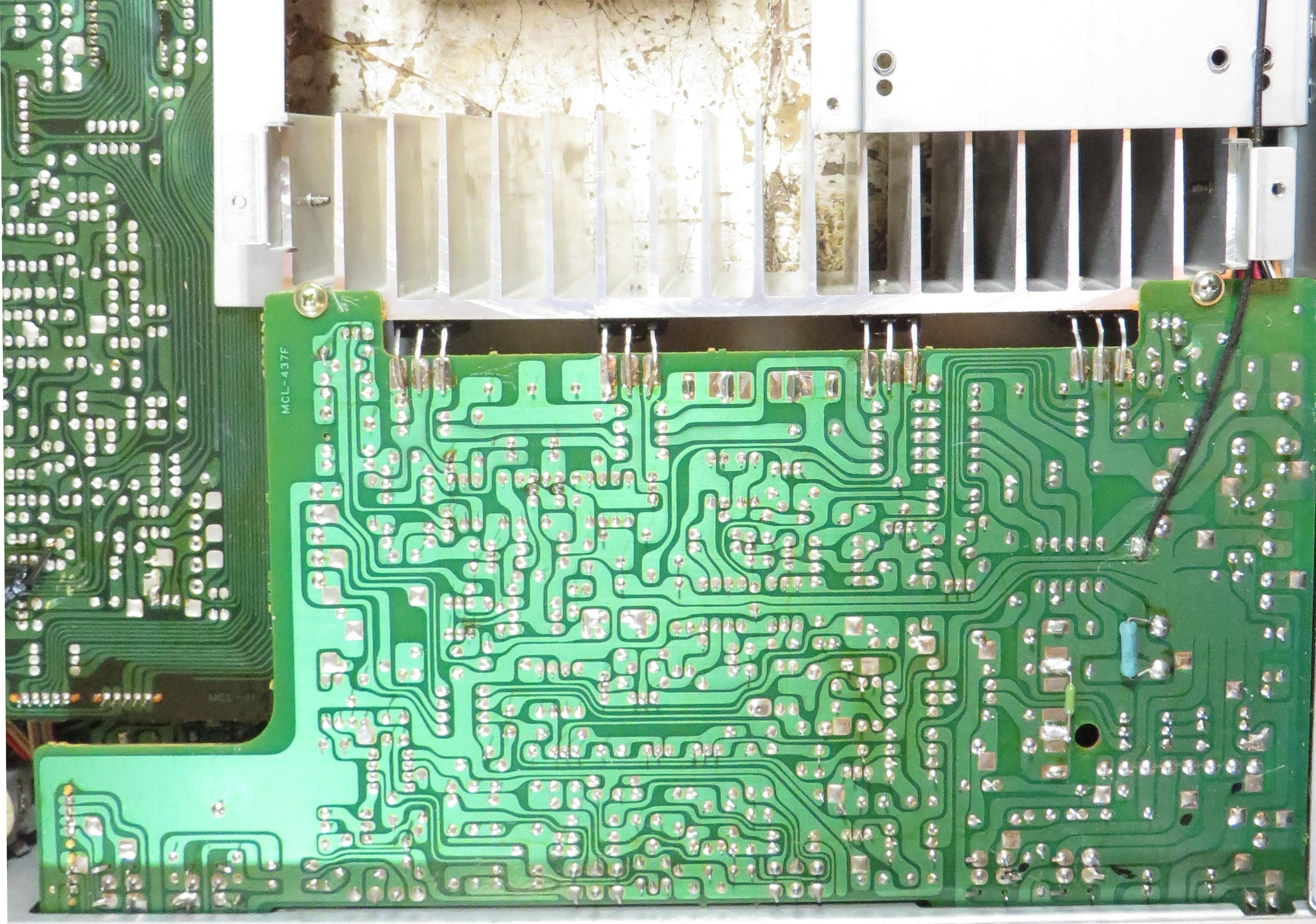

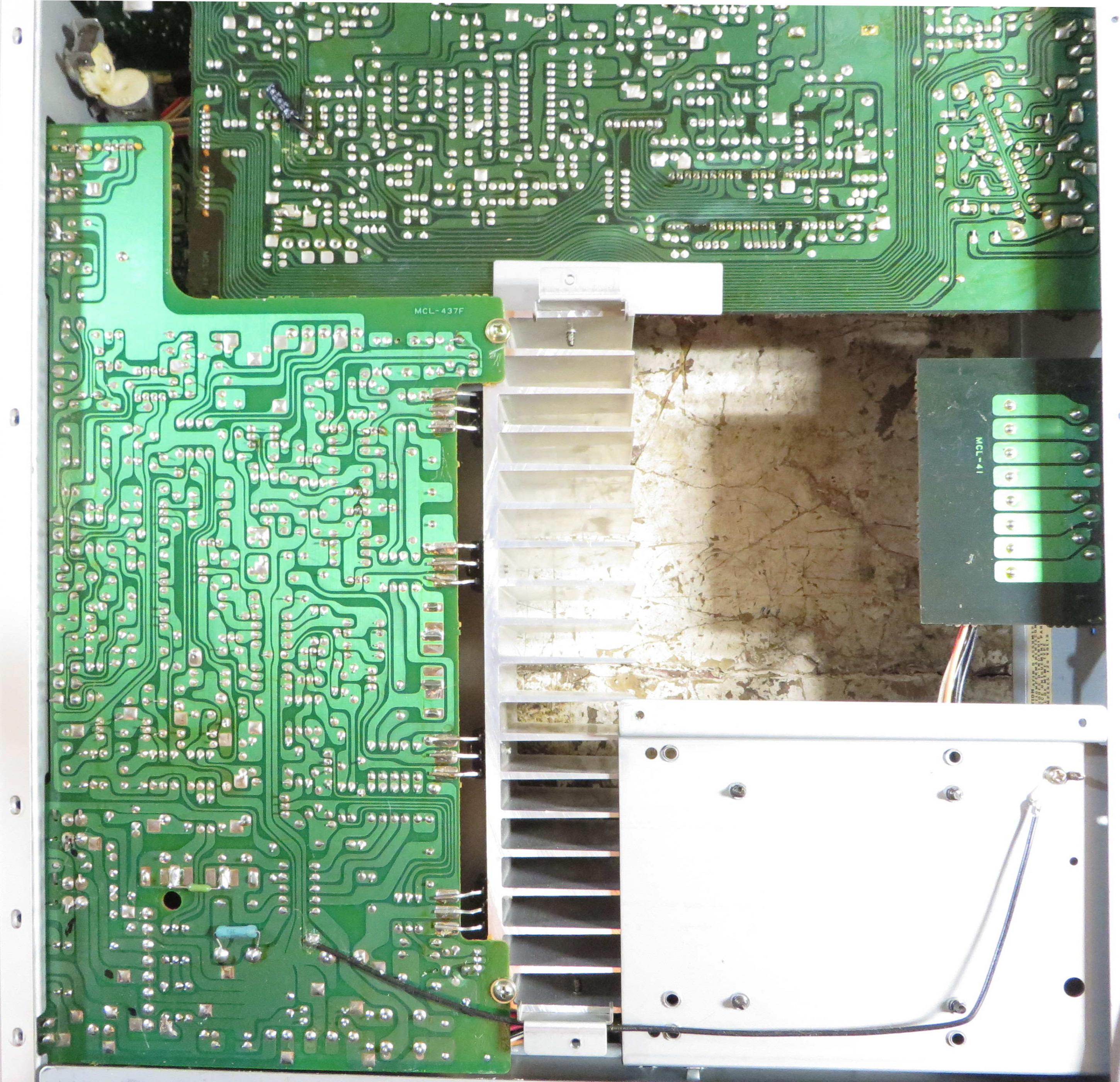

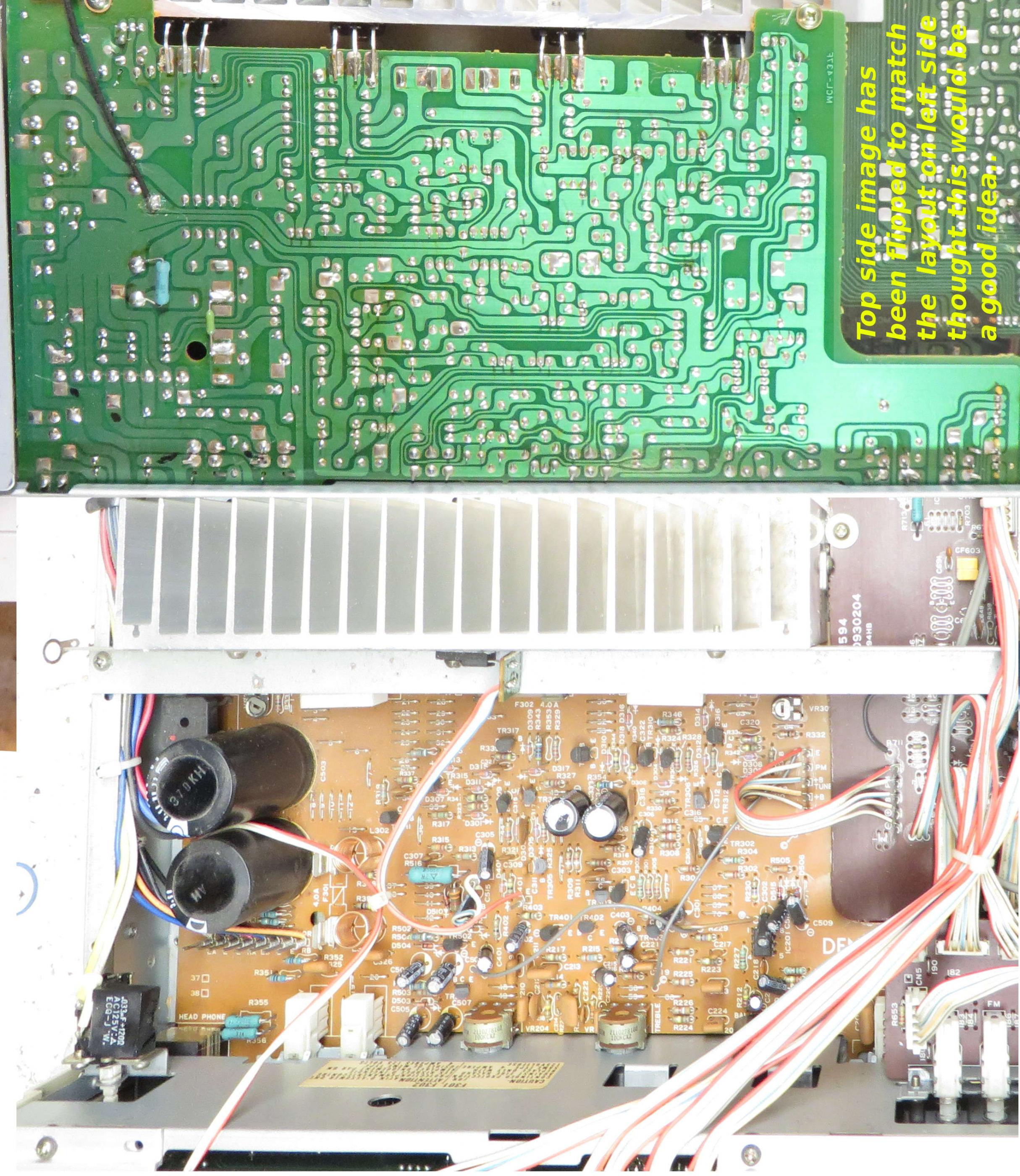

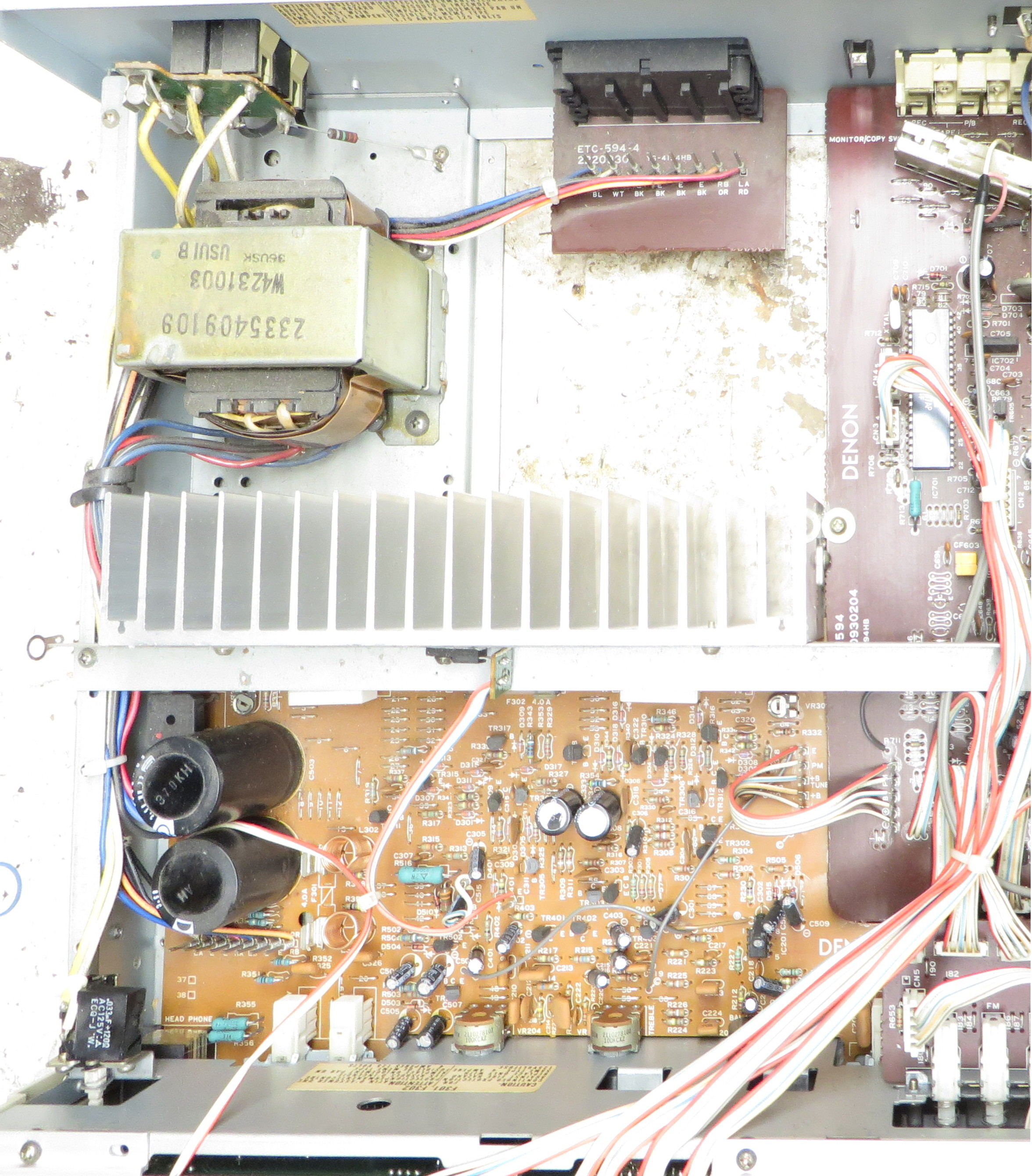

I posted the images like you said but I had to down the quality 50% to post them here. This is a link to the original photos in one gallery JIC: Imgur: The magic of the Internet
I will record the measurements on the 4 output transistors and report back. I do not believe I was getting 0 volts on the emitter leg.

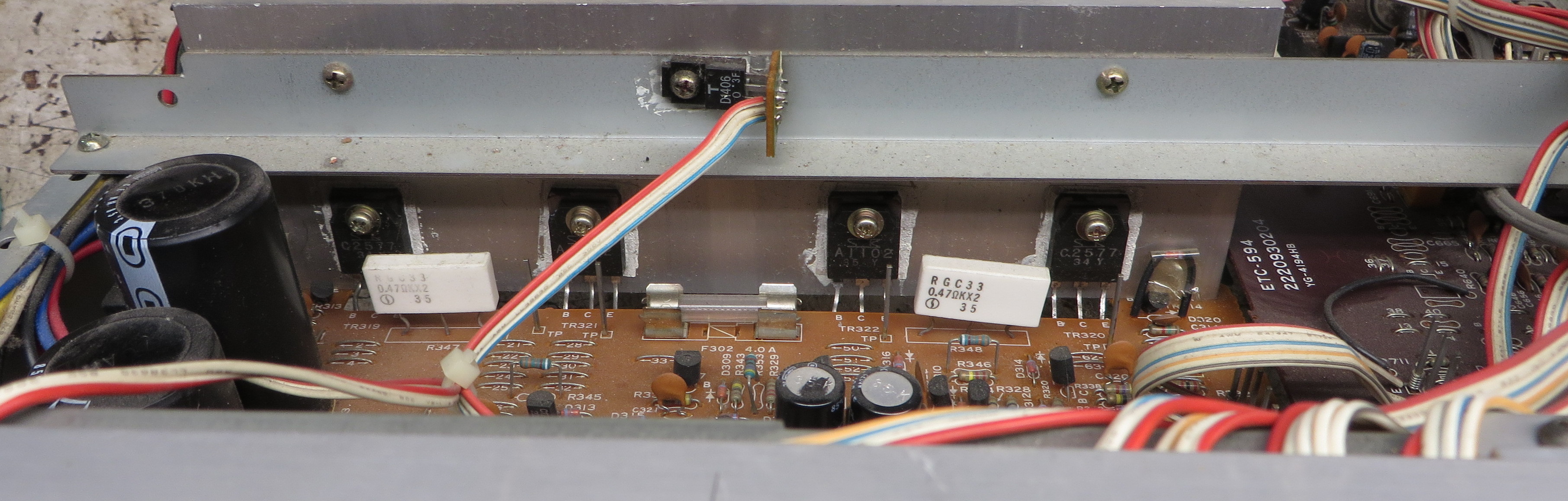

Values are +- respectively. I tested voltage with a 1000 Hz w sine wave loop from youtube
2SC2577: B= 1.27v, C= 42.6v, E= 1.09v
2SA1102: B= 0.89v, C= 42.9v, E= 1.075v
I also noticed that the left hand resistor (R347), the silkscreen print is faded while the other is very clean and legible. I know it doesnt necessarily mean it is bad, but it could be. I have never seen a three leg resistor before except for a variable resistor. Never knew these existed, should I test them? If so, how?

That last picture tells best how its configured.
The 2SC transistor should have the positive supply on the collector (your 42 volts) and the 2SA collector should have negative supply (so around -42v).
The white resistor is simple two 0.47 ohm resistors in series with the centre connection available. That centre connection is the main output of the amplifier. You can test those in circuit (amp off) and they should read 0.47 ohm from the middle leg to each end.
The DC voltage at the middle leg should be close to zero volts (no signal applied).
Both channels should give the same result.

The resistors were not registering at .47R from leg to leg. When off I am getting: 10 ohms leg to leg on R347 and 0 ohms leg to leg on R348.
Those voltages look good.
The 0.47 ohm should be low enough in value to read accurately in circuit. First check the meter reads 0.00 ohm when the probes are shorted. Any additional value will be lead resistance and must be added to the final result, however even thin test leads should be in the 0.1 ohm range.
If you still read 10 ohm on R347 then you will have to investigate further by removing the part and retesting. Also try your meter on a selection of really low value resistors.
