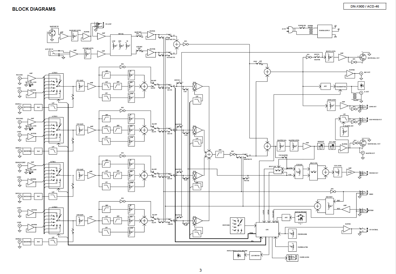

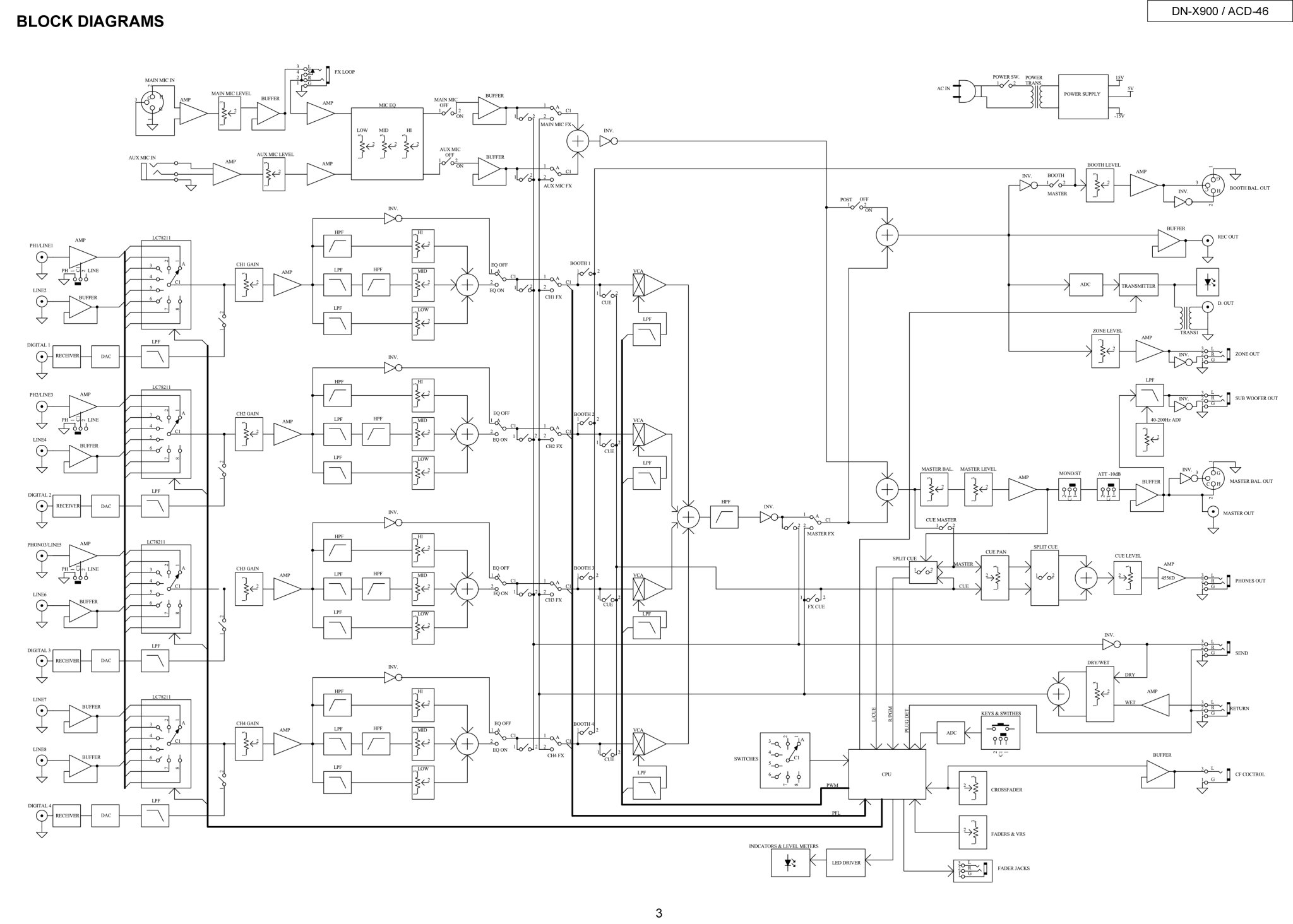

I have a Denon DN-X900 mixer that has 2 or 3 channels that I cant get sound from. I think it's two. ch3 and ch4.
In these mixers all the inputs can go through all channels ,it's a case of selecting the input you want on that channel.
I was looking at the Schematic and it doesn't look obvious to me what could be the source of the problem.
I don't have a scope so it might be difficult to find the cause of the fault.
I've had the mixer for a while. I don't have it open at the minute as I want to see where the signal goes first.
Last time I had it open I had a good look but couldn't work it out. I checked ribbon cables and a few other things.
Maybe someone here has repaired one ,or had a similar problem with these.

Im pretty sure that I had the same problem with mine. - and almost sure that the problem was due to a mechanical problem in the input-selector switch.
I think, that I ended up taking the selector apart and cleaning it, but memory is fading.
