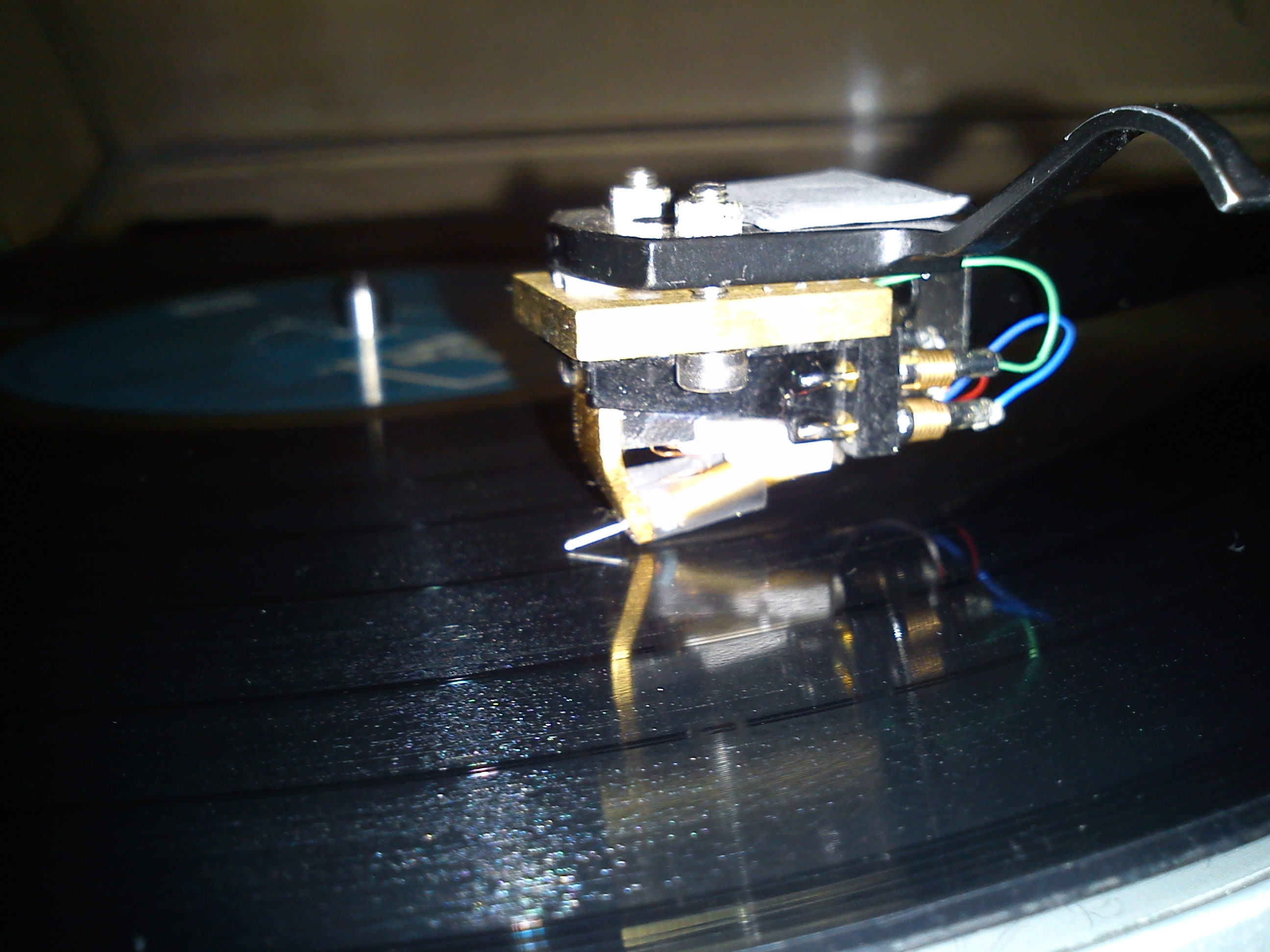

P.S. I own one DL103R without body with bronze damper to added mass.

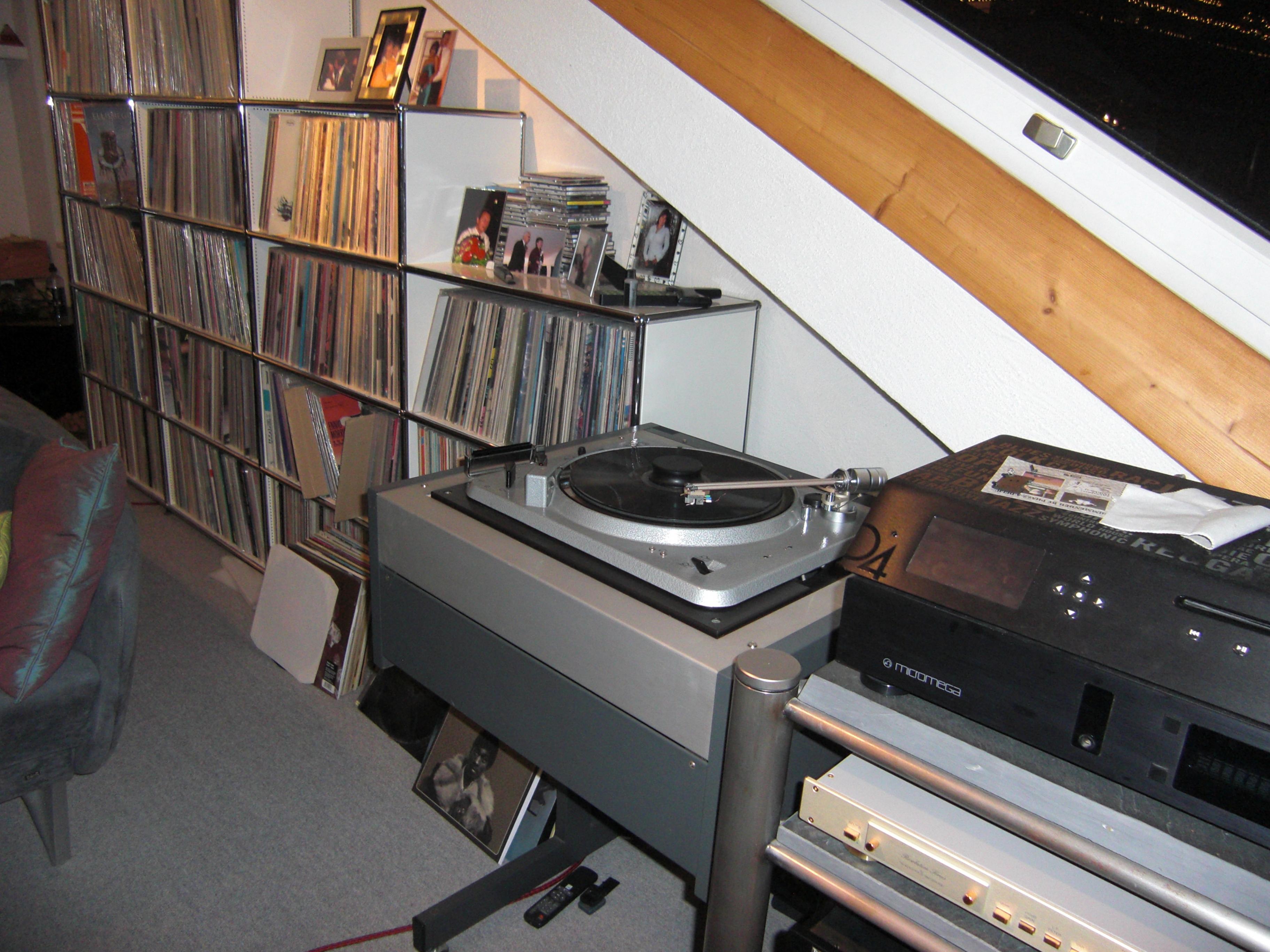

Sounds like one of these would be an excellent match for my Schick arm, but undoubtedly well outside of my price range. 😀
Can you share a link so one could drool? 😀
Or even a few pix of your setup?
And me 🙂
What's your pricing? How does it compare to the other two in terms of what you do?

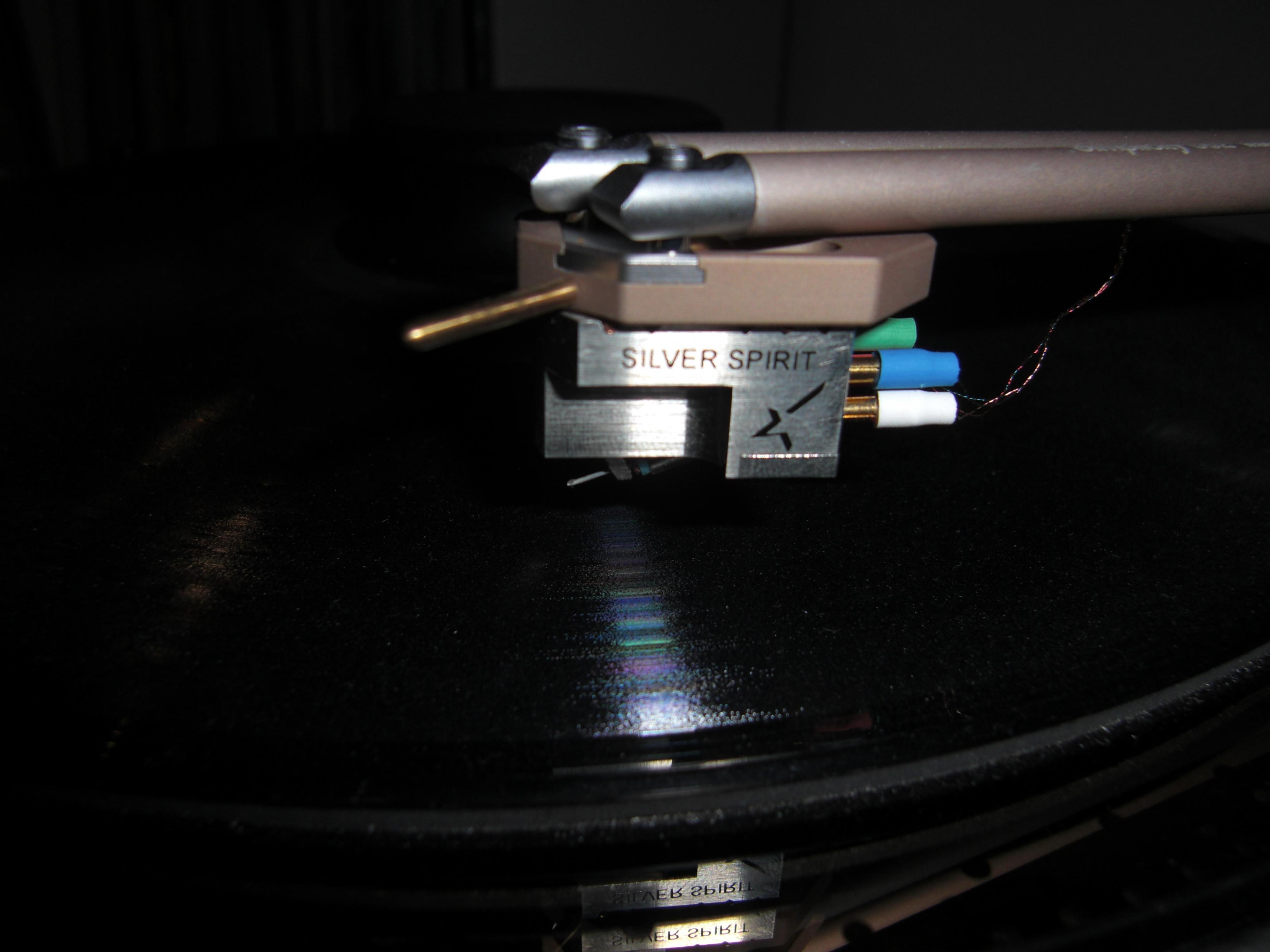

Tonearm
Simplicity ::: Thales - the one and only tangential pivoted tonearm
This is the arm in use, basically standard version, but i has an extra heavy counterweight for the Silver Spirit, so the Resonance is apx 9,5 Hz.
There are copperbars between Cartridge and Headshell and brass screws tighten just as much as necessary to achieve best decoupling from arm for clean and open reproduction, this trick works also very good for the Denon DL 103, especially if you have a modern arm with lots of damping.
The arm is lifted backside apx 3mm to achive most correct VTA with the spheric tip and the Phonostage has variable RIAA Compensation to achieve correct frequency response with old records, the connection between arm and Phono is balanced with XLRs, since the Phonostage FM 222 is really balanced.😎

Very nice, I love thre is a lot of space to connect the cables between the cart & the tonearm. FM products are very expensive, never heard one but are very famous and ultra high quality.
"There are copperbars between Cartridge and Headshell and brass screws tighten just as much as necessary to achieve best decoupling from arm for clean and open reproduction, this trick works also very good for the Denon DL 103, especially if you have a modern arm with lots of damping."
Could yous post a pic, I want more details because I use Linn Ekos medium mass.

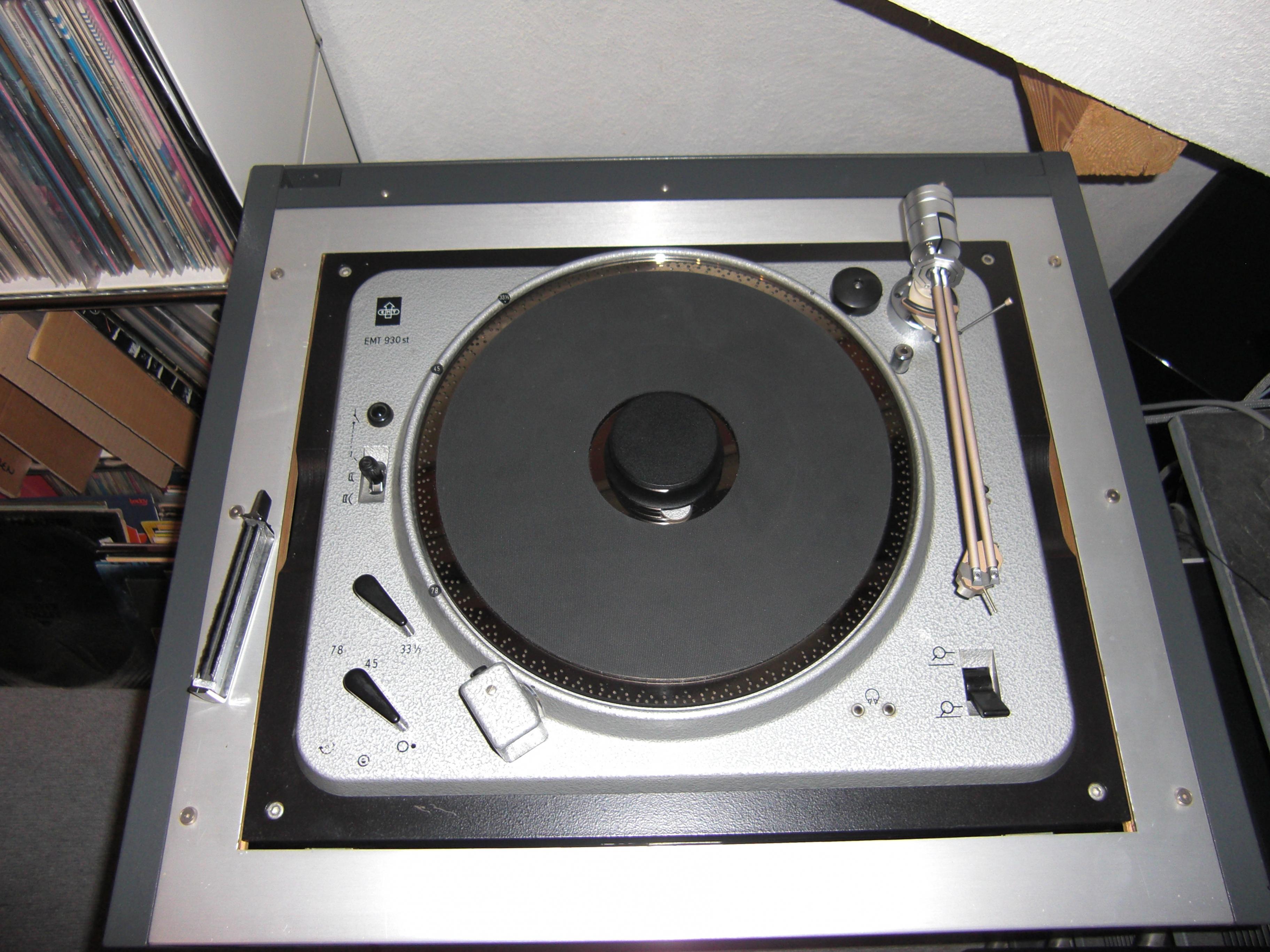

copper bars
Here you can see the copperbars, the DL 103 has not such v-shaped slots, but you can simply lay them on top of your cartridge and tighten brass screws just until you feel resistance. Lift your arm also 2-3 mm and since its medium mass, add a piece of 5- 10 gramms of lead on top of your headshell and readjust the weight.
Brass screws are important, since they are non magnetic, well damped and somewhat soft and thus easy to tighten them very carefully.
You will find this lead weight at your local car tire shop for the price of a chewing gum, they use them to compensate wheels which are excentric in weight. It has an adhesive to install it fix when you found correct weight.
The old dusty record is just my dustprotection for the EMT, since it has no dust cover.

I believe that what you gain in sound by removing the body will be lost due to the dust going into the cartridge (coils and suspension) more easily.
