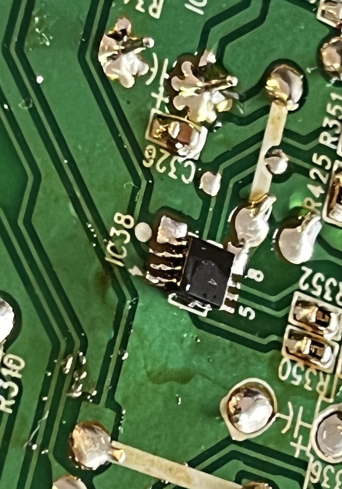

I know its old discussion, but help needed. Same problems with the CD player. I got the whole set PMA710, DCD710 and TU1510. Unfortunately, CD player does not work. It turns on and thats pretty much all. If I put the pen drive in the slot, then it would open the CD drawer, sometimes🥴. I see someone wrote the faulty part ( IC38 TC7WHU04 ). Can someone help locate it? I have downloaded service manual, but could not locate the part. Is it a big deal replacing it? Thanks a lot in advance. I hope i can fix it.
It looks like in my case was the same problem, IC38 TC7WHU04 was defective. My CD player is working perfect after replacing the chip.
@fruuu , thank you very much for sharing!
Thank you so much for sharing this solution. I had exactly the same problem with a Denon DCD-710AE and I located IC38. Used a simple multimeter to test it and it had shortcut! So ordered new TC7WHU04 at Mouser. Did my first de-solder of a SMD SM8 chip (quite tricky with the flux and all) and soldered in the new chip.
And it worked like magic!! This CD player will make its owner very happy for hours of playing time to come. I like the pitch speed control on this machine by the way!
