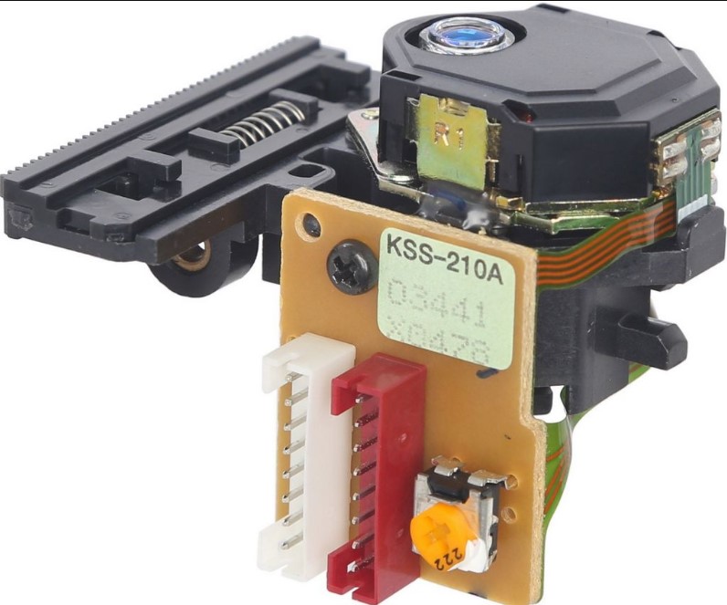

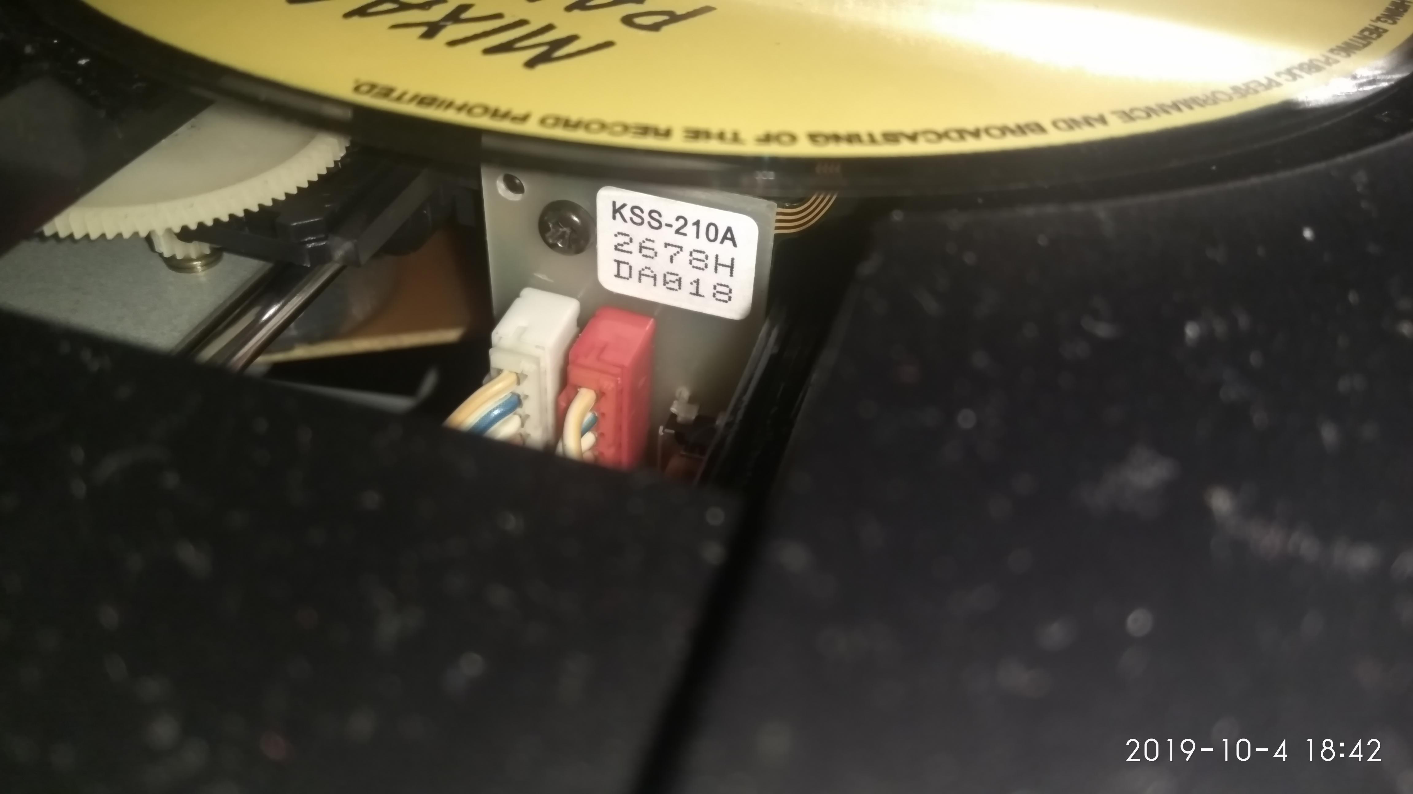

Hello.I have this old vintage cd player Denon dcd-520. I fully recapped it and removed the 2 muting transistors it had and now theres only a small audible pop during power on and off but its ok.Original Laser is KSS-150A.It reads well all original cds and all cdrs but not CD -RWs. I had a cheap KSS-210A bought of ebay and gave it a try.it worked out of the box.I dont have an oscilloscope.
I raised the laser power by turning the trimmer a bit and now it reads CD-RWs.

How to know if the increase of the current is within specs of the laser so as not to destroy it or destroy any other part on the main board?

Look at the circuit diagram. There will be a low value resistor in the laser drive circuitry from where you can calculate the current from the voltage dropped across this resistor.
The resistor is typically located on the small transistor that directly supplies the laser diode.
I cant find the service manual of my model but i found something similar.I measured the voltage across these parallel resistors and the current was 56mA.(This current is the increased current by turning the trimer at about 45 degrees from its factory position).
With the trimmer at is factory position the current was 45.2mA
But what is the factory operating current of this chinese KSS210A?
Can i rely on this datasheet for thresshold current and operating current?

Those are the resistors, it is similar in all players.
The genuine Sony pickups had the preset laser current marked into the serial numbers last three digits, however the copies don't seem to follow that pattern.
This would have been 47.8 milliamps. I'd suggest you set it using a good Red Book commercial CD of good reflectivity and set the RF for around 1.5 volts peak to peak on the scope.
