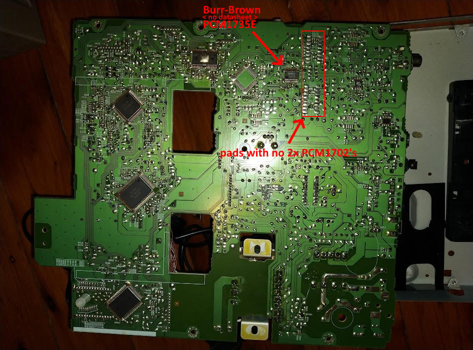

I own the DENON DCD-201SA CD player. Recently I found a service manual for it and was most excited when I stumbled across it (I almost fell) on the Internet Archive database after months and months of extensively searching google.
The DENON DCD-201SA service manual (PDF):https://archive.org/download/manual_DCD201SA_SM_DENON_EN/DCD201SA_SM_DENON_EN_text.pdf
The webpage it comes from:Manual: DCD201SA SM DENON EN : Free Download, Borrow, and Streaming : Internet Archive

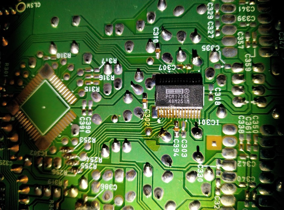

The manual quotes the Burr Brown PCM1735E DAC, but sadly does not contain any information about it.
This all started some months ago when I had to remove the cover to replace a drive belt. I was perplexed when I found no PCM1702 DAC's!! As this is what I knew it had, well at least till that moment. I then decided to remove the main PCB, which I had found and single chip DAC, PCM1735E on the under/copper side. Strangely no datasheet seems to exist anywhere for it anywhere. From my findings it appears to be a 24-bit DAC.
If anyone has any info on it I would be more than appreciative in knowing.
