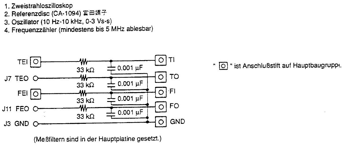

Also, on the 1520 filter boxes. There is nothing that I have seen stating capacitor or resistor values in the service manual. The copy from hifi, I am not sure is the complete service manual. You mentioned you might have access to that info? thks?
Hi bxt,
Loaded question all right. Has the battery been replaced before? I've seen them last over 15 years, but temperature and other factors may affect this.
I pulled this from a German manual. It's the same filter for all Denon, this from DCD-860.

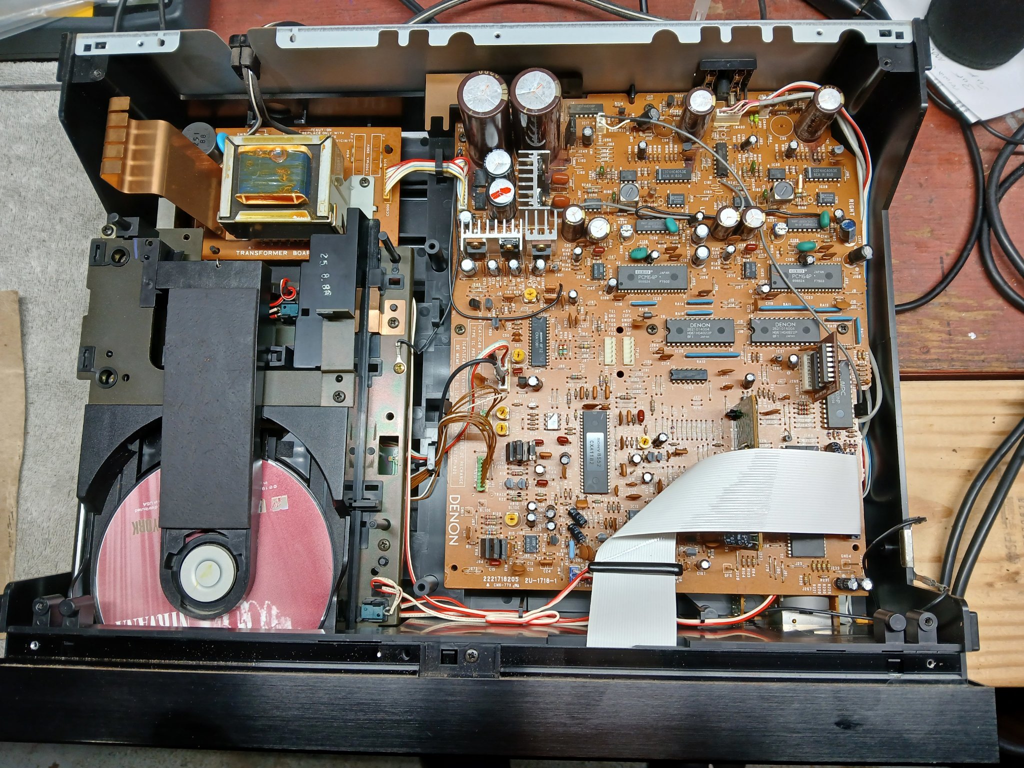

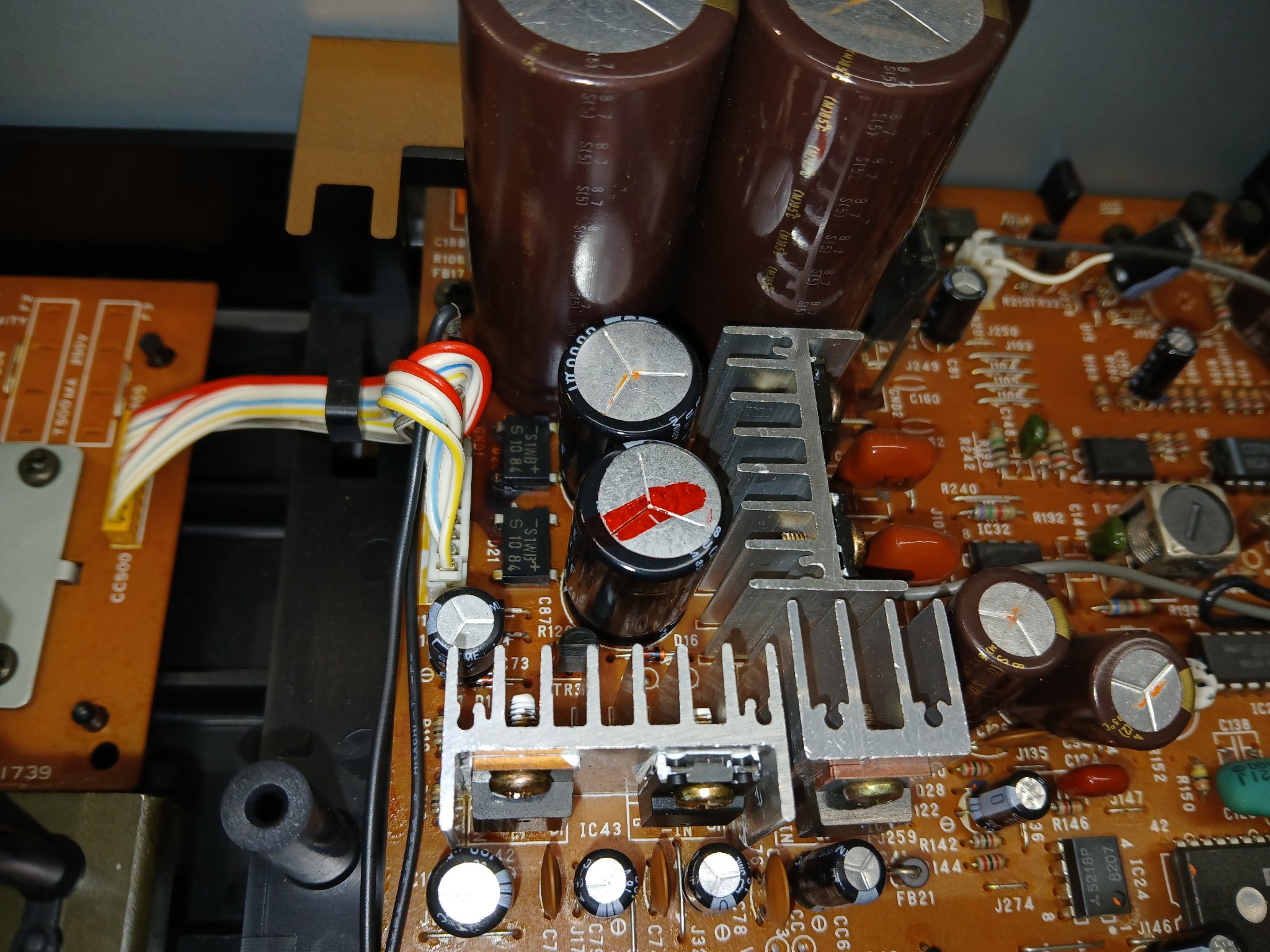

Was happy to find my old Narvina dsk, but zoom in the left by the filter caps starting close by chips and to the right. All leaking some weird purple stuff? I guess electrolytics. Never seen purple, hope the board cleans up. By the left those chips look dark in the area. 🙁
