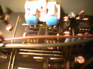

- there are some kind of high value (I assume) capacitors used in the
analogue section which I don't know and furthermore I can't read their
values. I made a picture of them with my palm device. They have writings on
them like 102J/100. The 100 is written below the 102J. Fisrt I thought that
the 100 means 100nF, but when I checked the other ones I found in the upper
line values like 101, 102 and 271 always with a "J" after them and always
with a "100" below them. So I don't know...

The caps you are having trouble identifying look like ceramics, typically used in the output stage for filtering.
The last digit refers to the number of zeros to add after the first set of digits. For example 272 is equal to 2700 pf and 101 is equal to 100pf
