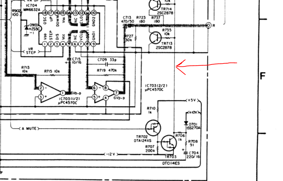

Got a Denon DCD-1290 EX-serie from my dad. CD is running, but no sound coming out. Not through my KEF speakers, neither through the phones out. Anything an audio dummy like me can do?

You have confirmed by measurement that the mute line isn't active and that the voltage on collector of TR703 is zero ?

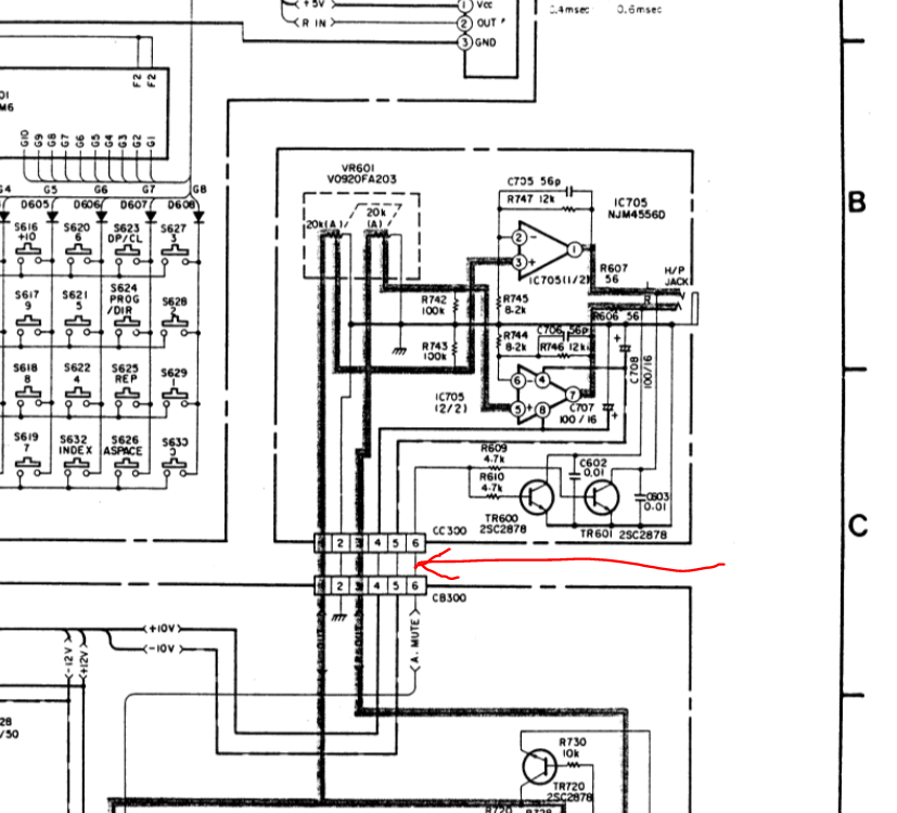

You measure it here (1st diagram) where it should be zero volts. You can also pick the direct mute feed from the system control here (2nd diagram) which might be easier to find. Again it should be zero when playing a disc.
The second picture is the headphone amp and so that should be easy to find, probably near the actual socket itself.

Thanks a lot for the diagrams, very helpful! I measured both, both are zero. Any next steps?
