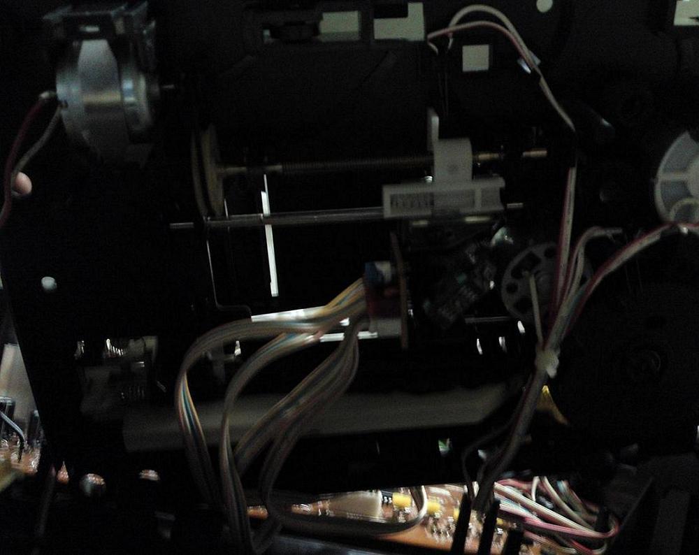

Anyway, the problem turned out to be a combo of all of the above really, only I seem to have busted the loading mech.
Its a Sony KSL2130CCM, but i can't for the life of me find a supplier... anyone know any?? Please help, as its incredibly frustrating to get it to work only to find I wrecked it

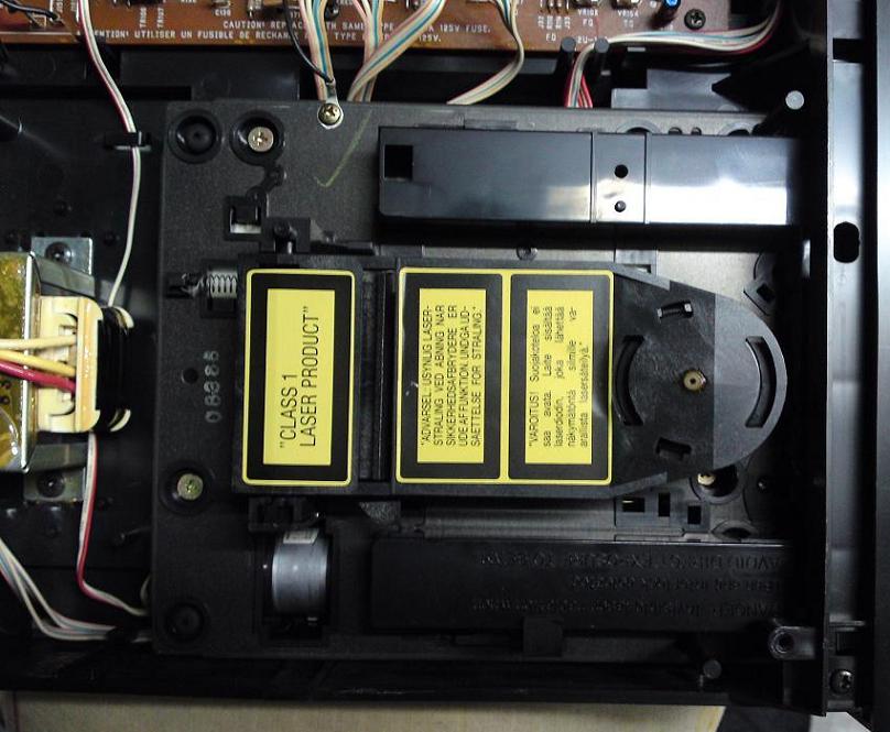

Did not find a number so quickly.
But a picture should do, does it look something like this ??
Bought this thing for it's dac, should be a pcm54 according to a lot of lists on the internet. Only to find a pcm56......
It still works fine, even after the peek 😀
Helaas, it looks nothing like the one I need, back to square 1 I suppose. Thanks anyway 🙂
