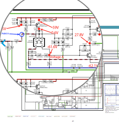

Well, got everything mounted and soldered, put it back in and the main fuse blows, not the two ceramic transistors on the power supply board.
I guess I'm going component hunting for something overvolting or not having proper capacitance.
Any other ideas, please let me know
The honest answer is that I think this is outside your abilities. It is a very complex amp and it is difficult to work on. It uses an SPS power supply which limits your ability to power it up in a safe state such as by using DBT.
You have done your best with it 🙂 but it needs more involved diagnostics.
If you short the vbe generator out then the output transistors can not draw current together and so they should not fail. That is the first basic step to take.
