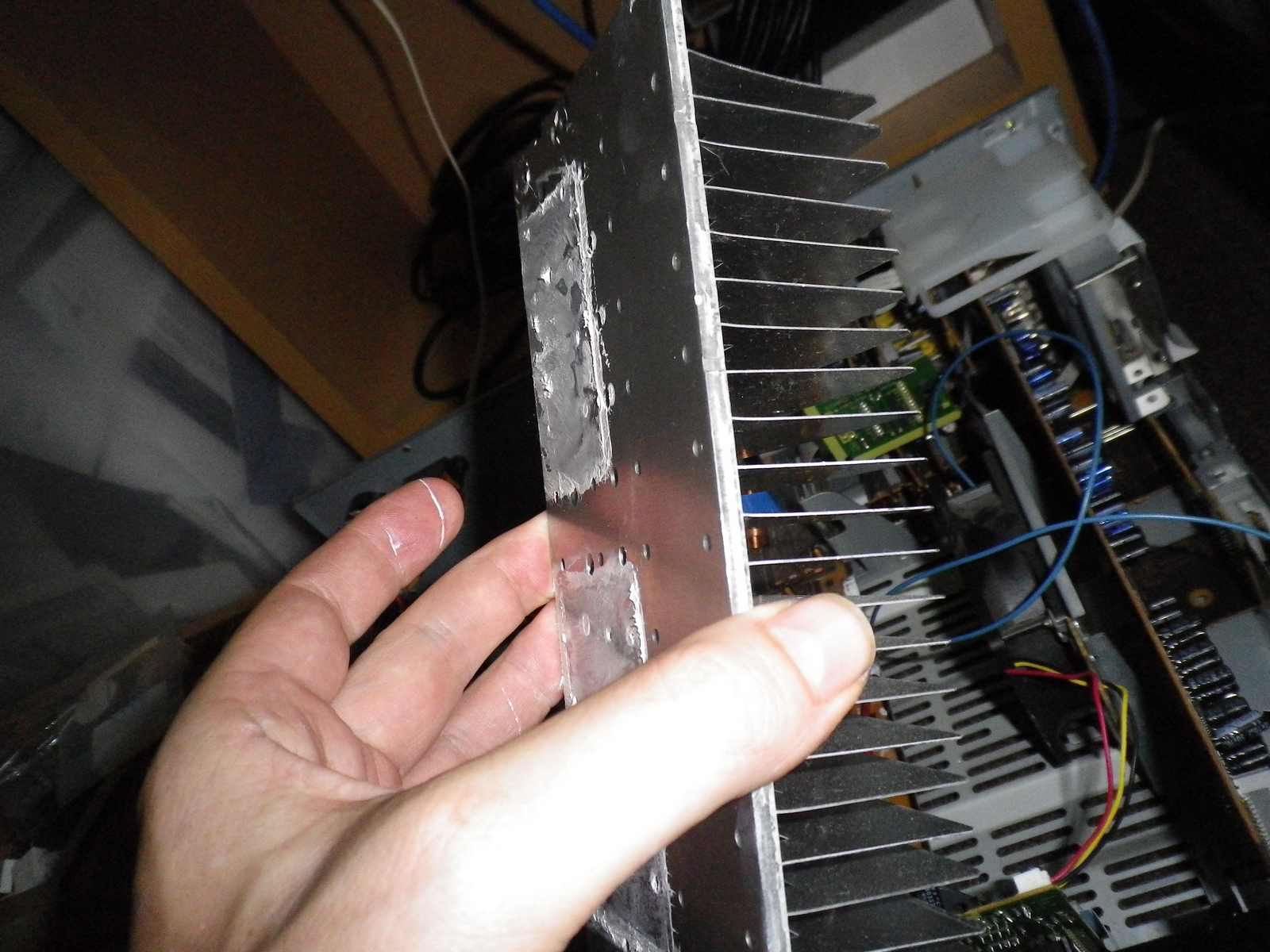

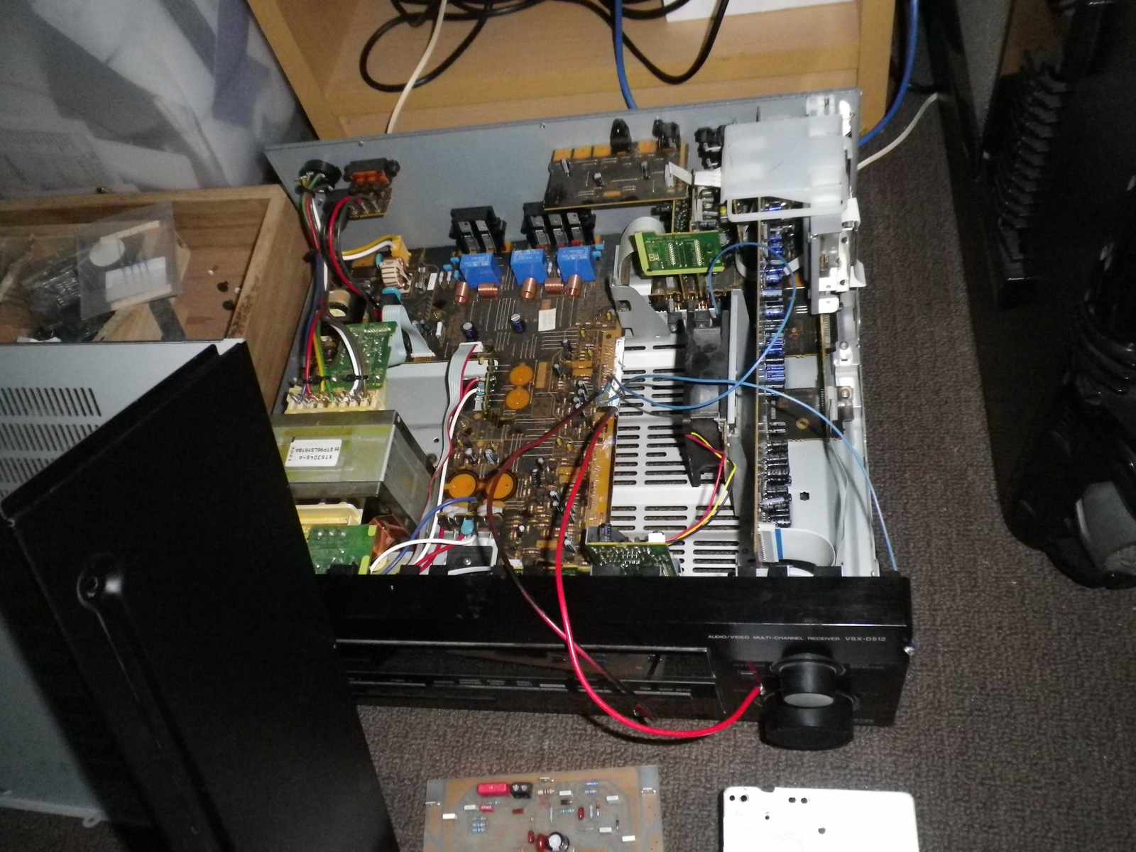

You could always do what I did for dad and that is remove the amplifier section from an old 5.1 channel HT amp(in this case a cheap pioneer amp), and install a design from these forums utilising the existing transformer, case, heatsink and input/radio circuit. Now has 2 channels instead of 5 though.

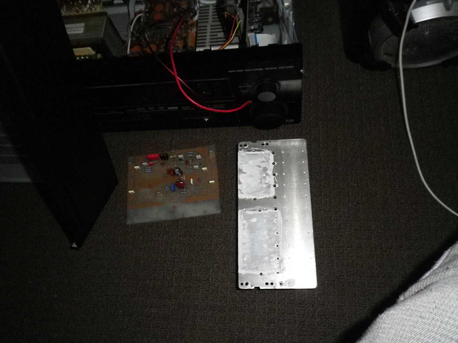

If you are to use that method. You have to make sure the transformer is of the correct size and voltages, heatsink is adequate for your purpose and there is enough room inside the case especially if leaving some existing circuitry. Also it would be pretty hard to do without the sacraficial amplifiers existing electrical schematics.
I was just able to fit 2 channels of Blame ST into that amp I made. Had to stack two power amp pcbs in a double decker formation. Unfortunately I didn't take any pics of the final product but only part way through.
All of the above would have been inadequate if wanting to install a honey badger inside in my case.
