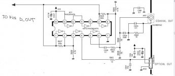

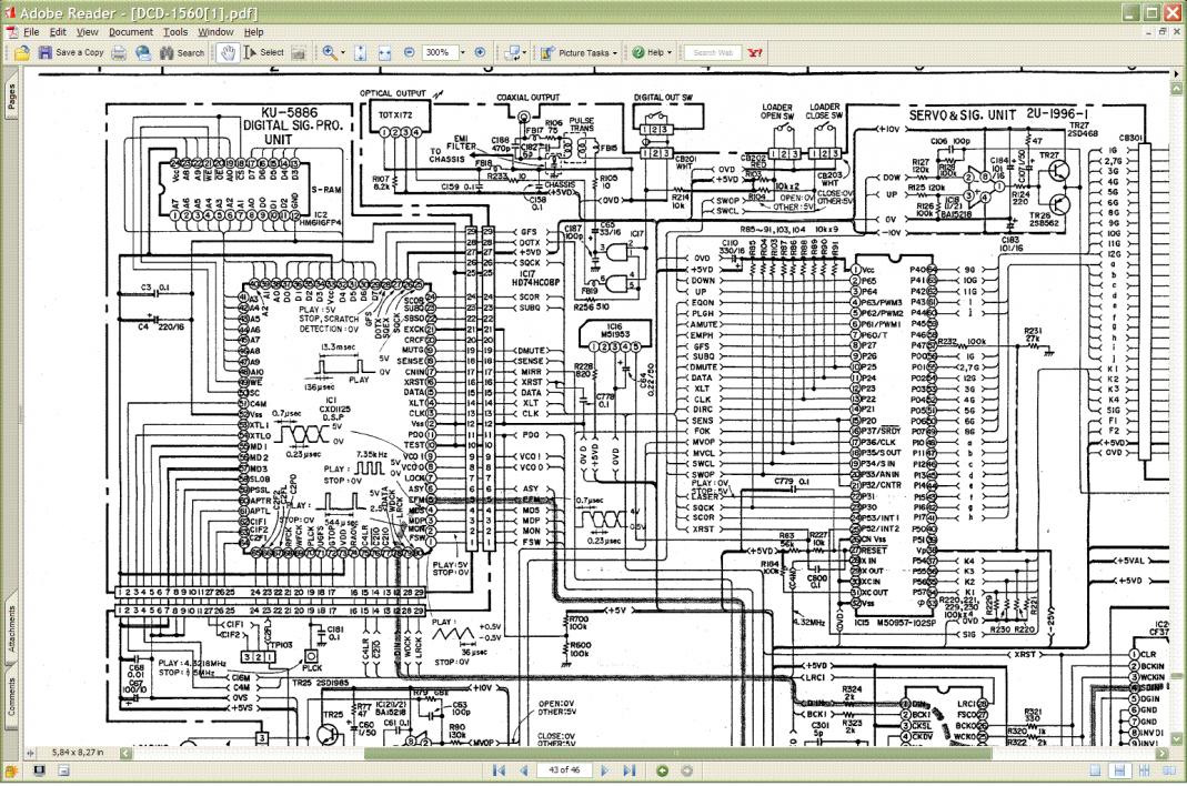

I have a DENON DCD-620, it don't have a S/PIF output and i would like to add one (i have a Sencer DAC PCM 1564A). This cd player have a CXD-1125Q chip. I've jointed the schematic. I've found the DCD-1560 schematic, this CD player use a cxd-1125Q and have a coaxial and an optical output, the numerical signal is take on #27 pin (DOTX). On DCD-620 this pin is GTOP, i hope the fonctionnality of this pin is function the states of #55(MD1), #56(MD2), #57(MD3), on DCD-620 the states are :
MD1 = "High"
MD2 = "Low"
MD3 = "High"
and on the DCD-1560 the states are :
MD1 = "Low"
MD2 = "Low"
MD3 = "High"
If i change the state of MD1 is it possible to made a S/PDIF output on my DCD-620 ? If yes does it need resistor and capacitor

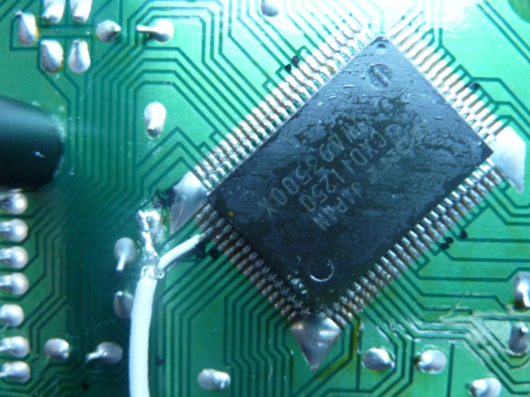

I've tried to tweak my CD player. First when i've opendes my CD player, my MD1 = "Low", MD2 = "Low", and MD3 = "High", for me no modifications were necessaries. I've soldered an little coaxial wire on pin #27 (look at picture) and i've soldered a 75R between the center of the RCA and the end of wire (look at picture). When i connect my dac without CD in the CD player, my DCA detects a signal, two leds, "48KHz" and "Lock" are lights on my DAC. When i put a CD the motor doesn't run on my CD player. I've tried to connect my DAC when a CD is readen, the CD player motor stops also. Somebody have an idea ?
