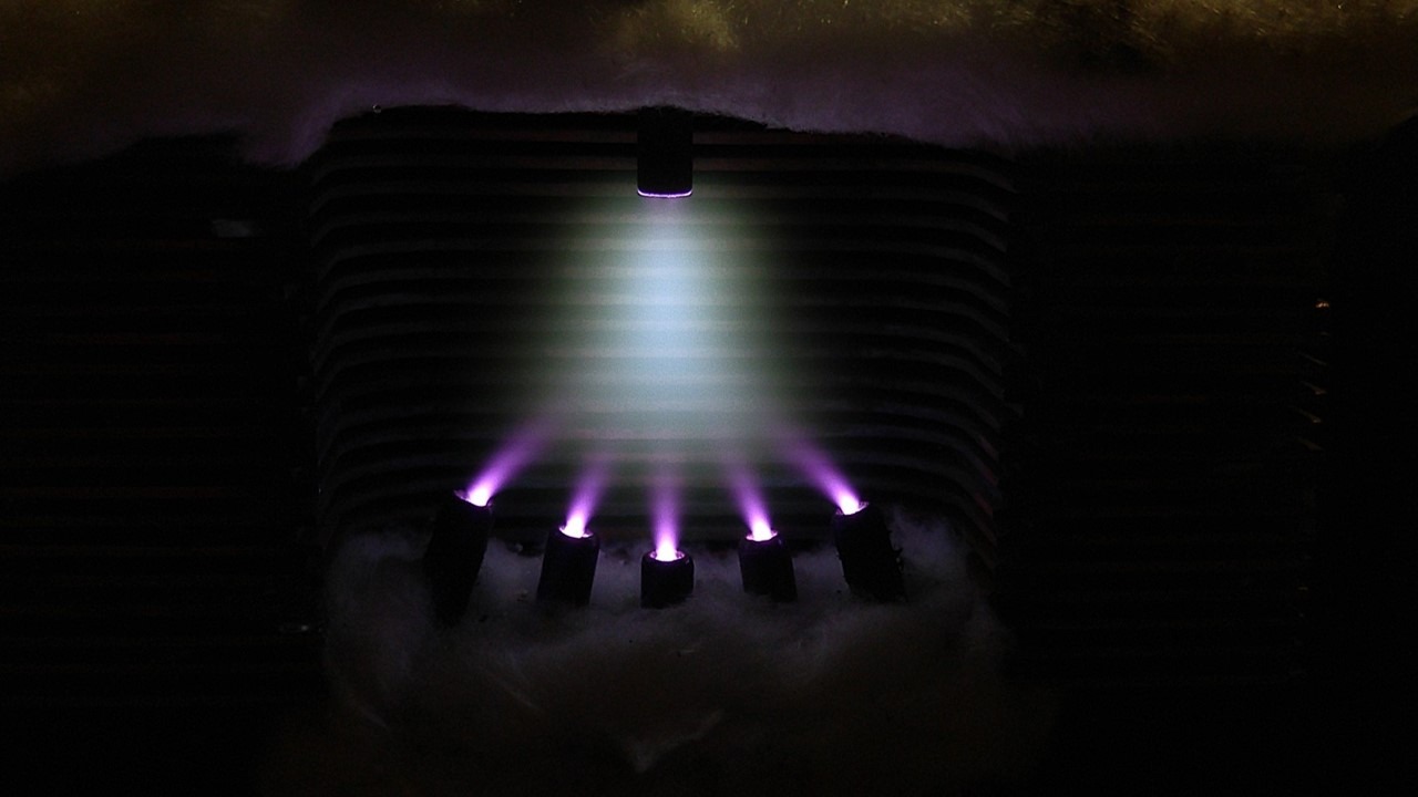

The plasma volume must be large to produce the lows and the energy required is likewise higher than any plasma driver I know of.
The Hills are dead quiet when idle because the cathode attachment point is stable - Oxygen is kept away by the Helium. My electrodes are thirty eight years old and have never needed cleaning.
The Lansche tweeter is claimed to be capable of 1.5kHz, but they do not mention output level or distortion numbers. The Magnat tweeter could not produce meaningful output below 4kHz so I wonder how they are able to improve on that with a corona discharge of such small volume. Also distortion is proportional to delta T over T (also delta W over W) and the corona is not very hot. The Hills do not generate any Ozone BTW - too hot.

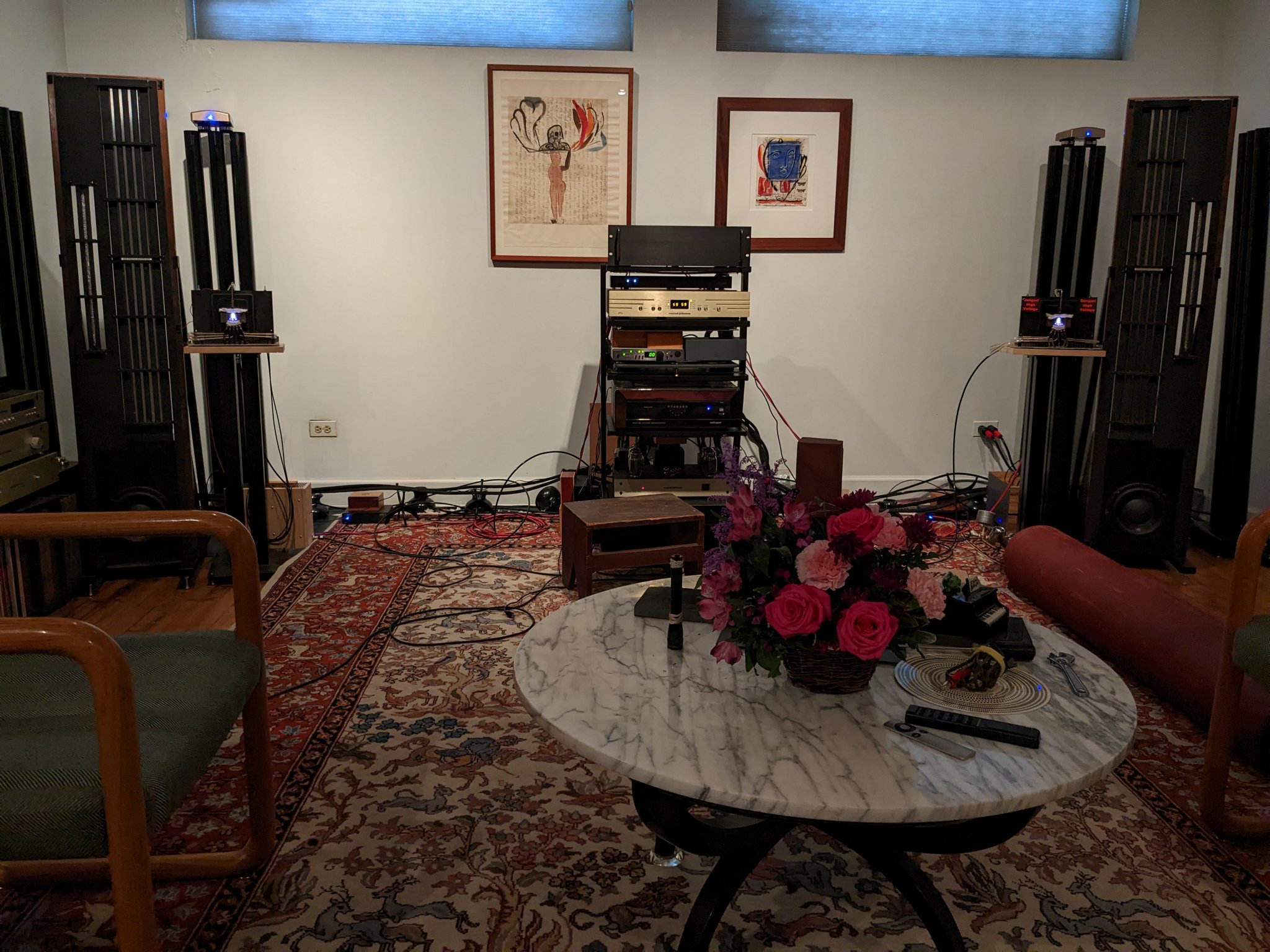

And a big thank you for donating to my GoFundMe to pay the fees for showing the speakers at AXPONA next Spring! The below set up is as you saw (and heard) it at Superior Audio on October 31st. This paring of the plasma tweeters with the Eminent Technology LFT-8b speakers was a very pleasant experience and this is what will be demo'ed at AXPONA 2023.
My Analysis Audio Amphytrions are like Apogee's, although a bit easier to drive. Bybee devices were installed in the crossovers and Bybee speaker bullets put on the speaker cables between crossovers and panels. http://analysisaudio.com
I mention them because I may be acquiring a pair of Hills in the coming months with the idea of using the tweeters with them, much in the same way as demonstrated with the ET speakers.My Analysis Audio Amphitryons are like Apogees, although a bit easier to drive. Bybee devices were installed in the crossovers and Bybee speaker bullets put on the speaker cables between crossovers and panels. http://analysisaudio.com

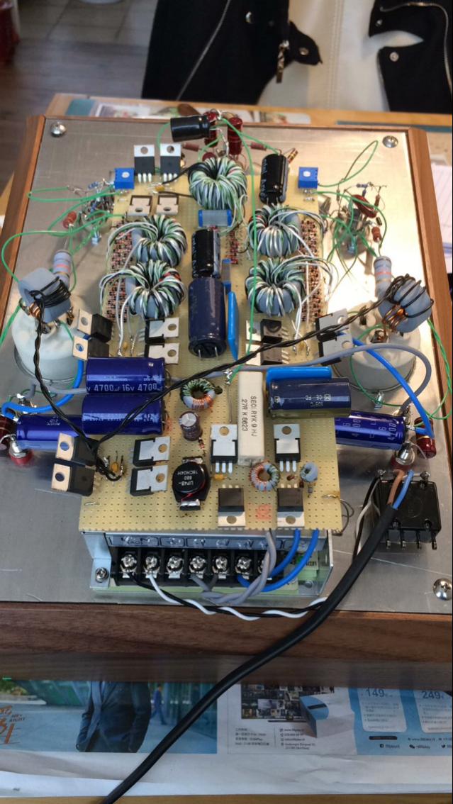

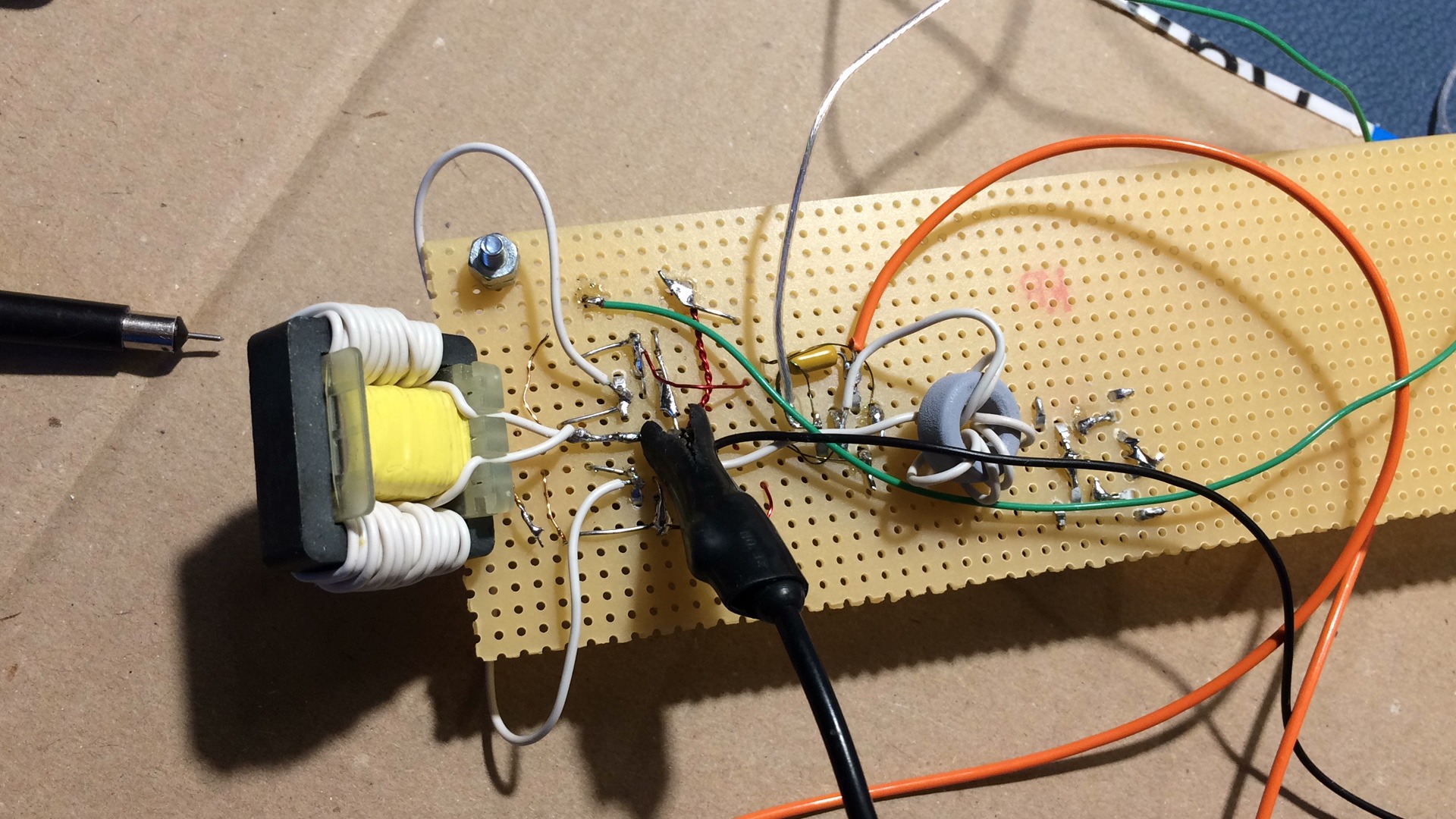

In this case you can wind your own transformers and resonant coils to specification. I did some experiments with a quadrature power source and high voltage windings with good results (after some failures).Diode bridge stacking and voltage doublers keep capacitance low etc.
That is some impressive bread boarding.
I also wound my own, but not on torroids. My inductor is a PQ35 with three small gaps, and th etransformer is a PQ5050 with a full bobbin of Rubadue #36AWG Tefzel. I bought a rather ancient looking (but new) hand-cranked coil winder on Amazon. It is a casting that looks like it was designed 60 years ago.
