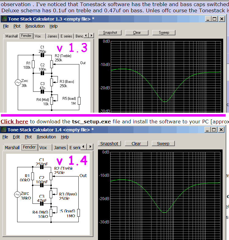

Just an observation . I've noticed that Tonestack software has the treble and bass caps switched around on Fender amp. The original Deluxe schema has 0.1uf on treble and 0.47uf on bass. Unles offc ourse the Tonestack is not actually showing Deluxe style stack. Any idea why is that?
My guess is that it's a mistake, plain and simple.Any idea why is that?
If you have contact information for the creator of the program, why not email-him and let him know?
I couldn't find any kind of "Contact Me" button or link on the Duncan Amps website. Perhaps there is something inside TSC itself?
-Gnobuddy
Tonestack software allows you to CHANGE the original values shown; these then will appear when the file is re-opened. Perhaps you or someone else at some time changed them; simply click on the value and enter the correct value; then save it.
