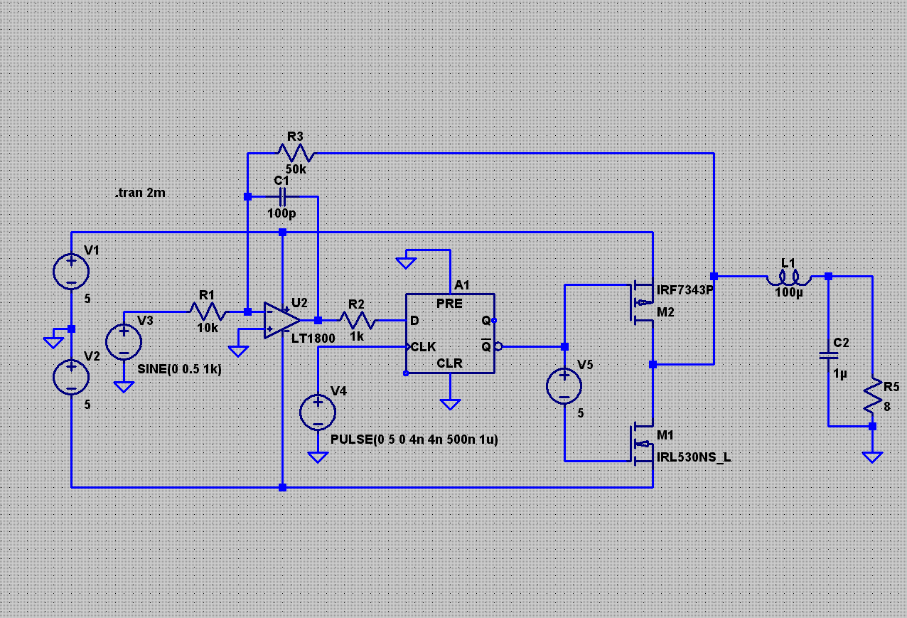

Here's a snippet in LTSpice
I just threw something together that works, at least for simulation.
100uH and 1 uF is filter for 8 Ohm load. I grabbed some likely FETs to drive
the load. It's kind of unrealistic in that a real flop wouldn't drive the FETs
nicely without some buffering...the floating 5 volt supply as a level shifter
is also unrealistic, but the idea was to get you into the ballpark.
It has a gain of 5, and doesn't take too horribly long to simulate...the output looks a bit noisy, but about what you'd expect given the OSR and the low order (first) modulator.
Note...sigma_delta.txt is really an LT spice .asc file. Just rename it to be sigma_delta.asc, and you can simulate in LT Spice.

Thank you djoffe 🙂 Just what I needed 🙂
turns out my original problem seemed to be the integrator clipping due to the signal from the first op amp - oh well at least its an easy fix, hopefully someone with the same issue as me will stumble across this and save themselves some frustration.
