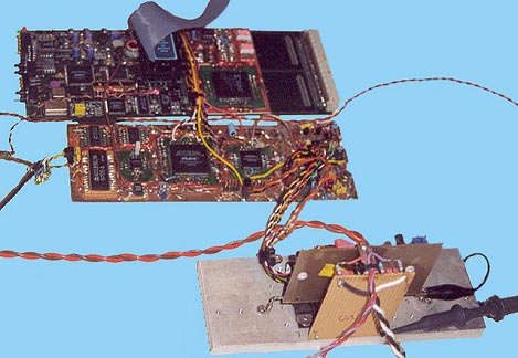

Charles:
I tried a 4th order BW LPF (50kHz) on one of my early PowerDAC protos - there's a pic of it attached - and although output ripple was very low, it sounded a bit 'tight' and image location was poor, probably due to the non-linearity of phase. But I guess if the passband is extended to 100kHz or 200kHz, the phase over the audio baseband is probably linear enough.
The issue of feedback around the power stage - or even overall feedback - applied to all-digital power amps is one which occupies much of my hobby thoughts nowdays and I may start a new thread on this issue.
