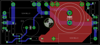

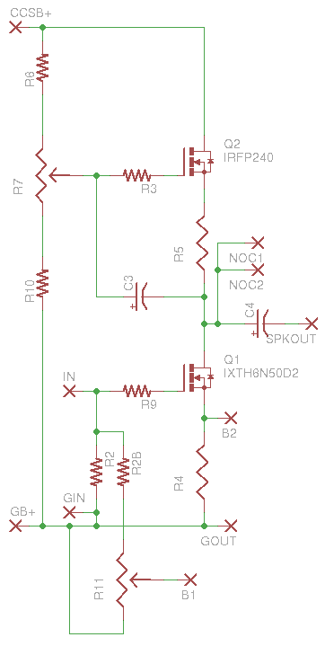

Hi all, I have done a layout for the DeLite-ccs shown in the following post:
http://www.diyaudio.com/forums/pass-labs/153832-pass-delite-amp-baf-61.html#post2504859
The layout is below. Can I get some comments, suggestions, etc. I know it is a simple circuit and could be done p2p, but I would like to use a board.

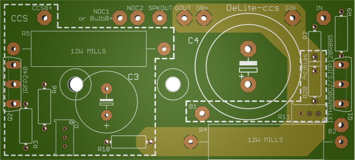

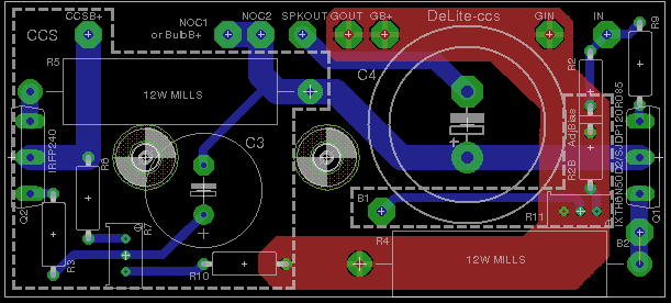

Updated board
Not getting much love yet, but here is the current incarnation. I think it is flexible enough to make just about any DeLite. Any comments would be appreciated.
Thanks,
Chris
