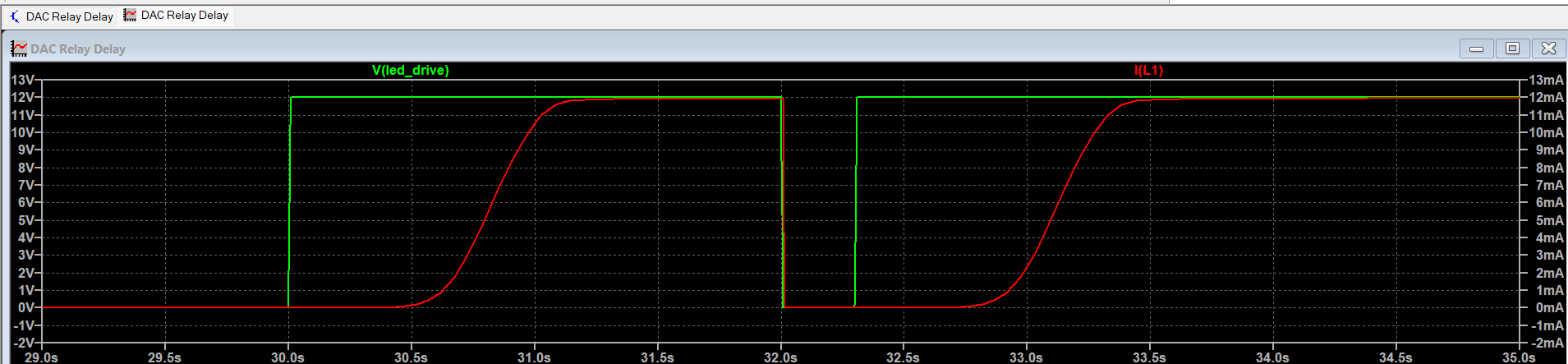

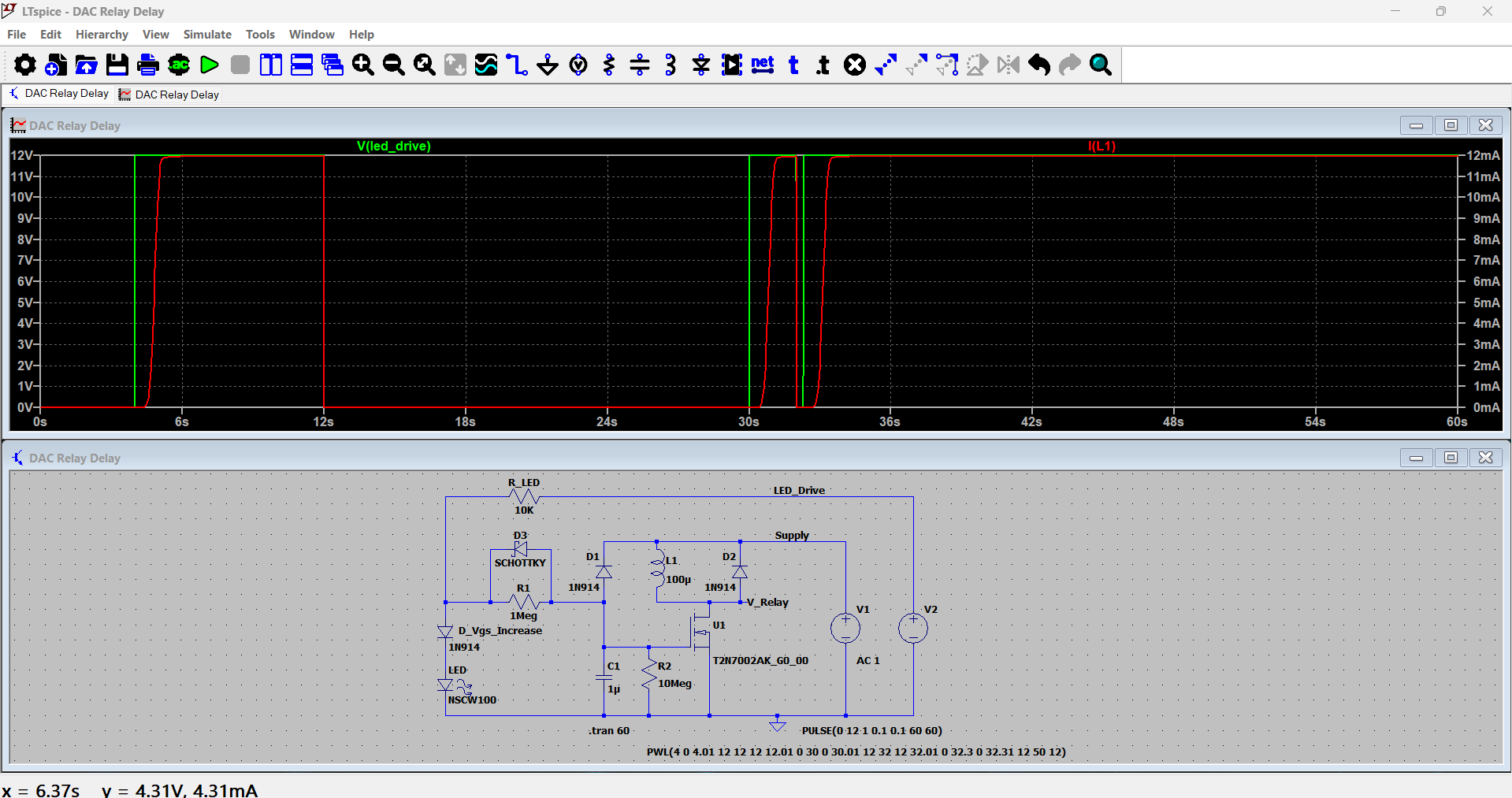

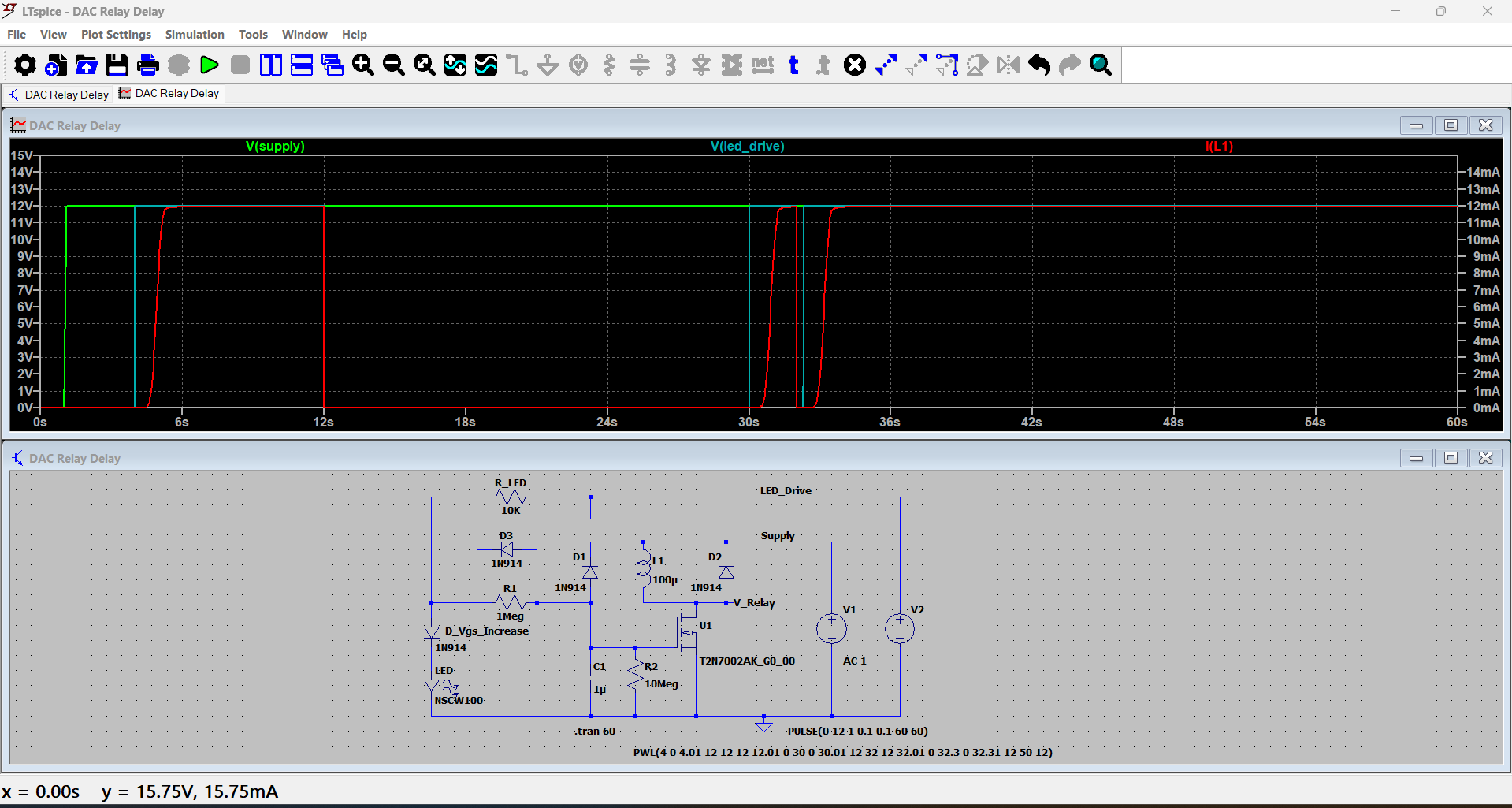

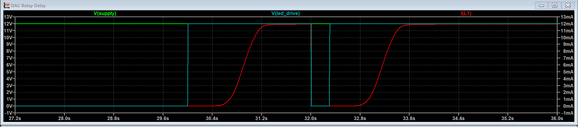

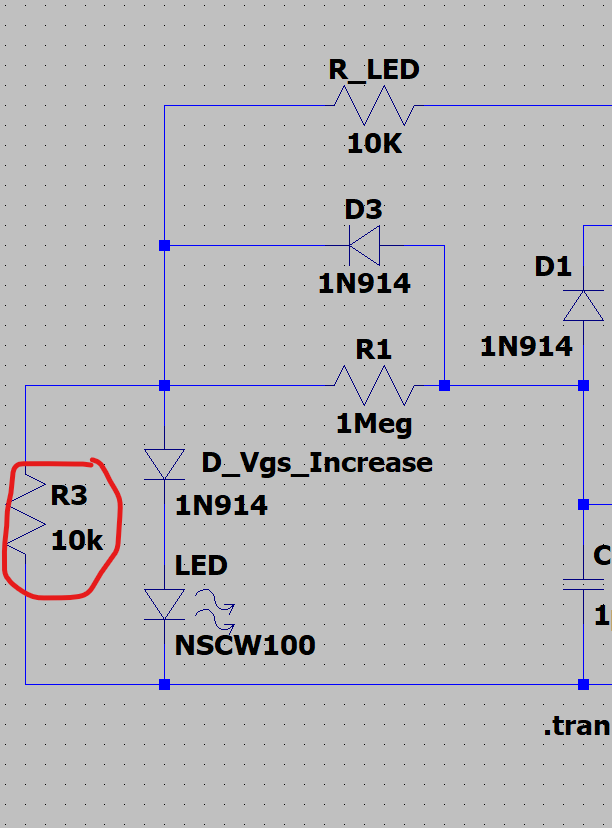

Delayed relay operation from a signal lock LED
Something more sturdy with lower RDSon would not hurt as it drives a coil over a longer period. Many SMD MOSFETS are capable of ultra low (tens of milliOhms area) RDSon and a few A. For instance 2N7000/BS170 work OK with tiny micro-relays with power consumption of a LED 🙂 but not with larger relays.
I think I used ZXMN2A14FTA in a few.
