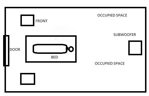

I have planned to shift the arrangement in a different way.where in front speakers and listener would be in equilateral triangle (as right now it is bit far and sounds as if from distant.) again the woofer would be moving to somewhere around 2.5 meter backwards that is what my wife suggest as present arrangement has made our life miserable.
I have tested with this new arrangement and found it much pleasing compared to that near bed arrangement where the bed used to vibrate annoyingly.again this is where sound staging gets totally compromised. My bad... I should have posted this at first place but I believe my requirement is understood here.
Here is the plan of new arrangement .
Even though I got very nice sounding setup in my home theatre room but I cannot miss listening some good things while in bedroom so I am trying my level best to sort it out.
presently woofer is adjacent to bed but it keeps knocking hurting legs/knees, when somebody pass .
and subwoofer placement is too critical i cannot find anything better sounding than where it is shown in the below diagram but for the dreaded delay..
hope you get me.

Do something. Try it like that without delay before going overboard. Remember, 3mS is 330 Hz, and having the highs attack first gives a crisp sound (so much so that Barcus Berry made a 'plug it into anything and it will sound better' box that delayed bass frequencies for exactly that effect).
And you never said where the crossovers and power amps for the satellite speakers are mounted. However, I hadn't realised it was only a two channel (+ sub) system.
Incidentally, you don't sound vague, and though I suspect some of the problems are due to room acoustics – bass is horrible to get right – I've met the "early bass=lack of clarity" syndrome, albeit with considerably greater distances involved.

Btw , i have tested the same setup with my DVD player yesterday which has delay compensation. it sounded tight and composed but yes there was bit of muffling here and there.
yes, room accoustics can be considered a culprit here. probably phase distortions. but if I could get hands on a delay line I would be relieved of my anxiety at least.
A good option for me is to change my good old CD player to a newer DVD player but i cannot do that . I will be compromising on many good things for little bad thing.

So hunt is still on for a quality delay line...how much would it help with array of All pass filters though it doesnt appears practicle to me in any sense. yet..I am asking.
I don't think the all pass filters are going to help at all (except in phase alignment, which doesn't seem to be the problem here). It's true, some television delay lines (to compensate for different lengths of cable) were essentially cascaded low pass filters; but they were looking for microseconds, nothing of any interest audiowise.
