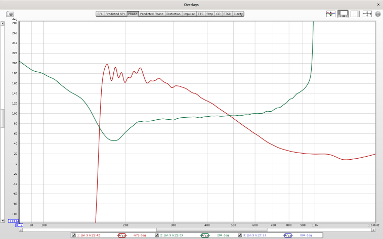

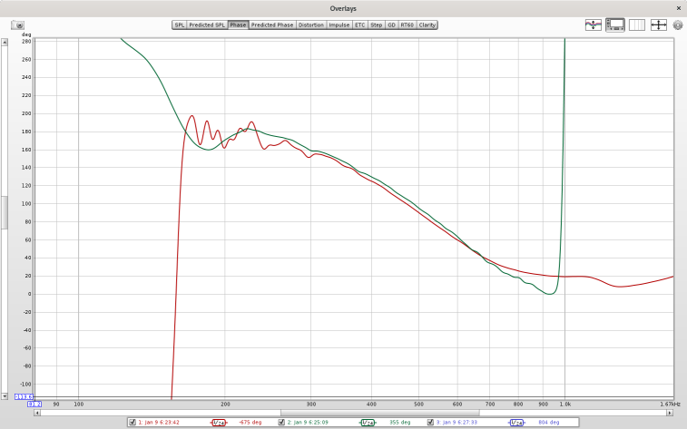

Hi guys,
I spent yesterday evening and this afternoon messing around with the system.
I've obviously measured the delay of the individual drivers the wrong way last time round... I corrected that, and I now get a marked dip at the crossover frequency when I reverse the polarity of one of two "adjacent" drivers! I also found that the mid-range was the wrong polarity 😱
The whole system sounds much more dynamic now 😉
I also tried a setup with 24dB/oct Linkwitz-Riley (as opposed to Butterworth) and a bass-mid crossover frequency of 685Hz instead of 304Hz.
I'm still switching between the two, but I think I prefer the Butterworth setup!
Thanks for all the advice again!
