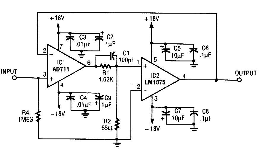

It looks like its been done as kit for a while. I have not tried this schematics though.Have you checked the open loop gain frequency response ?
Or distortion at 1kHz compared to say 10kHz ?

https://www.kaltecs.com/lm1875-composite-amplifier/
As he says in the text, the schematic by itself (without parts values) isn't quite enough to make a working composite amp, but it does look neat. I like the price of his completed pcb:
