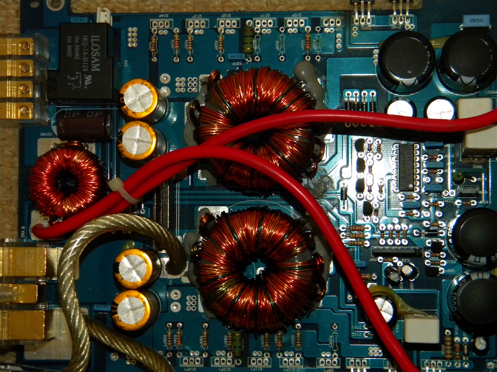

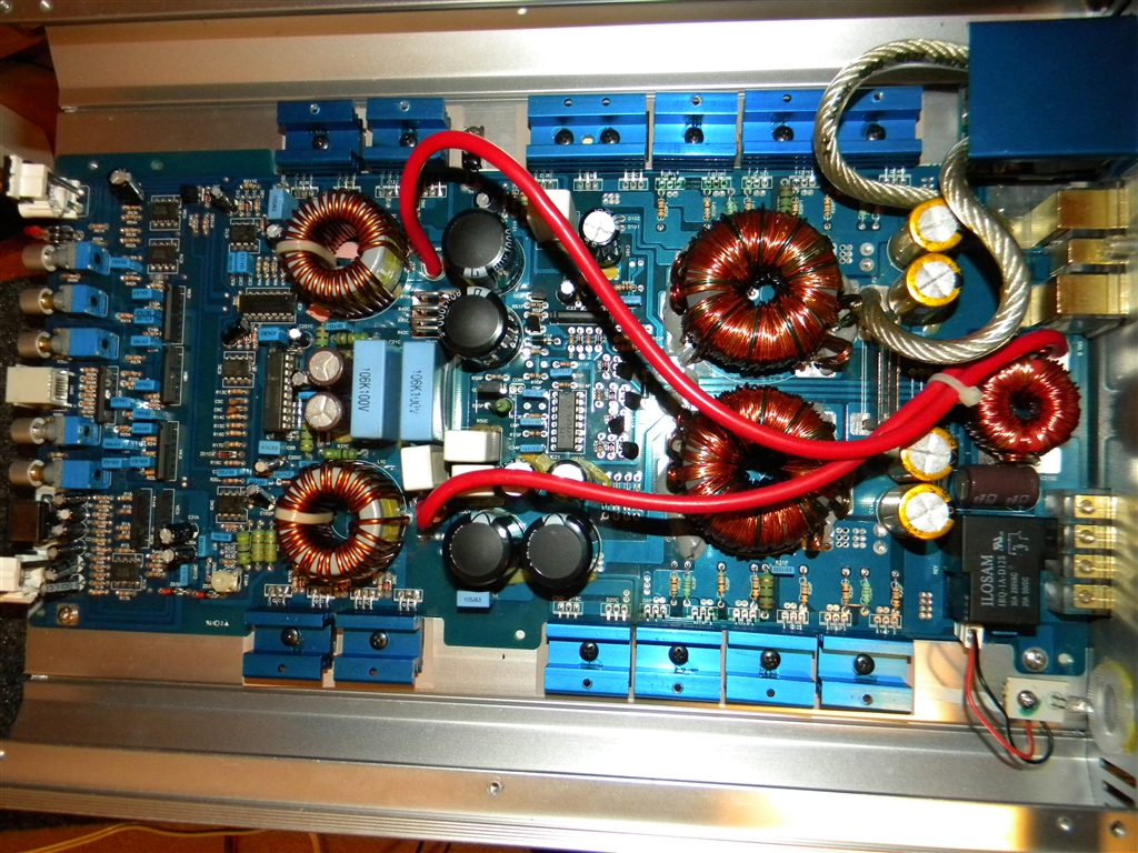

i found a compatible transistor IRF3205. could i replace with this type? the rds is about 0.008, and the original has 0.016ohm, aproximative the same current and voltage.

the 100ohm rezistors 3 or 4 are burned. i need to change them. i can change all the restistors, but if you can recomand a type of transistor it will be perfect! i have found IRF1010, but it has the same rds value. i repeat: i can change all the resistors that they are 100ohm with a particular one to be perfect.
the original transistors costs a little bit too much... aprox 3$ each and in this case i need to change only six of them, the rest of them are ok, in a good condition. i measure them and i know that they are in a good condition. but it exists a risk, i replace 6 of them and after a while to get burned.....

I think the two supplies need to be as closely matched as possible and using the original FETs would do this. If you absolutely won't/can't buy the originals, the Z48 (with 68 ohm gate resistors) or the IRF1010E with 47 ohm gate resistors should work.
Since only one supply failed, you could possibly have an intermittently shorted power transformer. Before you do any further repairs, power the amp up via a 15 amp fuse to confirm that it will power up through that fuse without blowing it. After replacing the FETs and resistors, clamp all transistors tightly against the heatsink and power the amp up (again through the 15 amp fuse). If the fuse doesn't blow, twist/push/pull on the transformer in the failed supply to see if the amp every blows the fuse or draws excessive current. If it does blow the fuse, you'll need to find the short in the transformer windings.

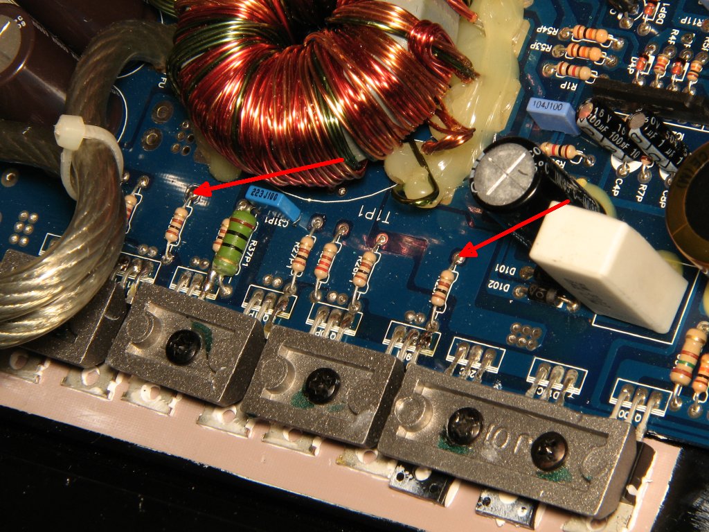

i have a big-little problem. where i found the burned transistors now after i replaced all the transistors and all the 100ohm resistantces with 68 ohm and i found 4 of 220Ohm(the green one) and i changed those, i have on the first pin of 3x2 transistors( 2 groups of 3 transistors) 3.57V, on the others i found 3.07V(3x2). My problem is that those that have a bigger voltage on the gate is getting hot. i attached a photo will al the modifications in the power supply area.
I forgot to say: on the second pin of each transistor i found the same voltage(~9.5V) and on the third pin i have found 0V, all the measures are with the black probe on the minus of the power supply.

For the transistors that have 3.57v on the gate legs, what is the DC voltage on the end of the 68 ohm gate resistors that is NOT connected to the first leg of the FET?
do you say to disconnect one of the 68 resistor fron the gate of the transistor and to measure the voltage?
all the 68 ohm are directly conected to the gate of each transistor. the 220 ohm are conected to the source of a group of 3 transistors. i can't understand what to measure!!
i measure on the output of the driver circuit, on the pin 9 i have 3.3V and on the other i have 3.7V. i think that the driver circuit has a problem.....😀
