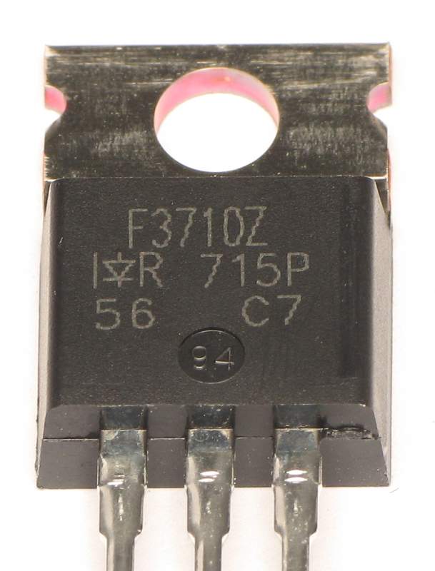

Hello, I have a problem. I have a Hifonics Brutus BX1500D. There are some transistors defect in the audio area, NOT in the power supply.
The transistors has got some numbers and letters.
94-2355
I R 426H
01 2F
I can´t find which transistor it is or an replacement typ.
Here are some pictures:
http://img180.imageshack.us/img180/2971/p1010010cf3.jpg
http://img515.imageshack.us/img515/2258/transistor1ke8.jpg
So please can someone help me to find out which original transistor was build in?
Or can say with replacement type I can use.
Only one side has got defect transistors. So I will change every transistor on this side. Is this correct?

The originals transistors in some of those amplifiers were IRF3710s. There is a problem with some of the 3710s that will cause the amp to go into protection mode.
Someone is supposed to bring me a similar amp tonight to test a different version of the 3710. If I get the amp, I'll test both sets of 3710s and post the results.
If you have some IRF3415s on hand, they will allow you to get the amp up and running and check for other problems.
In virtually all of these amplifiers, when the outputs go, the HIP4080 fails also. If you have to order parts, order a couple of the 4080 ICs. If you fail to find all of the defective components, it's likely to kill the 4080 again. They are very sensitive and fail in a fraction of a second. There is zero protection in the output driver section of the IC.
You can change only one half of the FETs but if the amp failed due to a shorted speaker or similar fault that caused high current to pass through the outputs, you should change all of the outputs. If the amp failed under normal operating conditions and there are no faults in the wiring, you can change only the ones operating in the half of the H-bridge with the failed FETs.

Sorry for the confusion. The lower case 's' on the end of the part number IRF3710 was plural, not part of the part number.
I only suggested the IRF3415s as a temporary fix if you had them on hand.
I did a bit of testing on two amplifiers. The first was a Brutus BXI1606D. The IRF3710 (no suffix) worked in it.
The second amp was a Hifonics XS1500.1 Stealth. I had previously installed IRF3415s in it and the amplifier worked well with them. I installed IRF3710 FETs and the amplifier would immediately go into protection. Even before the speaker protection relay would engage, the amp would go into protection if audio was driven into it. I pulled the IRF3710 FETs and installed the IRF3710Z (note the Z suffix) FETs in the amp and the amp worked as it should.
In many amplifiers using the HIP4080 IC, the non-suffix IRF3710 FETs are not a good replacement even if that's the original part number that was used in the amplifier. I've had limited experience with the Z suffix version of the 3710 but they seem to be significantly different in their operation. I asked another tech if he had found any amps that had a problem with the Z suffix version and he hadn't.
It's always better to change the HIP4080 IC. They almost always fail when the outputs fail.
One more note... The supplier (Digi-Key) part number is IRF3710ZPBF (PBF = lead free). The part number on the FET is IRF3710Z. The assembly line code has the letter 'P' in it indicating lead free. See attached.
I know that this may be more information than you wanted but this can help avoid the problems that I've encountered.

The Z version of IRF MOSFETs features a body diode with much faster reverse recovery (lower Qrr and Trr, see datasheets). This makes a big difference in class D output stages because a cross conduction spike is always produced during reverse recovery on each switching cycle, and the slower the body diode and the faster the turn on, the bigger the spike becomes. When a set of "standard-body-diode" MOSFETs are placed in a circuit whose gate drive (and current limiting) is designed for "fast-body-diode" types, this spike may cause false triggering of the overcurrent protection or may even blow the MOSFETs. The "standard-body-diode" types need slower gate turn-on to tame the reverse recovery spike at the expense of more heat wasted.
"Z" IRF parts are preferred for class D output stages, even if the original wasn't (it could have been a special lot anyway). On the other hand, body diode does not matter for push-pull power supply MOSFETs.

I tried the IRF1310N in some of the amplifiers that were finicky about the FETs used and they didn't work. They had the same problem as the IRF3710. If you get the IRF1310 FETs to work properly or if you use a variation of the IRF1310, please post your results.
Eva:
Maybe you can help determine why some FETs work and other don't. The Trr and Qrr don't seem to be the determining factor. This is what I've found.
Amp A (HIP4080 based system):
IRF3710 did not work Trr=140nS Qrr=0.67uC
IRF3710Z works Trr=50nS Qrr=0.1uC
IRF3415 works Trr=260nS Qrr=2.2uC

IRF3710: Qg=130nC max. | Qgd=43nc max. | Crss=72pf typ.
IRF3415: Qg=200nc max. | Qgd=98nc max. | Crss=340pf typ.
Given the same gate drive circuit, IRF3415 will turn on much slower due to the increased Crss and Qg. This is something to consider.
