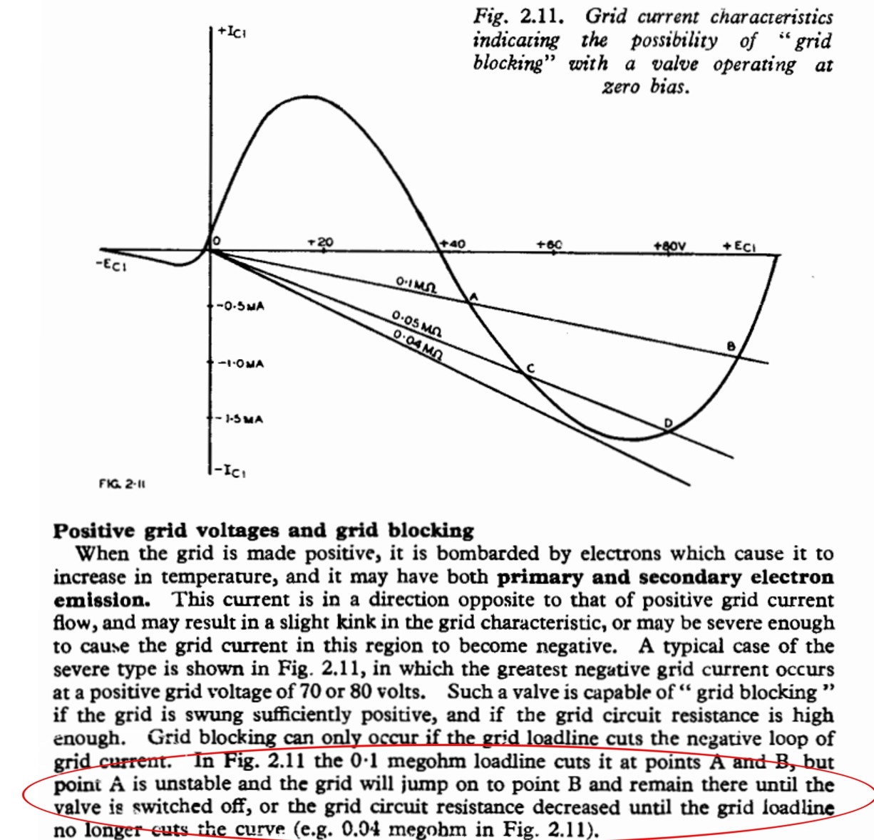

Just reading about grid blocking here's extract from Radiotron 4th Edition 1953 Ch 2.2
I dont profess to fully understand, but the symptom circled red perhaps seems a good fit here?

The part of the Radiotron manual that you showed is about tubes that are supposed to be used at zero bias, and have their grids driven positively (like the 811A). A 6550 will die quickly when used in this way. In practice, the driver circuit is not able to make the grid enter the "grid blocking" region. The blocking distortion that we're talking here is caused by a different phenomenon, and I guess we'd do better by calling it farting distortion to keep the phenomena apart. You can read more about it here: https://www.aikenamps.com/index.php/what-is-blocking-distortion
You'll find that most of the measures mentioned in the article to prevent the amp from farting are actually taken in the SVT. This is not strange, because musical instrument amps are often severely overdriven, and it is the overdrive behavior that determines most of the tone of the amp. As nobody wants a bass guitar to sound like someone's trouser trumpet, it's best to leave those measures in place.
Thanks I suppose the Radiotron chapter might describe any valve which shows inflection in its grid curves .......no idea if that includes ECC82/12AU7. But 'latch up' as described would seem a good fit so something to keep in mind. At issue here is V2/V3 behaviour which are ECC82/12AU7s - not the 6550s - of course.

Thinking about this, apparently grids can source current, the negative gradient part of grid current versus grid potential curve from Radiotron posted hereCan 6550 grid source current?
https://www.diyaudio.com/community/...blem-ampeg-svt-300.395328/page-2#post-7257577
Into a resistive grid load, this would be positive feedback and unstable - and hence the Radiotron text? And latch up.
