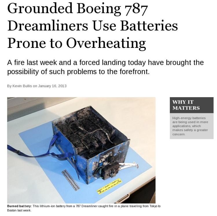

Didn't stop Boeing, did it?
http://www.mdpi.com/1996-1073/6/9/4682/pdf
https://www.ntsb.gov/investigations/AccidentReports/Reports/AIR1401.pdf
George
I had to scroll a long way down that PDF to get to the photo of that blown up battery. A clearer photo was on the web at the time it happened and before the report came out. I took a sneaky screen grab of it so for if you can'i be bothered here it is.
