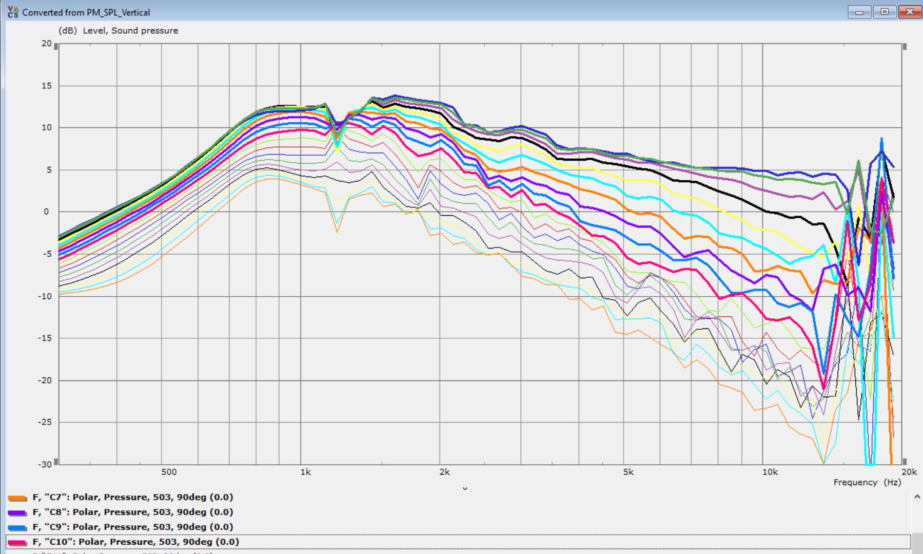

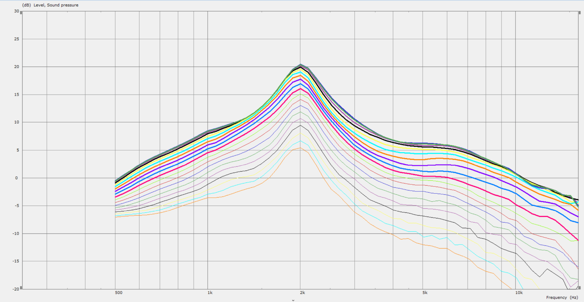

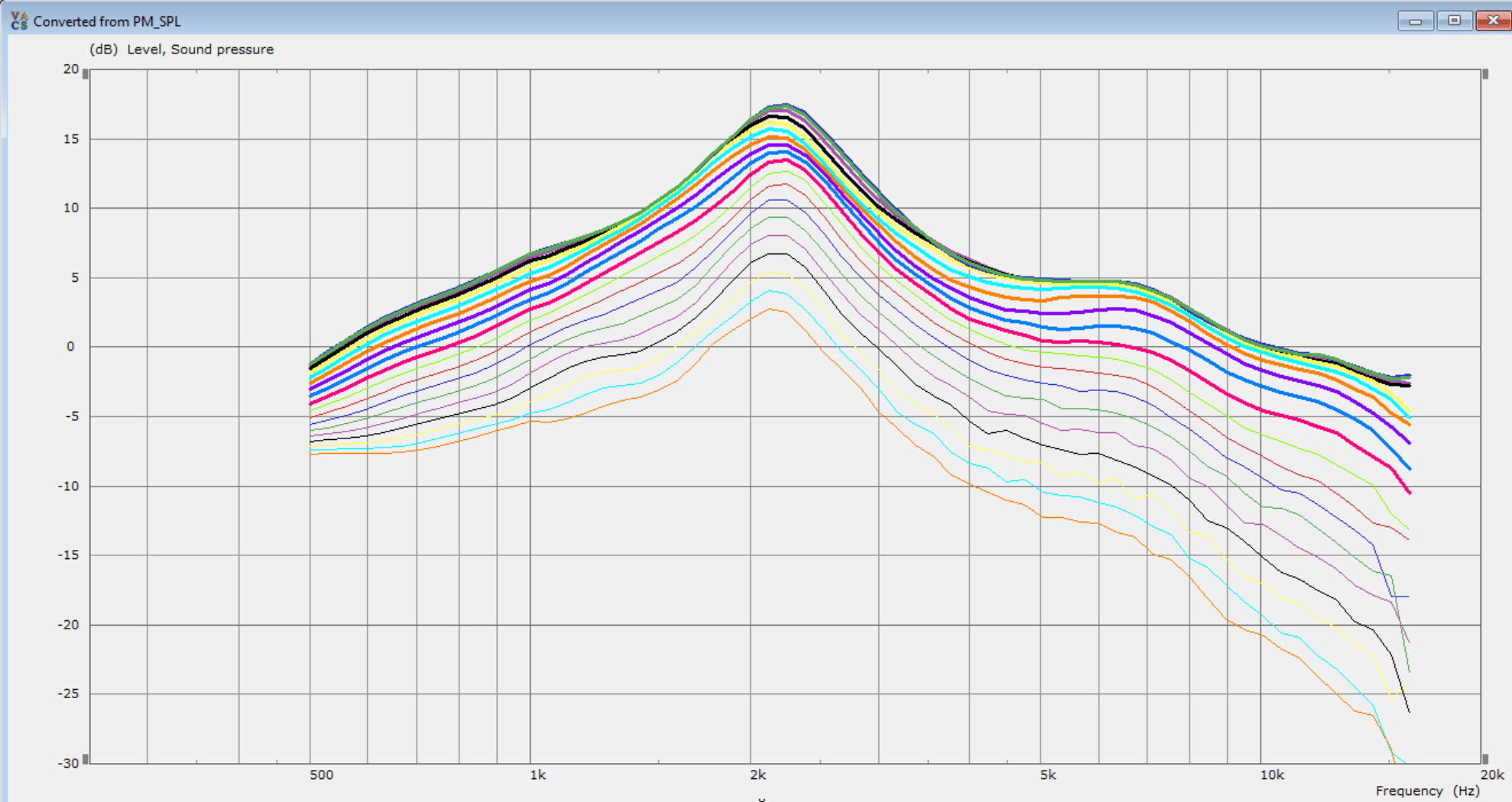

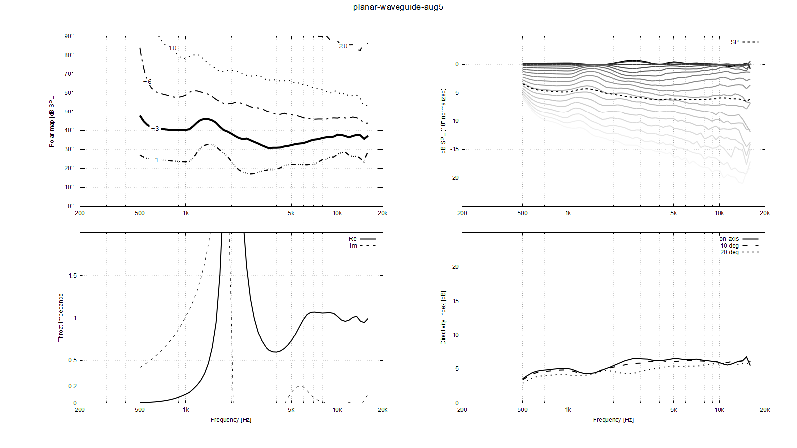

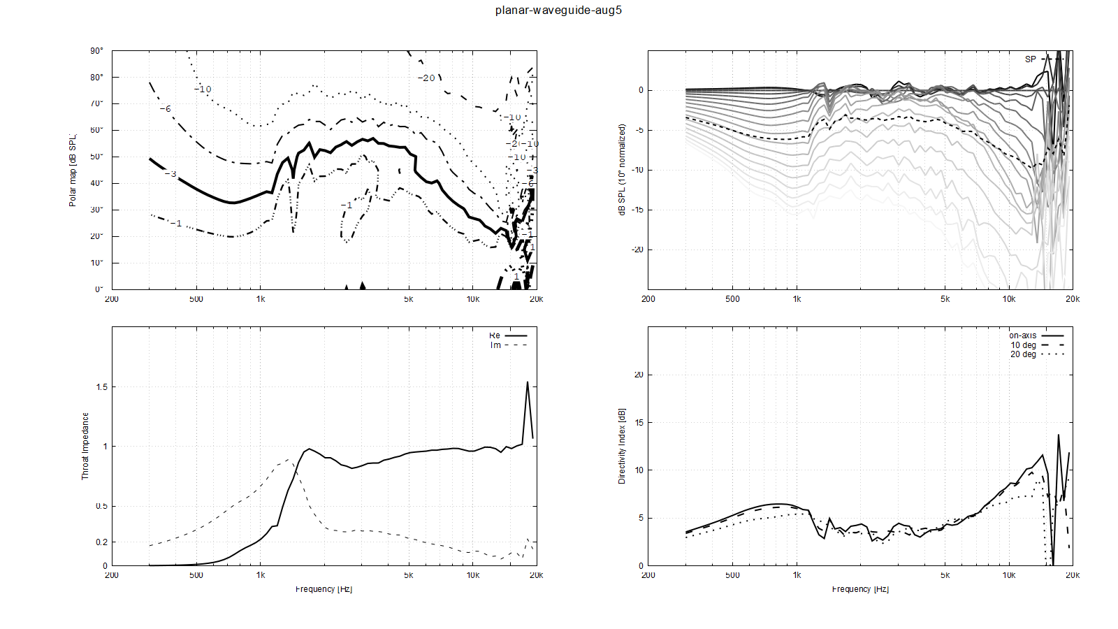

Here's how the waveguide performs with a 38.1mm stub (1.5"):
Attached is a sim of how it performs with a 25.4mm stub. That's about as short as it can get, because the 'stub' that's built into the Celestion CDX1-1445 itself is 19.05mm long
What I notice in the sim is that shortening the stub raises the frequency of the resonance
The secondary resonance is also reduced quite a bit

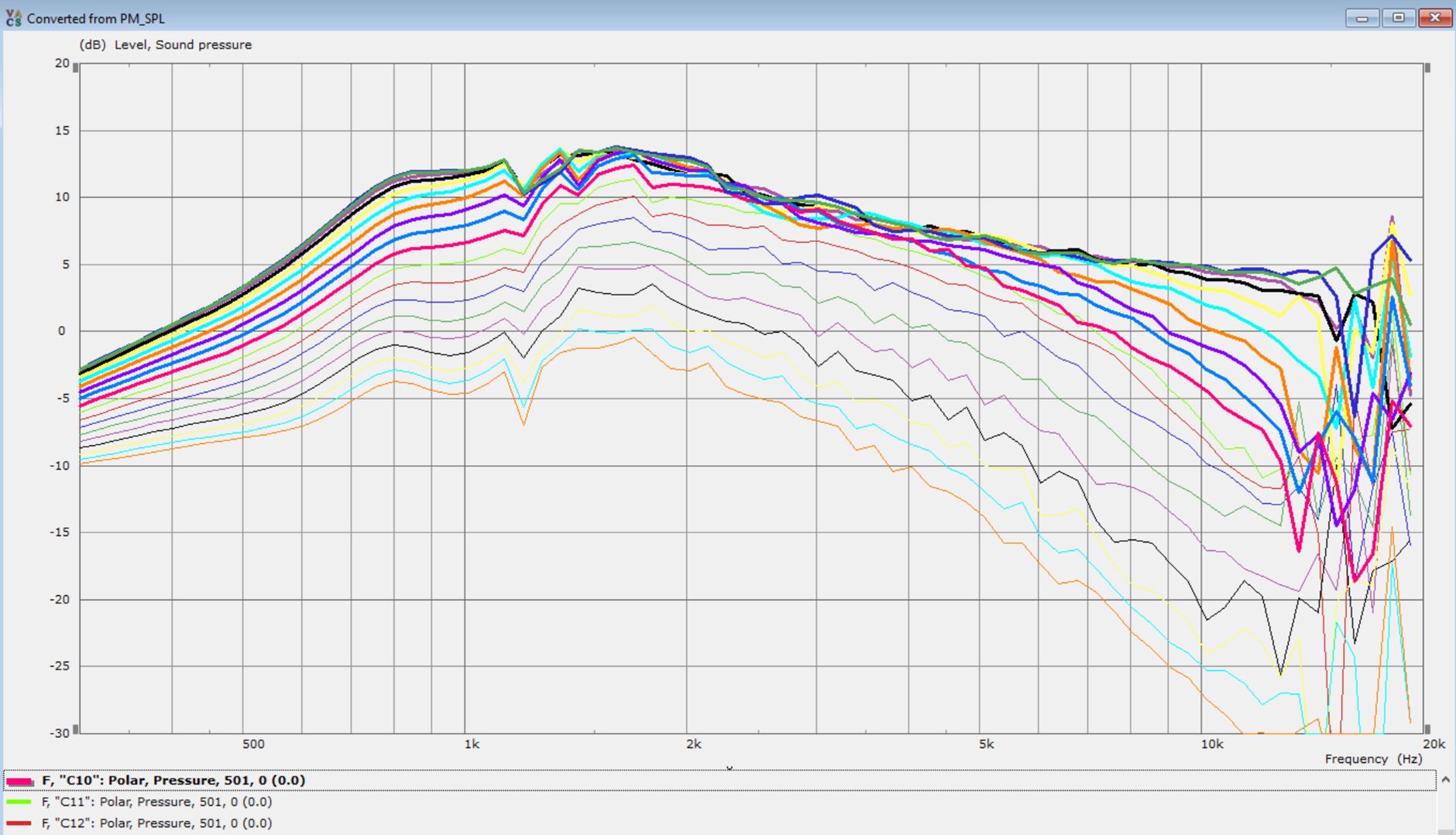

This is exciting, we FINALLY have something that the JBL Image Control Waveguides do better at!
I've been building and pondering those silly waveguides for about ten years now, and the more of them I built, the more I felt that Geddes' initial hunch was correct: it's just marketing and cosmetics and a plain ol' oblate spheroidal waveguide works better.

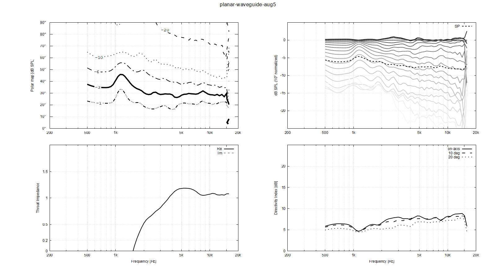

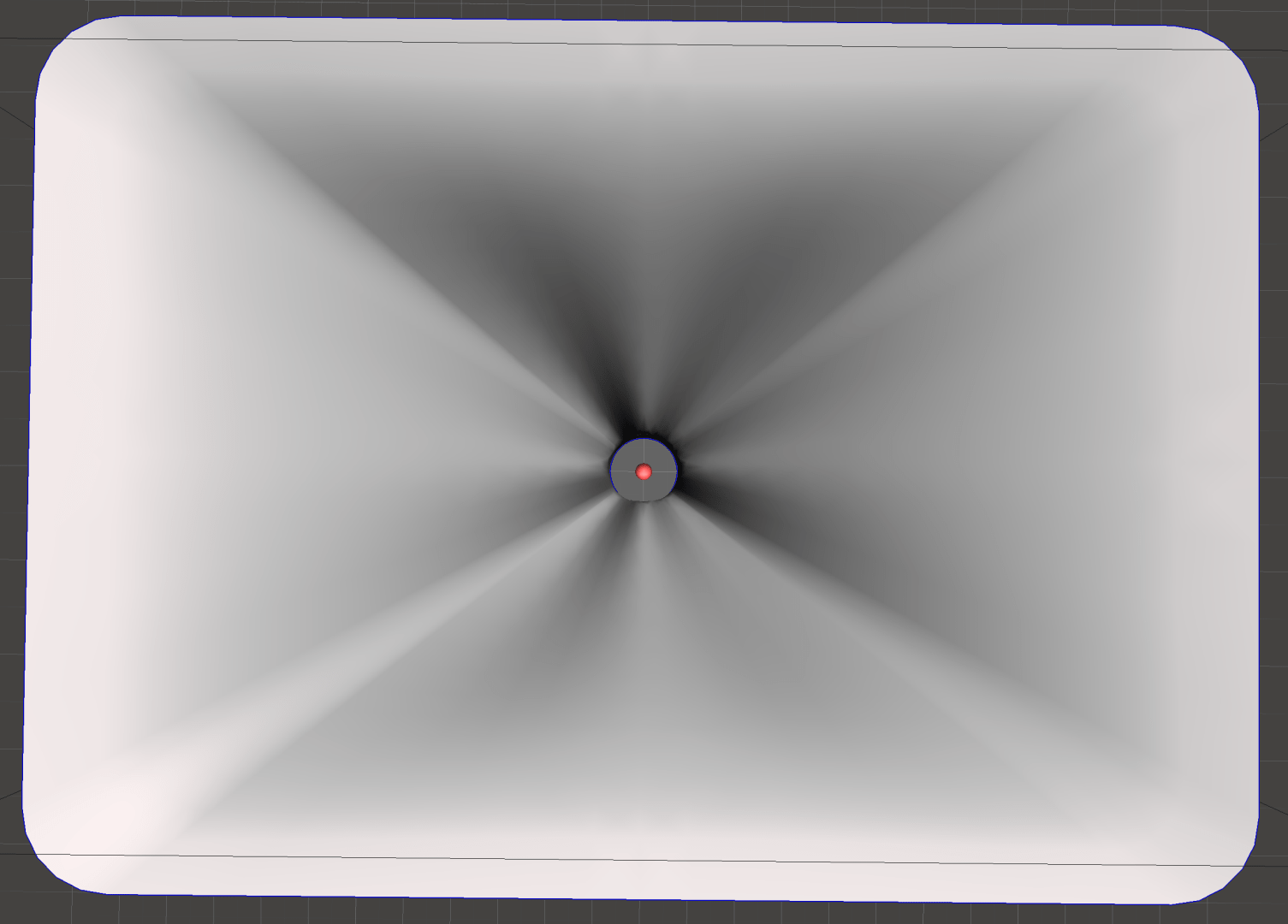

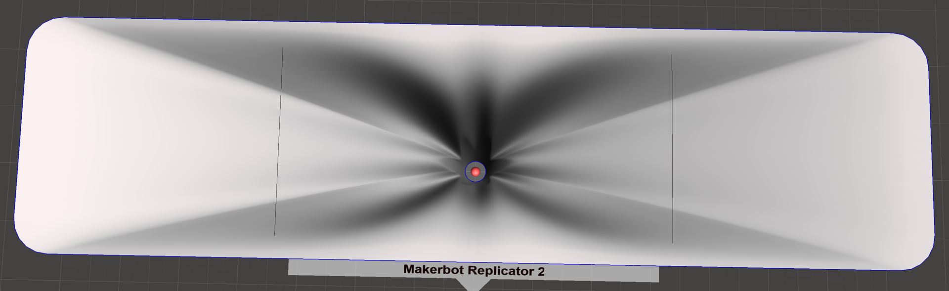

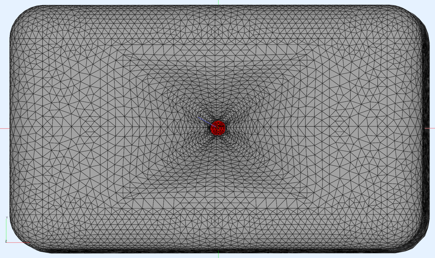

Here's what I did:
1) I took the waveguide dimensions from post #3, including a 'stub' that is the same length
2) I replaced the 'stub' with a diffraction slot that's largely identical to the JBL Image Control Waveguides. (The M2 was the first of the ICWs)
Lo and behold:
1) The second resonance is absent
2) The first resonance is broader. Whether that is good or bad is open to debate, but it should be easier to eliminate with EQ
Check out the attached sims, then compare them to post #3. Height, width and depth are the same

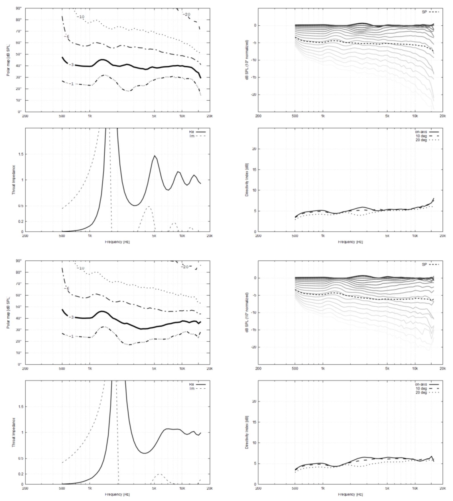

Here's a comparison of the waveguide from post #3 and my last post a few minutes ago
What I see:
1) The Image Control Waveguide (the four graphs at the top) has fewer resonant peaks. It's resonant but the resonances are spread out. I'm too lazy to look it up in my own thread, but I posted a quote from Charles Sprinkle in my M2 thread where Sprinkle speculated that the 'beaks' spread out reflections (or was it resonances?)
2) The waveguide from post 3 (the four graphs at the bottom) has polars that are a little better. I think the reason for this is because the 'beaks' on the Image Control Waveguide create a wavefront that isn't perfectly spherical. Samsung published a paper detailing how they later used an iterative approach to design these waveguides. I imagine that's because they're aware that it's better to sim a thousand waveguides and then select the one which is ideal. Some people in Mabat's ATH thread have done just that, using automation.
What I see:

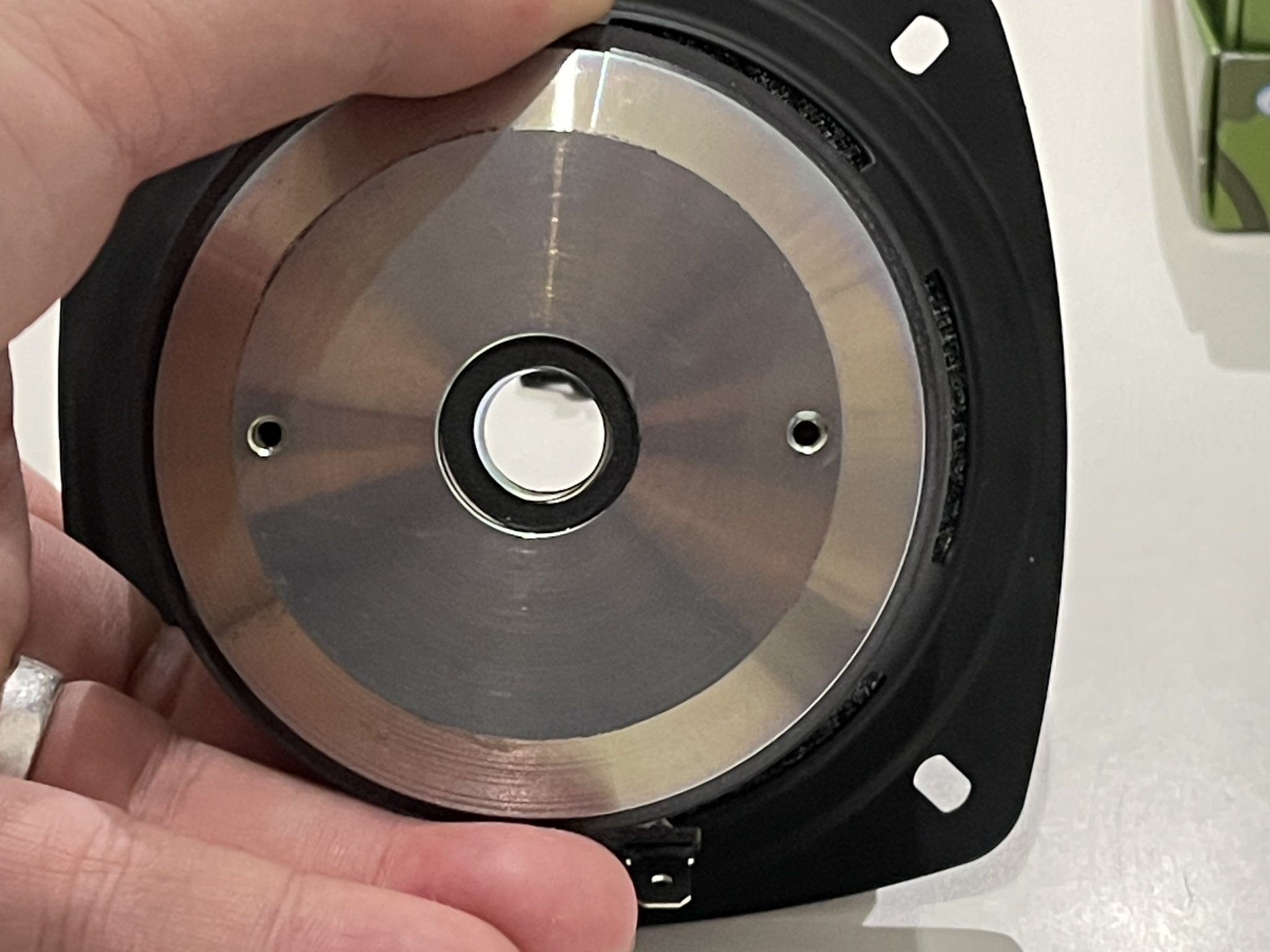

FYI - the exit angle on a Celestion CDX1-1445 is 22.6 degrees. The diameter of the throat, just above the diaphragm, where sound enters the phase plug, is 17.78mm (0.7")
It’s so fun that this cheap 4” coaxial might not have such a awfull designed passage thru the motor structure. Well not as long as it’s terminated by a well designed waveguide.
edit: https://www.thomann.de/se/the_box_pro_4_coax_speaker_mcx4.htm

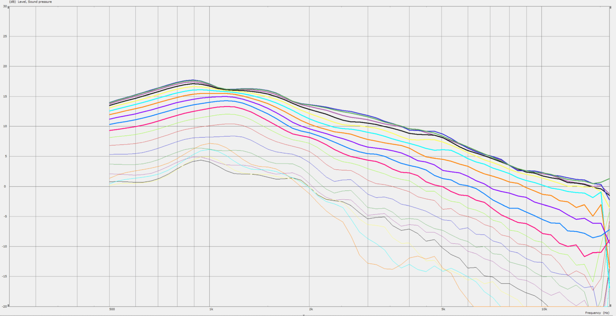

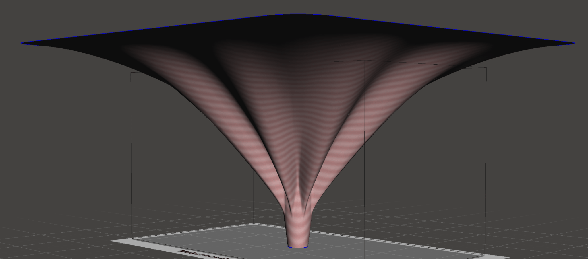

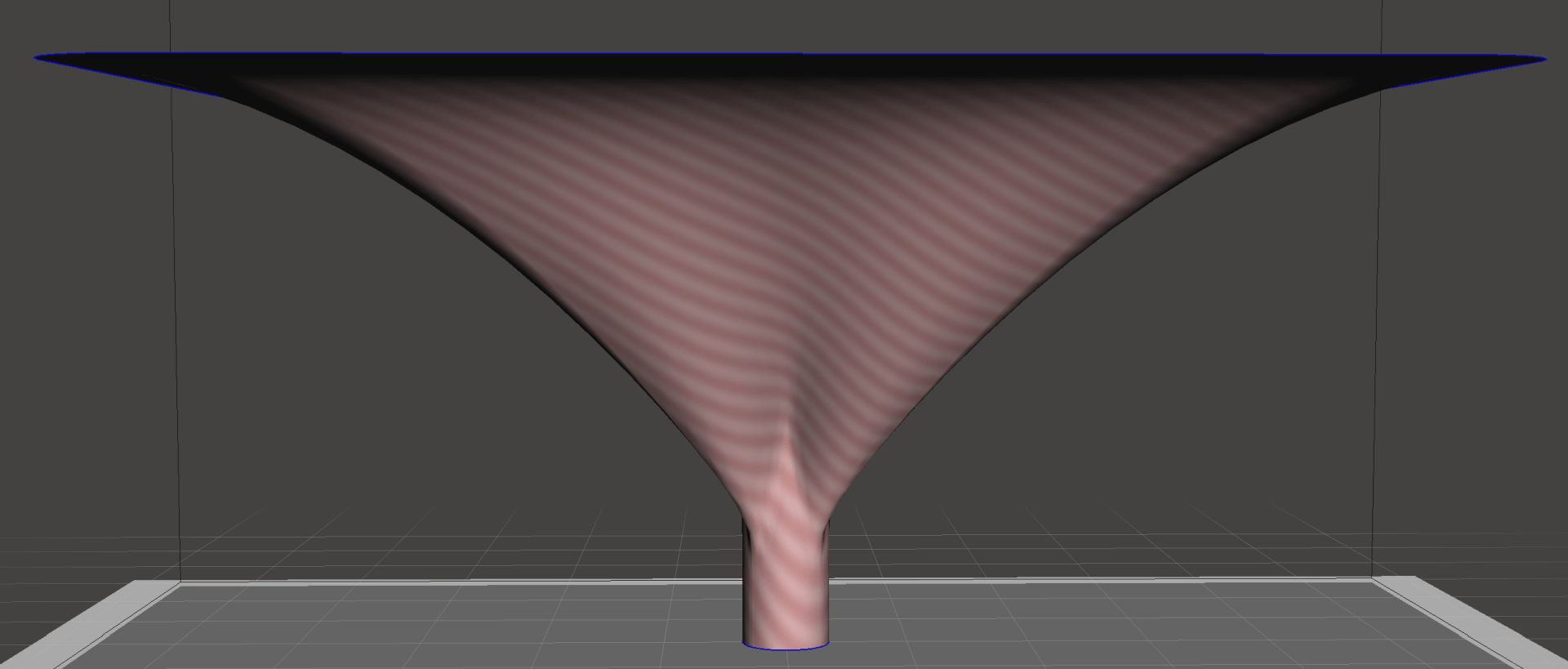

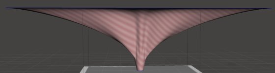

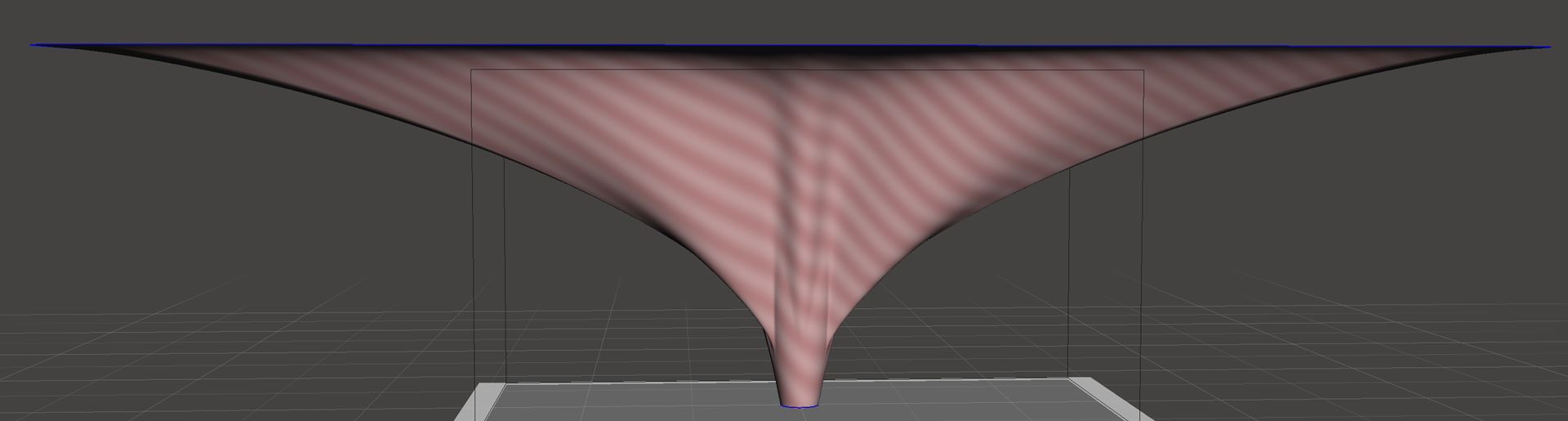

Doubling the number of 'beaks' from four to eight seems to work quite well. Compare these sims with post 26.
There are quite a few more things going on here, so the improved performance may be due to something else as well:
1) This waveguide is about twice as big, measuring 14" x 14" x 7"
2) The throat on this waveguide has a little bit of expansion, whereas the other sims from this thread had an expansion rate of zero. This waveguide has a throat with a fifteen degree exit angle.
3) Overall response curve is a bit lumpy. I think a lot of this is because I removed the roundover. I removed the roundover for cosmetic reasons, basically trying to come up with something similar to the A for Ara speakers (see red speaker that's attached)
Having said that, check out how the resonance in the upper treble is completely gone now.
If you look at the attached report, you'll notice that the more beaks there are, the more it starts to behave as if the beaks aren't there at all. IE, the more you add, the more the waveguide begins to behave like a plain ol' ATH waveguide with no diffraction slot at all.
So there's probably some "happy medium" between two beaks and sixteen beaks, where that is is anyone's guess I think. JBL uses four. A conventional diffraction horn basically has two, since a traditional diffraction slot is basically a rectangle or an ellipse.

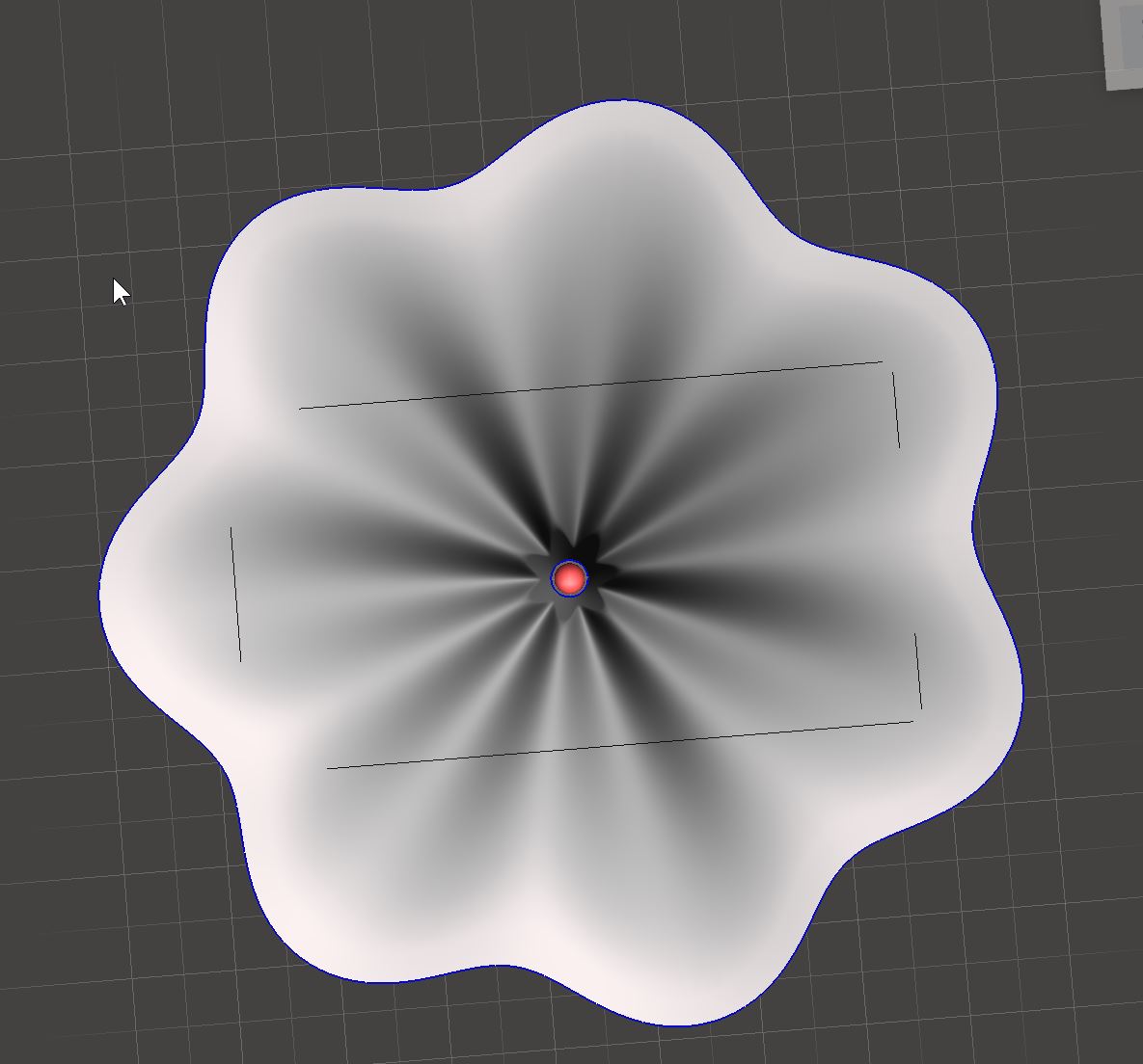

Have you ever tried to simulate an odd number, for example 5 or 7, and to try identical but also slightly different spacing between them ?Doubling the number of 'beaks' from four to eight seems to work quite well. Compare these sims with post 26.
That's pretty wild, I didn't even know that it's possible, but it is
Basically the number of beaks is equal to the lines highlighted in bold below times two. Until today, I'd never tried doing it with fractional numbers, but it works!
I have noticed that many phase plugs use an odd number of channels. KEF in particular. I imagine odd is better than even because of resonances being harmonic.

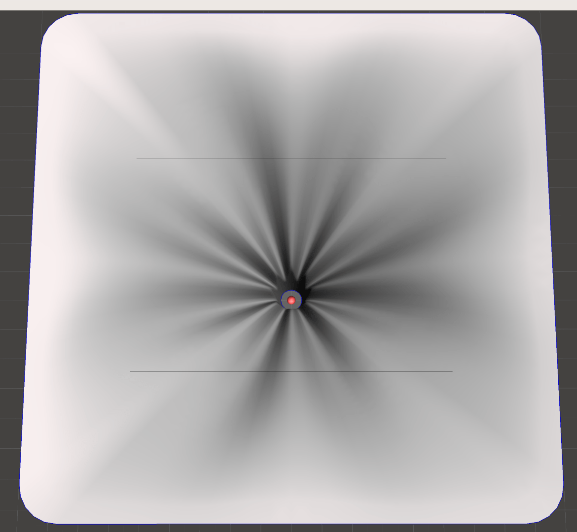

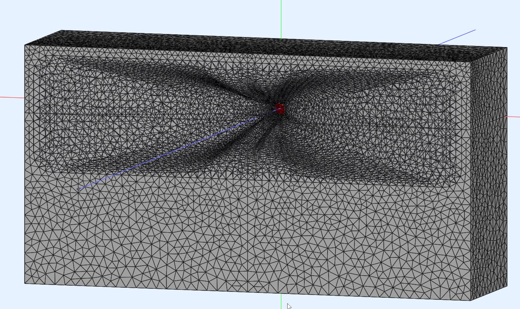

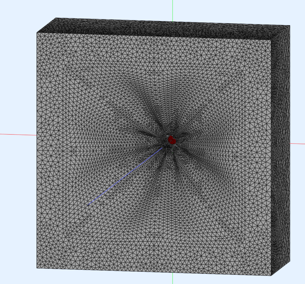

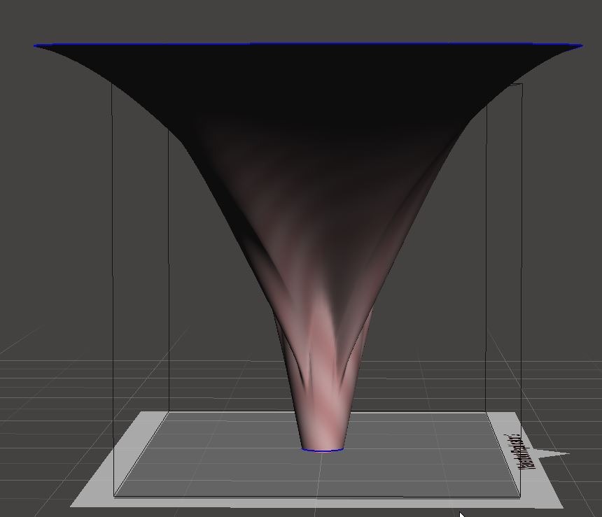

So I made a design reminscent of the JBL 4367, but I don't think the results were particularly good. It took SIX HOURS to render with 14 Xeon cores and 64GB of ram, so putting the results here for posterity.
What I notice in particular is that when the waveguide is very asymmetric, the wavefront doesn't seems to 'squish' into an asymmetric shape. In particular, notice in the sims how in the horizontal axis, it's almost like the waveguide isn't there in the upper treble. (The on and off axis curves are virtually identical, as if the tweeter was on a flat baffle.)
