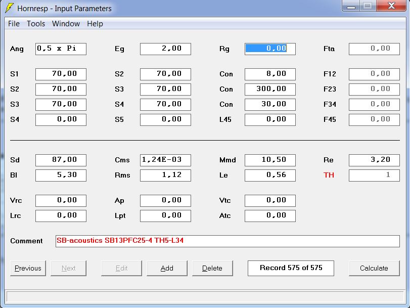

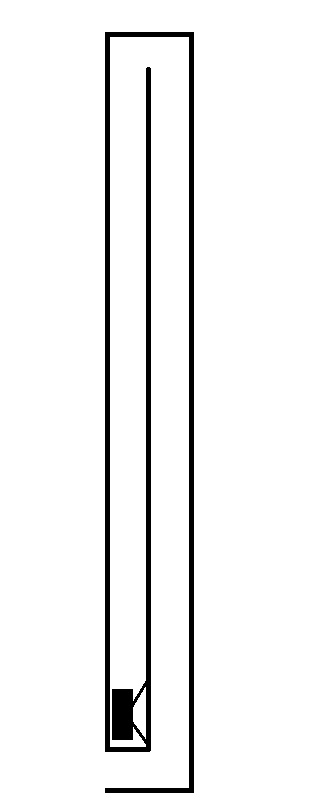

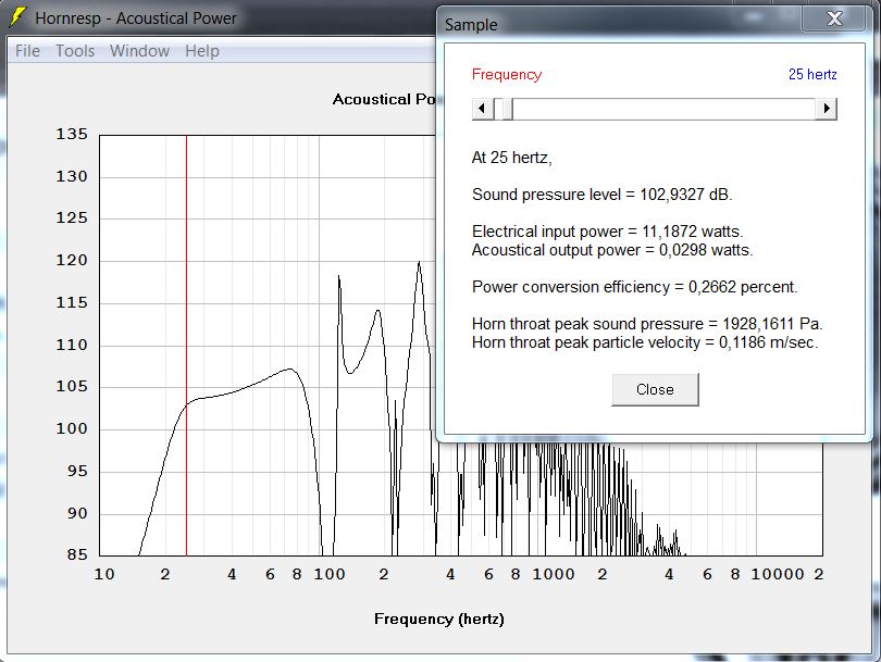

A tall and slender tapped pipe with a 5 inch driver and with a slightly longer then normal L34 will reproduce 25 Hz while taking up very little floor space. It should be tucked up into a corner, and once corner loaded will reproduce 102 dB plus room gain at 25 Hz with 12 watts.

1700 mm high, 172 mm deep and 176 mm wide if built out of 18 mm plywood with double layer in the baffle (more room for the magnet).
within the rough budget of 200$, that is also under 80L? I don't need high output power. And if you have an idea for a driver, please leave that below (probably below ~100$)
This is a total volume of 52 liters, well below your goal of "under 80 L".

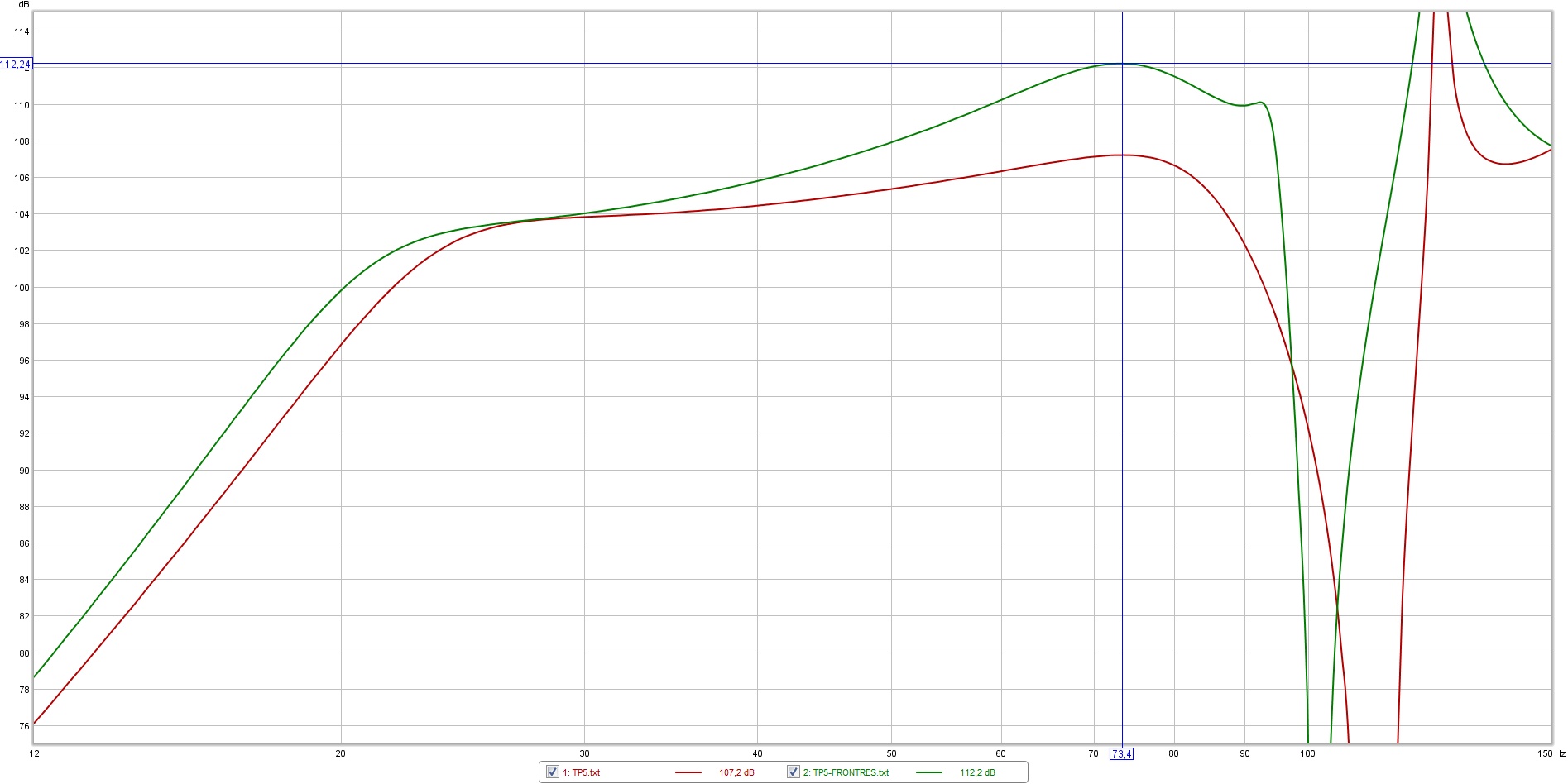

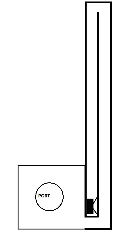

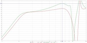

With the addition of a 24 liter (32,6 x 32,6 x 32,6 cm box) Helmholtz resonator making this into an 8th order bandpass/tapped horn hybrid it will gain a few Hz downward extension and 15 Hz upward usable bandwidth with a small but nice peak around the midbass. It will sound much more punchy and exciting with the frontresonator.
