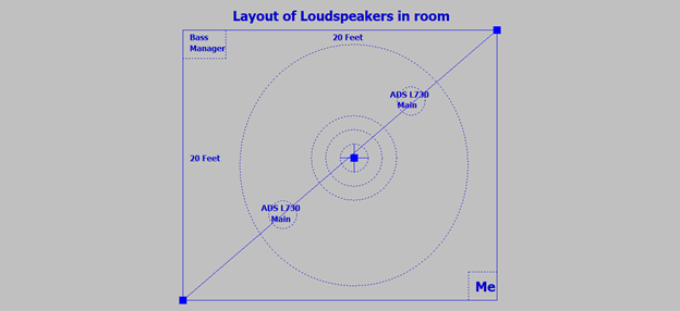

I've attached the layout of my stereo set-up. I hope that I am not intruding on this thread. I am experimenting with bass management in the corner opposite to my seat which is 1-2 feet away from my corner.
