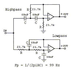

The filter's op amp does act as a buffer.
I would not use an output resistor for the input buffer, because the filter circuit works best with
a low source impedance. A pair of 100 ohm resistors on the filter circuit's op amp outputs is fine.
Ok 100E at filters output only!

i'll use two 47k metal films in parallel instead of 23.7 k.
What type of pot? i have 10k linear.
what is the input level for this circuit? Gain, output level?
Do you recommend capacitor for dc blocking?
I'm comfortable with bipolar supply.
Add decoupling capacitor, 100nF between +15V and -15V close to each opamp, the NE5532 definitely needs this, some opamps are less critical.
The Sallen+Key filter circuits are unity gain in the passband normally.
Place between preamp output and individual power amp inputs, so whatever level that is.
You can make the resistors smaller and capacitors larger to reduce impedance which lowers noise floor. Something more like 2--5k for resistors will be good for this (it may be an issue with sensitive tweeters, should the crossover happen to be the limiting factor for low-noise)
Thnks. I know, douglas self recommends that & he says NO NO to tl072 for sallenkey filters! 🙄Add decoupling capacitor, 100nF between +15V and -15V close to each opamp, the NE5532 definitely needs this, some opamps are less critical.
5.5k & 15nf is close, please see 🙂You can make the resistors smaller and capacitors larger to reduce impedance which lowers noise floor. Something more like 2--5k for resistors will be good for this (it may be an issue with sensitive tweeters, should the crossover happen to be the limiting factor for low-noise)

Hi rayma. The filter(good, as much as i understand) you have recommend me is a 2nd order (12dB/octave) linkwitz-riley filter & has a Q of 0.5 (sub-Bessel), and the crossover frequencies align at the -6dB frequency rather than theThe LF alignment of the woofer doesn't affect how the crossover is added.
-3dB frequency found with Butterworth filters(Source: ESP).
My question is while the Q of my enclosure is near 1.0,
why did you choose sub-bessel type filter? On the other
side; interestingly you choose 2nd order filter for sealed box(same rolloff slope). Can you explain in little detail?
My next question is, can i play with other values
(like 5.5k & 15nf) instead of 3.3nf & 23.7k using this equation? 1/(2piRC) (the value you recommend is very good, close to crossover point but 3.3nf is bit of odd value, maybe it is available in mouser but i don't know if it is available here, locally). My last question is, though i trust you & i aware of this configuration but i heard that changing the polarity of one of the driver can effect sound quality, is it true? how much? & why not invert the signal of high pass filter??😕

You can try this circuit. It is set for 100Hz, but you will need to set the frequency to around 2kHz.
Keep all the resistors the same. Divide all the capacitors by 20. Then 68nF/20 ~ 3.3nF each.
Use sockets for the ICs so they can be easily replaced. Add a 10k stereo volume control after the
high pass circuit to reduce the tweeter level. Connect the tweeter in reverse polarity.
https://www.linkwitzlab.com/images/protos/LR2.gif
This circuit assumes a bipolar power supply with +15V/-15V supplies. If you must use a single 30V supply,
the circuit will be somewhat different, with more parts.
