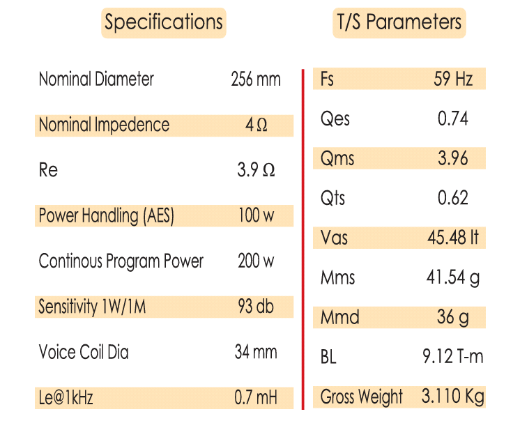

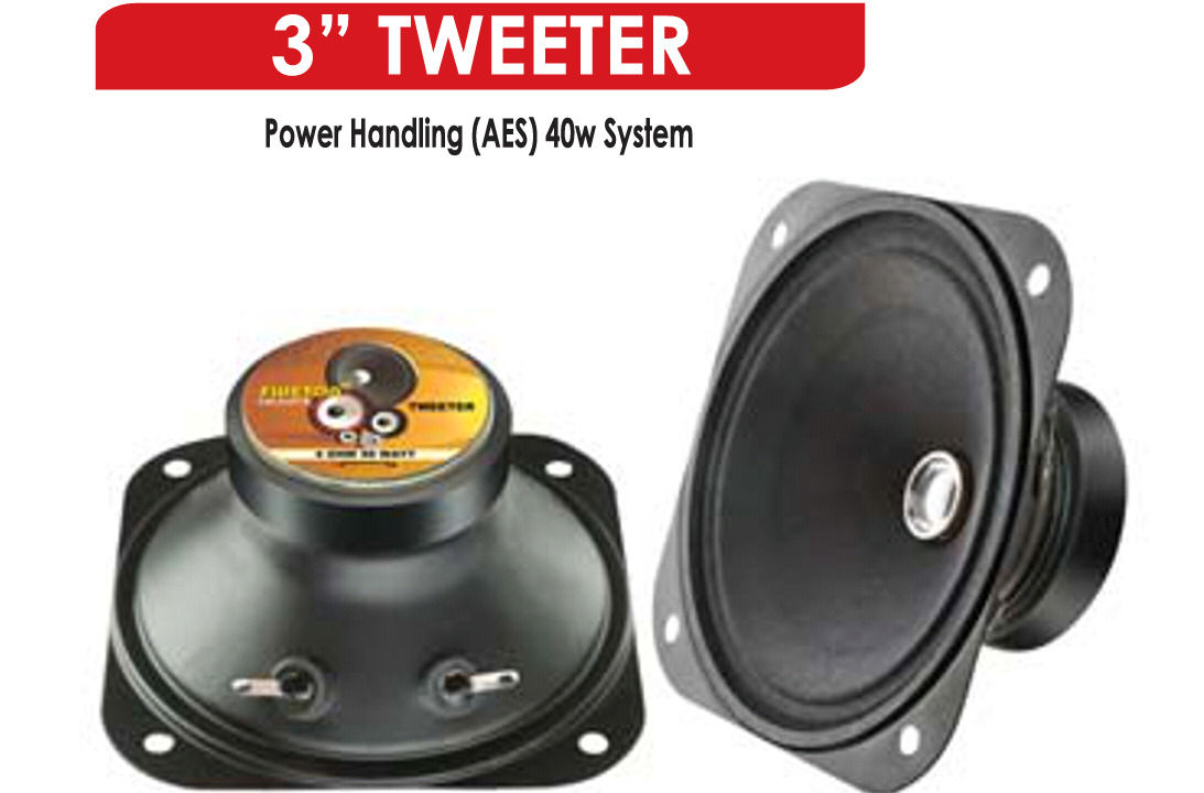

The QTC of my box is near 1. i have no info on tweeters except 40watt power handling & impedance(4ohm), i can post photo only 🙁

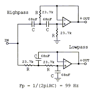

You can try this circuit. It is set for 100Hz, but you will need to set the frequency to around 2kHz.
Keep all the resistors the same. Divide all the capacitors by 20. Then 68nF/20 ~ 3.3nF each.
Use sockets for the ICs so they can be easily replaced. Add a 10k stereo volume control after the
high pass circuit to reduce the tweeter level. Connect the tweeter in reverse polarity.

This circuit assumes a bipolar power supply with +15V/-15V supplies. If you must use a single 30V supply,
the circuit will be somewhat different, with more parts.
The LF alignment of the woofer doesn't affect how the crossover is added.

Wow thnks...you're fast!
i'll use two 47k metal films in parallel instead of 23.7 k.
What type of pot? i have 10k linear.
what is the input level for this circuit? Gain, output level?
Do you recommend capacitor for dc blocking?
I'm comfortable with bipolar supply.
The 10k linear pot is fine, if you have either a stereo pot, or two mono pots.
That should be a one-time adjustment to match the woofer and tweeter levels.
This crossover has unity gain, and is for line level use, like at the output of a preamp.
There's no need for DC blocking capacitors, since the amplifiers operate at unity DC gain.
If you have extra op amps, add an input buffer before the filter circuit and it will work better.
The input coupling capacitor shown here is not necessary, and the input resistor value is not critical.
https://www.linkwitzlab.com/images/protos/buffer.gif

why connect the tweeter in reverse polarity?
will you explain please? 🙂
The tweeter's active filter circuit has -180 degree phase throughout its pass band,
so the tweeter's polarity should be reversed to compensate.
The tweeter's active filter has -180 phase throughout its pass band, so the tweeter's polarity

For high frequencies, C approaches a short. Thus the treble section becomes an inverting amplifier, with its noninverting input ~shorted to ground.
You still have to adapt the R and C values according to the desired crossover frequency and impedances - I very much doubt that you'll want to cross over at 99 Hz as shown, right?
Your tweeter's 40 W system power spec is for a given crossover frequency and order. The driver itself probably won't handle more than 1-5 W.
It's unfortunate that you have zero specs on this, which makes it hard to choose a good crossover frequency. The slightly smaller Visaton TW6NG (a 6 cm / 2.5" job) is good for about 2-3 kHz up. You probably don't want to run most 10" woofers beyond 1.5 or 2 kHz. Finding enough overlap may prove a bit difficult. Not to mention that directivity is likely to be problematic. (Ideally, the tweeter would have to be placed in a waveguide roughly the woofer's size. No, you probably can't buy one off the shelf.)

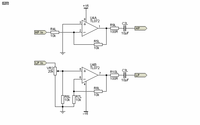

Ok, i'll add a volume control pot before the buffer op-amp.The 10k linear pot is fine, if you have either a stereo pot, or two mono pots.
if i want to use lowpass section for my woofers what changes need to be made in the low pass circuit?You can try this circuit. It is set for 100Hz, but you will need to set the frequency to around 2kHz.
The cutoff frequency is very high, 100hz as you know 🙄
What do you recommend; input buffer without gain or output buffer with gain? Rod elliot suggest both, but i don't want to use three stereo opamp here 🙁

The cutoff frequency is very high, 100hz as you know(
The low pass circuit does not affect the deep bass. It is for the 2kHz crossover point.
As said before, use 3.3nF capacitor and same resistors.
Oh, ok then 3.3nf for both circuits 🙂
anything you want to say about buffers?
(plz see my earlier post).
Can i change the input buffer to non-inverting amplifier with 6dB of gain if i face gain related problem?
The source would be mp3 player, this is why i'm asking?
Sorry for so many questions.
You can have as much gain in the buffer as you want.
If you have enough gain now, adding the filter will not change that, since it has unity gain.
