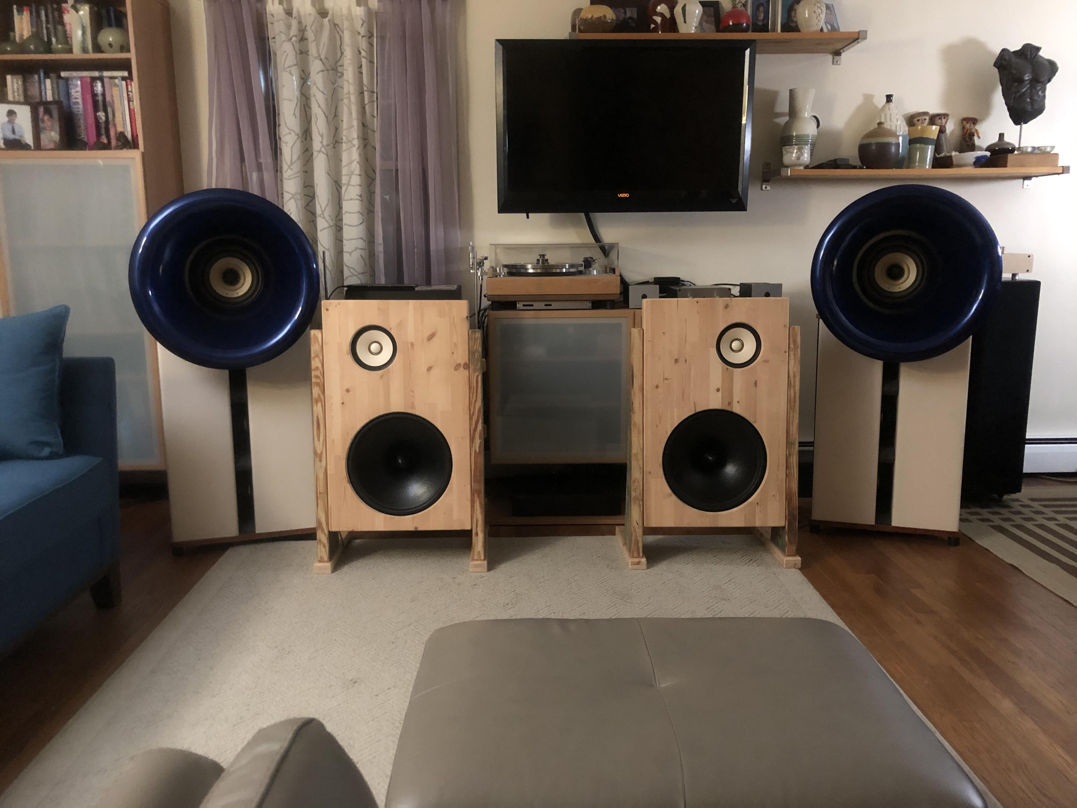

I have been tinkering with a variety of bi-amp systems for the better part of 10 years.
I’ve tried several combinations.
I got my hands on a used First Watt B5 to make things easier. It is better than the Mini DSP I tried in my opinion.
I was working with some old Rotel HT amps for bass that were bridged to about 125 watts for a long time.
They were used with several amps I had built or own (ACA, F2J monoblocks, Quicksilver horn monos, Sony VFET) driving full range speakers.
I built a slot loaded bass panel at one point based on NP’s article.
It took me a while to get bass that I felt was right for the fullrange drivers I was experimenting with in horns and open baffles.
The bass panels didn’t work. I had to scale them down to fit reasonably in my living room.
No matter what I had powering them (6) 8” woofers per channel never produced bass like a 15-18” woofer.
I always had to use a HT sub to fill in what they lacked at the bottom end and even then the bass was boomy.
I found some Acoustic Elegance Dipole 15’s used. As soon as I put them in simple modest sized baffles and tried them in the system there was a huge change. I finally had bass and midbass.
However, there wasn’t quite the speed and impact I was looking for.

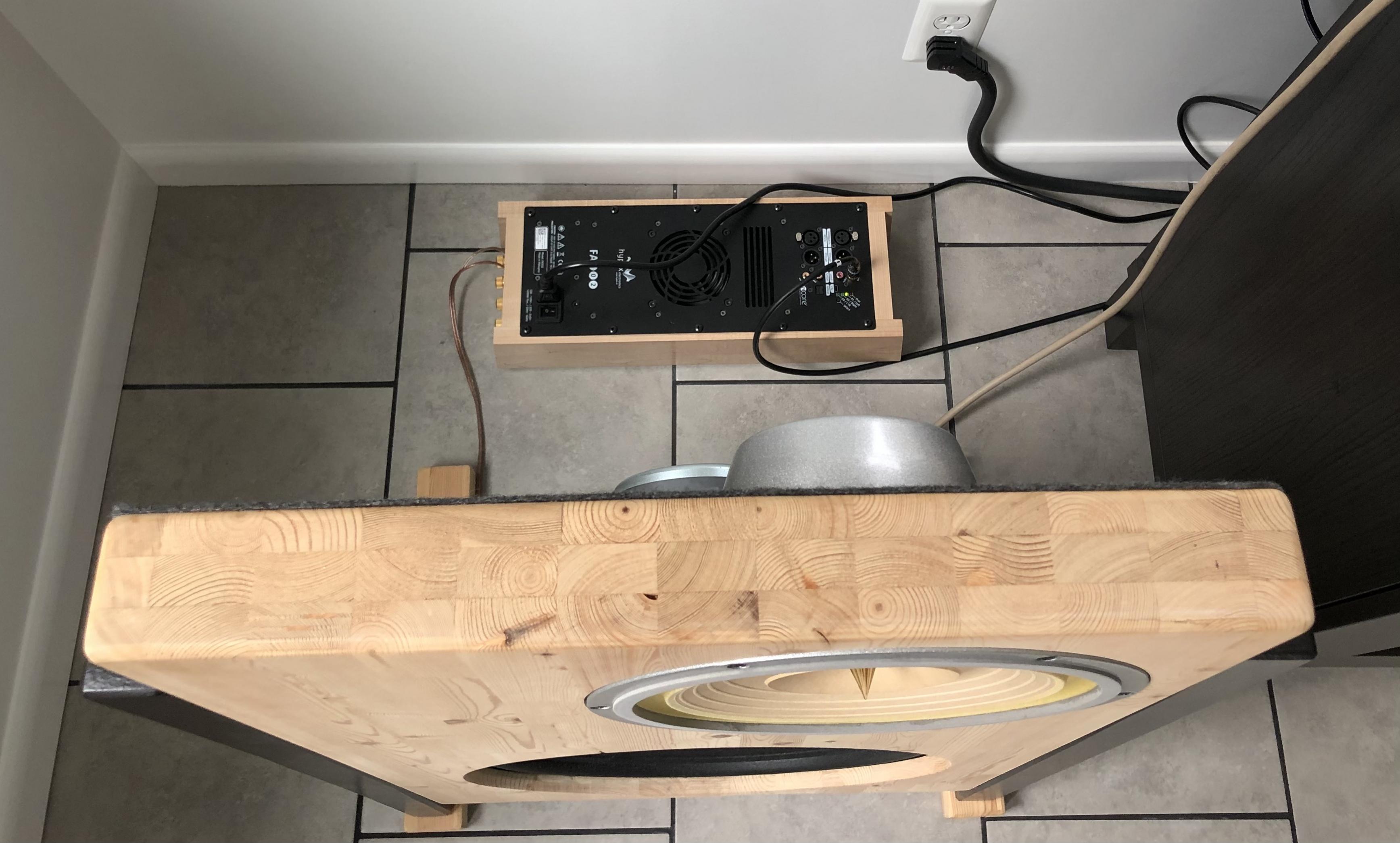

I then got my hands on some Hypex amps to try with the woofers.
Again, the change was impressive. There is no boomy bass, yet there is good impact and very good clarity. More power than I could ever need.

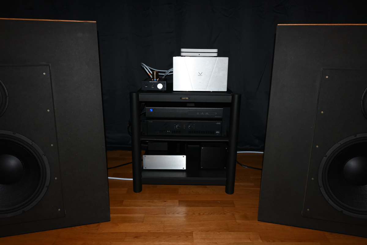

In my case I have an OB system (OBL-15 as some may know).
It has a normal analog crossover that is is prepared for bi-amp. 15" woofer has its own separate crossover and is designed to "work perfect". So what I am after is how bass response change form using a single low power amp with relative low damping factor to an amp that has damping factor around 100 or so. Does that give the bass response more punch?

OBL-15 gives "subjective" good bass response to just below 30 Hz when I try a test CD with low tones. At 20 Hz it is "dead". So if it should go all the way to 20 Hz a lot of equalization is needed (powerful amp).
In OBL-15 the 15" woofer takes over at about 180 Hz.
So the idea is just to connect the class-D amp to the terminal of the woofer analog crossover and utilize the work the designed has done to make the frequency response even. So start up with adjust class-D level to level of the small amp. It should be easy done via a sine test tone as input and then measure using a couple of DMMs.

My latest setup with dedicated bass amp (STA-1000D) and VFET amp for mid and tweeter is very nice. Bass control is very good and more "airy" than before. It can play "insane" loud without sounding compressed.
I have a feeling that VFET amp has more details compare to if it drives the whole speaker.
The SSII preamp is also back in service now as STA-1000D has 5k input impedance so a decent preamp is needed. SSII has 100R to RCA out. According to Pete Millett it should work but I could lower them to 10R or 22R. But seems to work fine "as-is".
STA-1000D has input level pots at the front. I played a test sine from a test CD and used a DMM to measure output from VFET amp and adjusted output from STA-1000D to same level.
