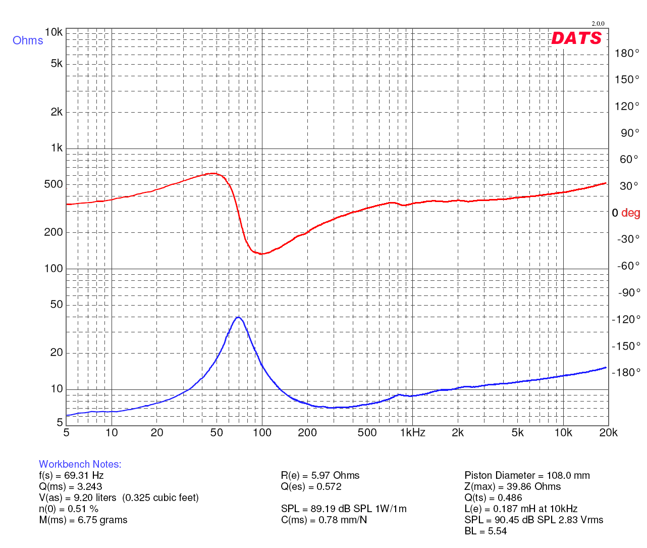

TS parameters measured for W5-2143 with DATS.
| Tang Band W5-2143 measured sensitivity at 90.45dB at 2.83v; Qts=0.486
Sd=91.6cm2
Re=5.97ohms
fs=69Hz
Qms=2.243
Qes=0.572
Mms=6.75g
Bl=5.54Tm
Le=0.187mH
Vas=9.2L

Thank you for making these available for everybody; however... there is still something fishy going on: Sd=94 cm2 (TangBand info); Sd=88.2 cm2 (italian website), Sd=91.6 cm2 (XRK measured)... I mean how hard can it be to measure this one parameter that is always constant with every unit from the same model?
Honestly I don't know how much to trust any of these measurements (because of the Sd "variation")... I'm not in the situation to use these numbers (yet, but I already ordered a pair... let's call it an experiment not my "latest greatest creation") but there is allot of variation on key TS parameters.
Because there is to a point no standardisation in audio measurements. Sd may be taken as bald cone area; it may be taken as including half the surround in addition, or it may include or (exclude) something else also. Likewise, many drivers give different results at different voltage drive levels. Sensitivity may be taken as an average over the entire range, a narrow band, a specific point or points. And that's before you get to items like Xmax where on top of lack of measurement consistency, there is no single definition for what it even is, or is supposed to indicate, and multiple different ways of generating a figure, all of which give different values if applied to the same driver. There's nothing any of us can do about this. We can all whine, whinge, complain, point out the obvious issues that result from lack of standardisation, and nothing will change. So since there's no alternative, we live with it.
I measure the diameter of the active membrane as starting at the middle of the surround - in this case it is a convex half roll, so easy to see. That's been pretty consistent with other manufacturers TS parameters on Sd.
Like Scottmoose said, many ways to measure Sd, here are some figures for you. The diameters of my W5-2143 are:

Are you sure you didn't forget to subtract the area that is actually not moving - phase plug? Sd should be the area that is active in pushing air... the surround is usually taken at half way point.
You are absolutely right, the diameter of the phase plug is 24.6 mm ~ 4.75 cm2, figures corrected for phase plug:
  • Paper cone to edge of surrounding: 89.5 mm ~ 62.91 - 4.75 = 58.16 cm2
  • To half the surrounding: 109.1 mm ~ 93.48 - 4.75 = 88.73 cm2
  • To outer edge of surrounding: 118.7 mm ~ 110.66 - 4.75 = 105.91 cm2
Ok... presuming everything you measured there is correct it means that Sd=88.5 cm2 (as an aprox. average between 88.2 and 88.7)... so the people at Dibirama got it right. The TangBand people it seems where not aware that their own driver had a phase plug... Anyway... still 3 different looking sets of TS parameters... just go bigger with the enclosure... you know: just to be safe (bigger is better principle).
