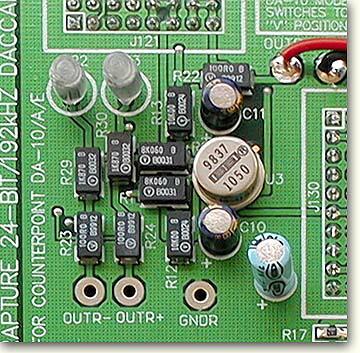

Hi!
I´ve just bought a couple of 4,7 uF "dry elyts" to use together
with 100nF (ceramics) for bypassing AD797, OPA627 and NE5532:s.
The catalogue from the swedish distributor (ELFA) claims that
the dry elyt:s have the same characteristics as tantalums, but
lacking the negative side of tants (spontaneous short-circuiting).
The "dry elyts" sure looks like tants, just looking at them,
but I would like to know if there is anyone here that has tried
them out and what your opinion on these devices are?
/ eplpwr
Hi Mads!
No, I'm not referring to OS-CON:s, although I know
they're also dry elyts. The type I've got is made
by BC components, and are sort of "drop formed",
like tantalums normally are. I'll try to attach
an image, hopefully it works...
