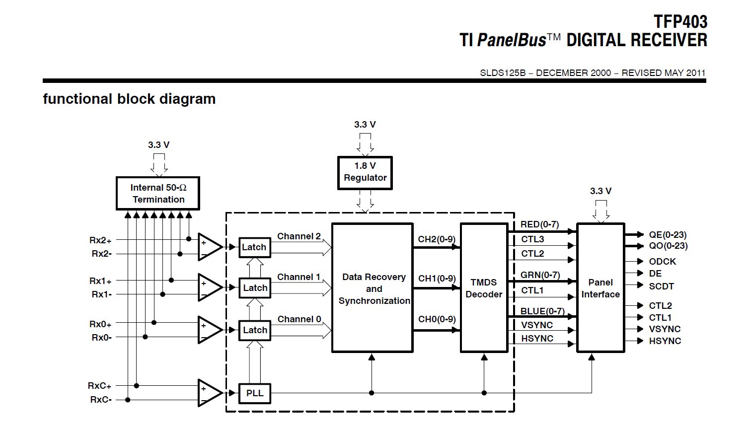

For better understanding what's HDMI, one can start with DVI, the HDMI ancestor. In DVI, there are three serial lines : red, green, blue. Plus one common bit clock. There is no audio in the digital stream. There is no I2C bus as general control (CEC).

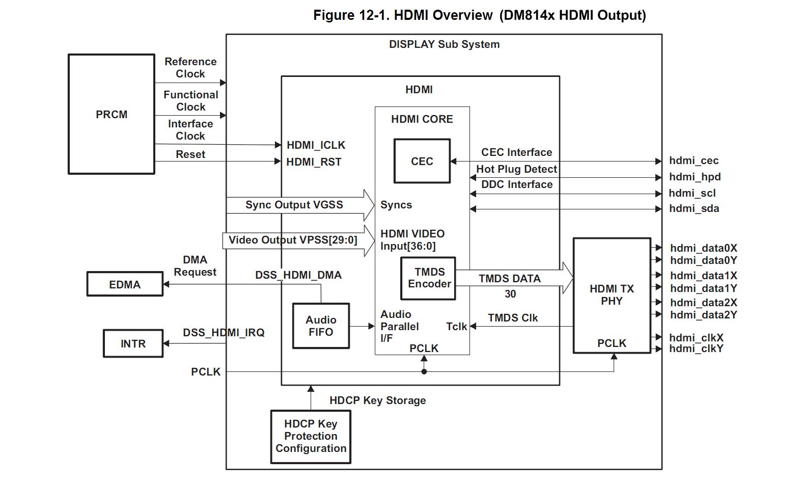

The DM814x has one HDMI port, as output. Of course we can't use it as input. Note the dedicatd 36-bit video bus (extracting data from RAM) feeding the TDMS encoder. Note how audio gets interleaved with video, using EDMA requests. Note the presence of CEC (aka I2C). Note the HDCP management and key.

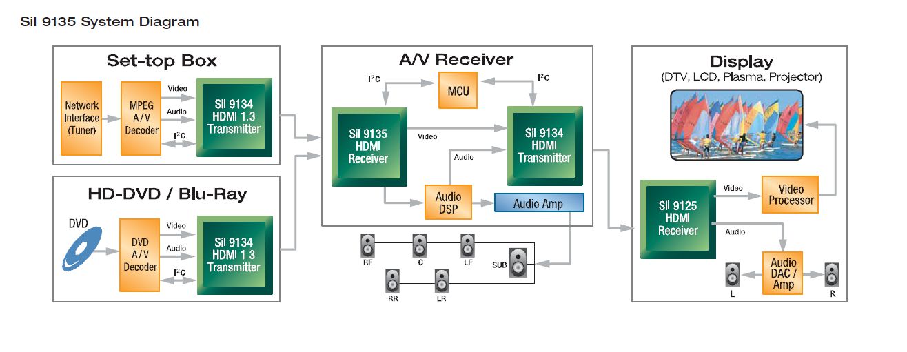

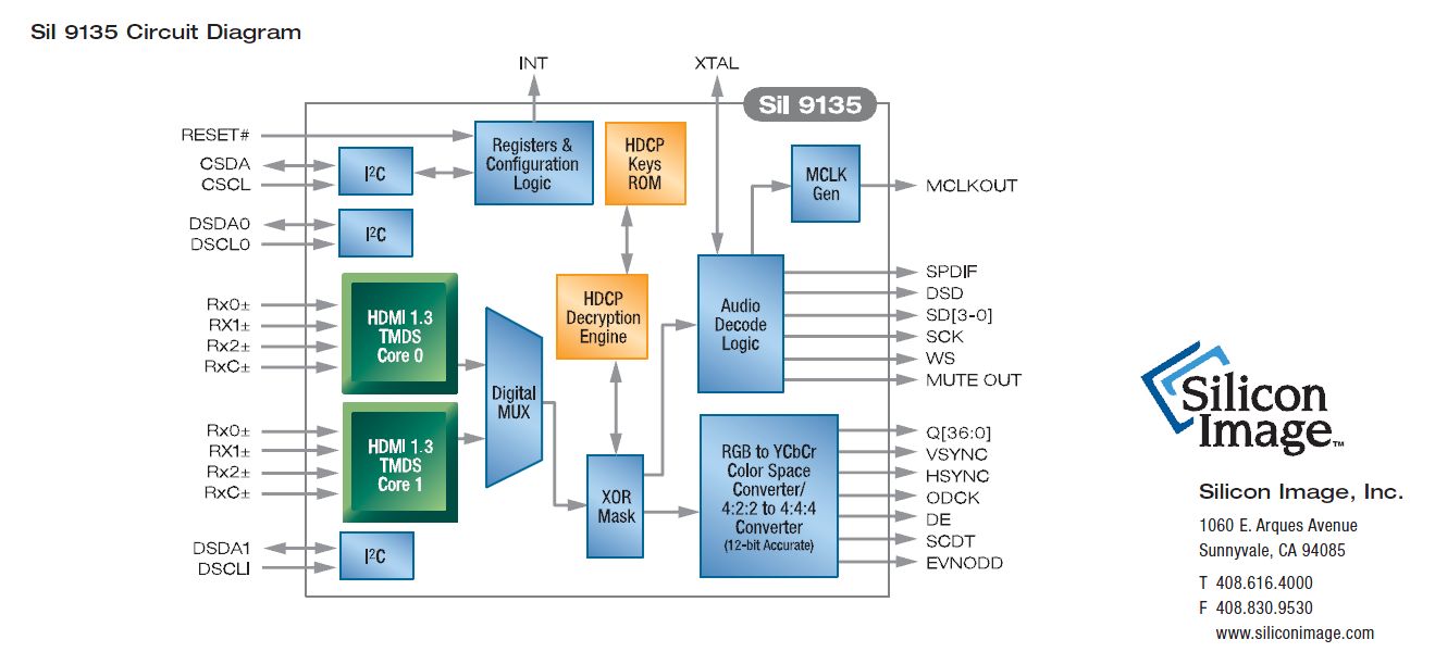

On the other hand we have dedicated HDMI chips like the Silicon Image Sil9135 HDMI Receiver. Actually, the Sil9135 is more than a receiver because it decodes all audio formats, providing the four I2S lanes required in 7.1 audio. The Sil9135 would releave the DM8147 from decoding audio. Doing so, the DM8147 solution may seem overkill, but remember we need lots of I2S lanes : four for inputting the decoded audio from the Sil9135 (if wanting to post-process all channels), and at last two (in TDM) for outputting 16 audio channels. Need to check if a NXP LPC43xx can do this, using the M0 and the SGPIO.

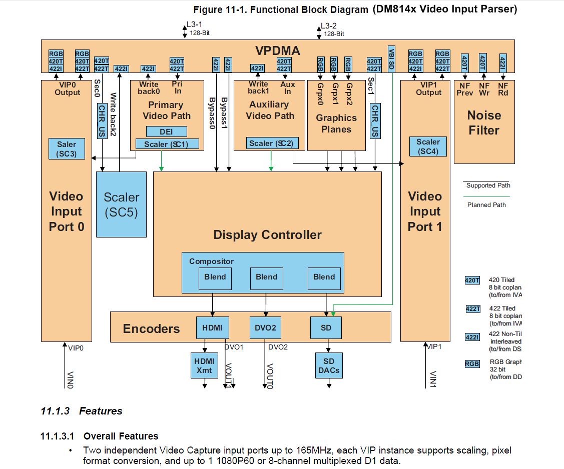

Another way is to try using the DM814x Video Input Parser in 3 x 8-bit bus mode (24-bit mode). This is the "Video Input Port 0" on the left side of the DM814x diagram. As result, using VPDMA, you automatically get some data in RAM formatted in RGB, 420T, 422I, or 422T, that you can process. Up to you to descramble the data (what if HDCP ?), locate the audio, extract the audio, and decode the audio. All "by hand", using your own algorithms. Don't care the video data, it doesn't need to be processed.
I confess the 24-bit approach is not compatible with the HDMI 1.3 "deep colour" mode, but who cares at the moment, with no movies encoded this way ?

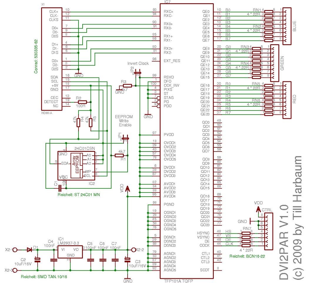

Till Harbaum has a DVI to 24-bit parallel adapter, using a T.I. TFP101A chip.
See his website : DVI2PAR - a video HDMI/DVI decoder for the beagleboard
This is exactly what I would hook on the DM814x Video Input Parser, in 24-bit mode.

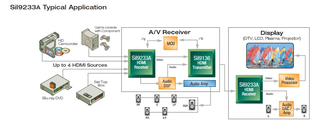

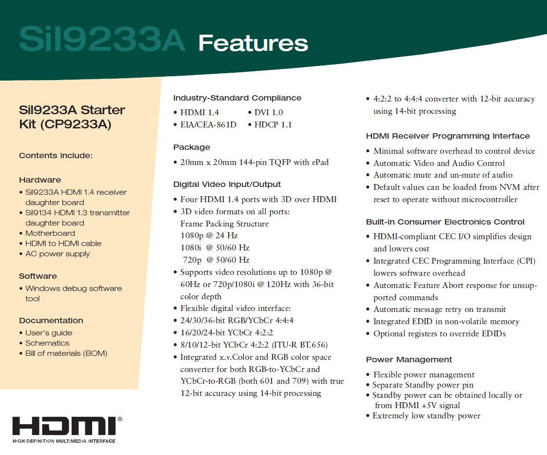

Another dedicated HDMI chip is the Sil9233A. Looks very tempting with the built-in four HDMI inputs. Digital audio comes out using four I2S lanes. Even if currently the Sil9233A is subjected to a Non Discolsure Agreement, nobody prevents you from hooking a DSP56374 on one or two I2S lanes it is delivering. If the Pioneer VSX-S300 or VSX-S500 HDMI AV receiver have a Sil9233A inside, I'll buy one, listen to it, then convert it to digital multiway by hooking a DSP56374 on one or two I2S lanes it is delivering. I think such intermediate step is needed before moving to a more advanced project like building a "handmade" HDMI sound decoder, from scratch, using a DM814x chip.
