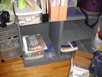

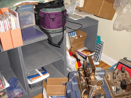

In the past I've moved quite frequently, so I built a place for my dj decks made of mdf. The top is a solid piece of 3/4" mdf, and the base is made of 1/2" mdf.
I've never had any problems with resonance, or with finding a place to stash records, amplifiers and what not.
Since I no longer dj, my wife now uses it as craft storage... bear that in mind with the pics:
