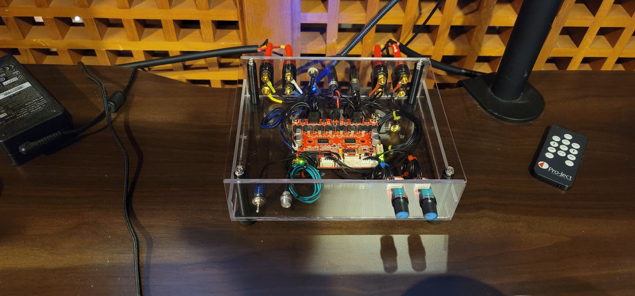

Slightly off topic, I just finished a 2-way desktop TQTL using a KABD-430 (Wondom J4, I think). It's cool for a budget, mid-fi solution but for serious listening I'm definitely wanting better. And to my credit, I was able to keep my computer speakers under 40 lbs (each)! LOL

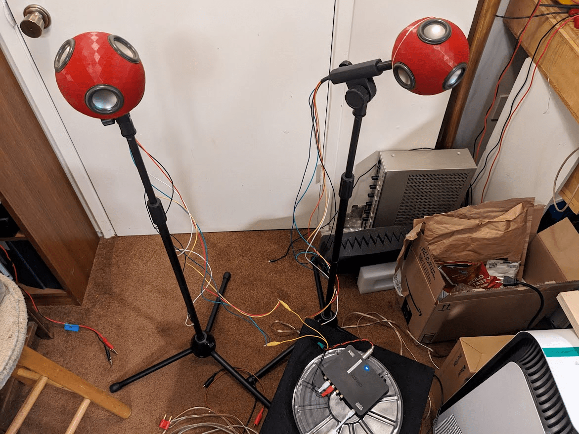

I think modular in my builds and target about 25 lbs for each piece to keep my back happy. The current project is a two way of sorts with a 4" diameter spherical mid/tweet and a cube with a 10" woofer. The miniDSP works great for the crossover and compensates for the variations in the sphere response in the top end.
The spheres can use three channels of DSP if I want variable dispersion, omni, dipole or cardioid patterns. So with the woofer that's four channels of DSP per side. There's probably a FLEX 8 in my future. Hypex doesn't have a four channel plate amp.

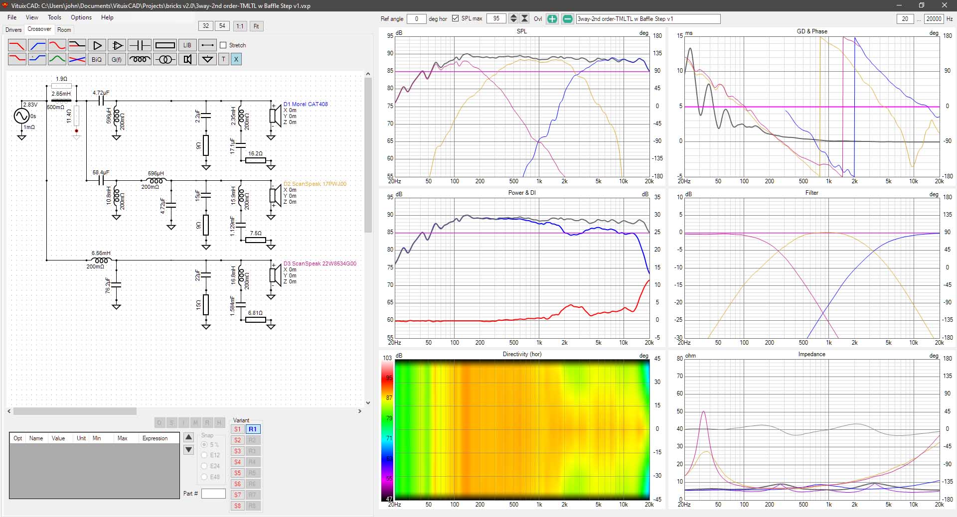

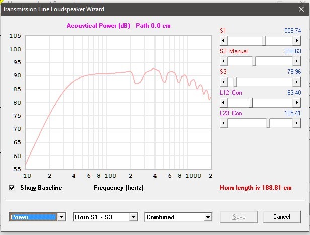

That makes sense. I originally selected the drivers with the passive crossovers in mind, so they seem pretty amenable to that: Morel CAT408 (of the three drivers, I am least familiar with the actual sound of Morel), ScanSpeak 17PWJ00, and ScanSpeak 22W/8534G00. Running them through a quick sim in VituixCAD, I get very simple LR2s without any obvious need for anything crazy. Of course, theoretical sims don't mean much and I'll have to measure the drivers, in-hand, once they arrive. The ScanSpeak drivers I've heard over the years sounded well-behaved, overall. I'll be putting the 17PWJ00 in a 28 litre sealed box. I considered some kind of OB configuration, but my listening environment is my weakest link and I can't do much about it (It's a solid concrete building in Okinawa). I'm still poking around with the figures for the TQTL for the 22W/8534G00 in Hornresp. But very quick 'n dirty, Hornresp modeling (which obviously still needs work) shows adequate low frequency extension -- at least for my needs/environment.
Oslond3, I love them! You have spheres! That's spectacular! What's the material? How did you make them? Either way, super cool.

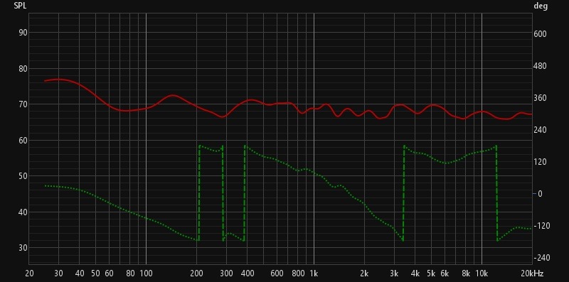

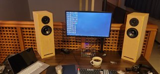

Here's the desktop computer speakers I finished last week (with KABD-430 and the little plexiglass box I made for it). Still tweaking FR with the DSP and I'm obviously not done with the cabinets (paint, and I'll be sticking a .25 inch felt sheet into the front baffle). No one will ever accuse me of making pretty speakers. 😆 The SPL graphs aren't obscene but still need dialing in. Can you tell I live in a concrete box? LOL
