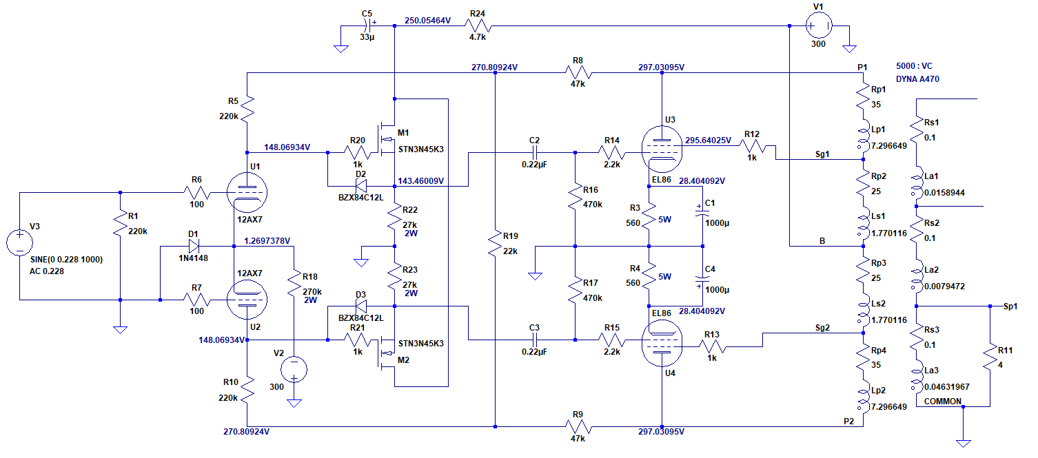

Here's the Baby Huey EL86 circuit I was thinking of building:
The phase splitter/driver stage (12AX7 LTP) has to work from a measly 300V B+. That looks like a limiting factor. So I got to thinking...
I have a couple of 700VCT 40mA power transformers. I could use one to get about 430V for the B+ to the phase splitter/driver stages, but still use the beefy isolation xfmr for the output stage 300V B+. But to do that, I'd have to abandon the Baby Huey's clever feedback loop arrangement and go with the traditional single stage inverter/'anode follower'/plate-to-grid feedback arrangement. With 300V to the output stage and 430V to the driver stage, I came up with this:
This would be my first build with a shunt feedback output stage. I'm hoping to get a more 'push-pull triode' kind of sound but with a nice 15W max from the pair of EL86s. I'd be very appreciative if anyone cares to give that a look and let me know what they think.
Thanks!
That is an interesting circuit.
The parallel impedance of a 12AX7 plate, rp; that is in parallel with 330k RL . . .
Is that low enough to drive the MOSFET gate capacitance all the way up to 20kHz?
(I did not look at the MOSFET capacitance curves versus voltage).
Because of the LTP cathodes, the plate impedance of the 12AX7 is pretty high.

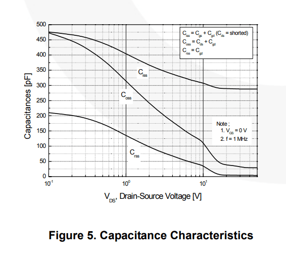

The mosfet depicted in the second schematic has a Crss in the less than 3 pF range for any Vds over 40 volts. My previous experience with 6CW5's and UL84's (a 45 volt 6CW5) tells me that they work great with 340 volts or more on the plate and 170 volts on the screen. That rules out UL though. I have a guitar amp that runs everything from an isolation transformer. Heaters are series wired from bridge rectified and filtered 120 volts as are the UL84 screens. The output plates get 340+ volts from a voltage doubler on the same transformer. Power output is about 20 Watts.
Will the 6N43P-E (EL86) burn up running UL with 270V from its plate and screen grid to cathode?
Will adding 1k screen stopper resistors in series with the OPT primary screen taps keep the 6P43P-E screens from melting down at that voltage, if the plates are also at about 270V plate to cathode?
For MOSFETs, I have ZVN0545A or FQP2N60C rattling around in my parts bin. Both have Crss around 4pF at Vds of 25V or higher.
For FQP2N60C:
