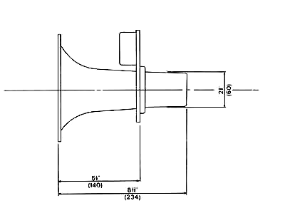

I am tempted to try building from scratch a replica of the old Decca ribbon tweeters - though the horn loaded version.
To that end I am wondering if anybody has information on the geometry of the horn - with a view of getting it 3D printed… better still if there is an STL file for such an animal in existence – the STL file being essentially a digital 3D model of the object to be printed.

I’d guess it is exponential.

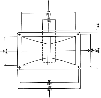

These are a good start, i hav eno top viw but i have a picture that is not bad (needs processing, poke me if i am too yardy getting it posted
attachment.php
attachment.php
dave
