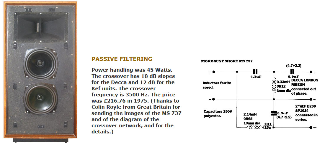

Pictures of one of mine:
Page that comes from (mine)also links to the same site Galu referenced.
And here is something i found on my HD that might be useful (i am sitting on 16 B200s),
and just to keep it in one place the XO i posted in the thread rayma linked.
dave
dave
