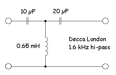

I've been mulling the filter over...
Dave suggests this as the 1.6kHz high pass:
I've been scratching my head over 1.6kHz for a 15 ohm 12" woofer.
This is an 8 ohm eminence PXB2-2k5CX 2.5kHz jobbie:
Using coaxial products for DIY monitors and home hi-fi applications
So for 1.6kHz and 8 ohms, 3mH and 15uF makes sense to me. Convert to 15 ohms, 6mH and 6.8uF... and negative polarity between the drivers.
Well, I tried modelling it, and I got around 6.8mH and 6.8uF. I expect you might put an ohm or two in the shunt too.
What does everyone think?

Let's reiterate that for the 8 ohm Decca London ribbon, this is a workable 1.6kHz circuit:
I think you could use 3X 10uF there. Put two 10uF in parallel to get 20uF. The coil could be a convenient 0.56mH or 0.68mH aircoil.

Many thanks. While I am quite happy carrying out straightforward repairs on valve amps - I have never thought about the characteristics of x/o components, so please humour me when I double check I am buying the right bits!!
From the Impact Audio site - parts 5011, 5031, 3810, 5229
and reverse the polarity at the tweeter?
Cheers - Roger
Cheers - Roger
One x-over made and fitted. Took me back - it was probably in the 60s I last re-jigged a circuit diagram for stripboard! I have been repairing old valve amps for years, ancient enough to be wired point to point, so it was interesting. Anyway, the results are very promising - vocals have come forward just that important little bit. In fact Sheryl Crow climbed out the speaker and whispered in my ear - that was nice.
