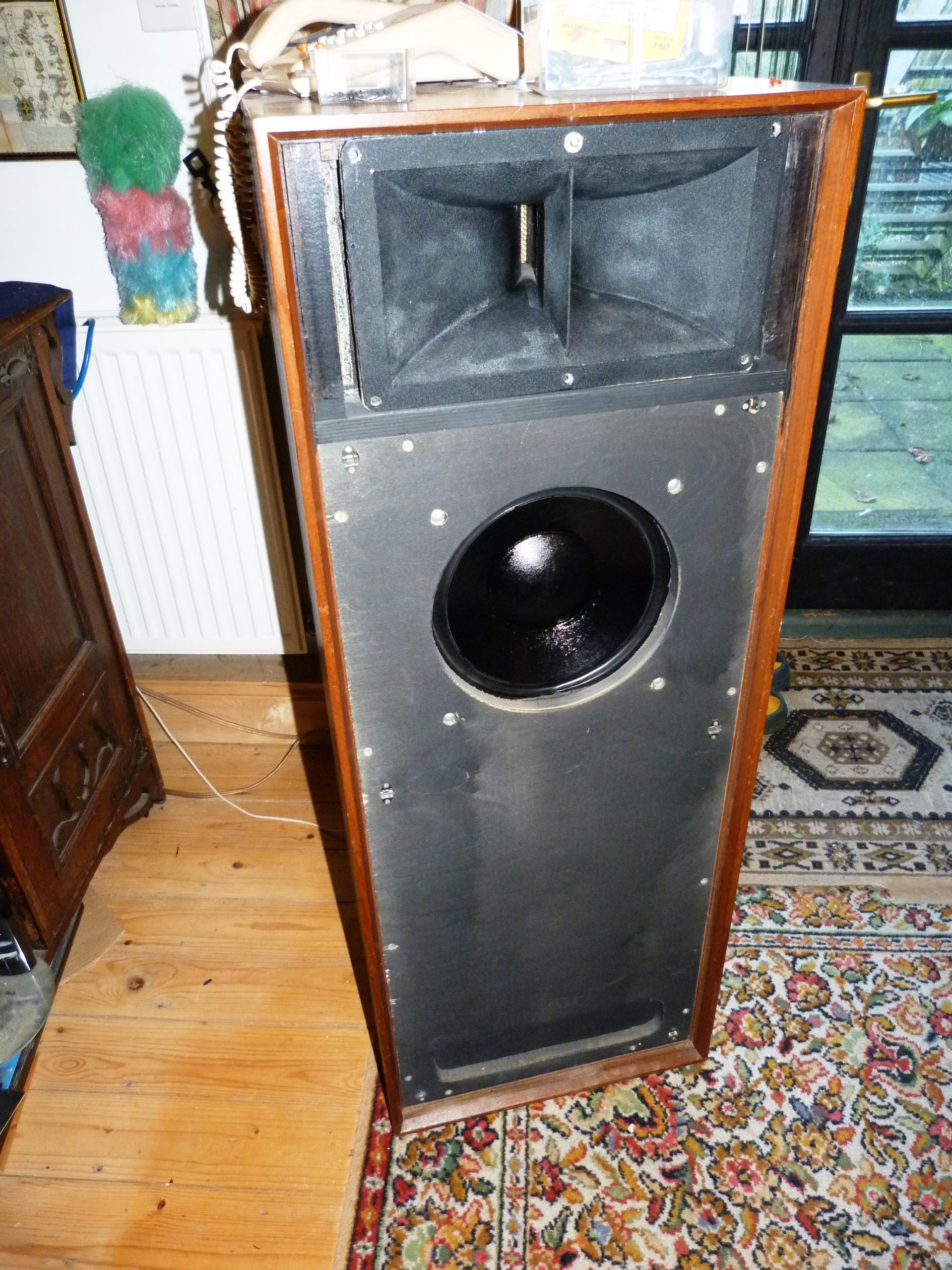

I have recently acquired a pair of Decca Kelly ribbon tweeters (I already have the DK1 bass drivers). I bodged one of them into a Radford transmission line speaker with a cheap and simple Monacor 1st order x/o 2500Hz. A bit of research turned up this link Ribbon Tweeter Horn Loudspeaker: Decca London/Stanley Kelly - Efficiency, Size, Filter and Frequency Response.. The DK ribbon is astonishingly clear and I am encouraged to try the Decca x/o detailed therein with a x/o frequency of around 1000Hz. It seems simple enough to source the NP (?) caps. But I am confused by the characteristics of the 1.3mH and 650uH inductors which are available. What should I look for in terms of component values to ensure I get the right ones? Is it even a good idea? The amp doing the driving is a Radford Renaissance STA35.

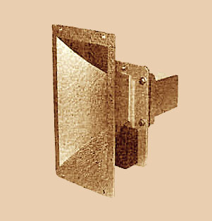

The picture you show is the Decca London that is supposed to go as low as 1KHz.
The Decca Kelly is smaller and is specified to 2.5KHz only:
Just to be on the safe side, I wouldn't go lower than TWICE the spec's.

The DK1s are 12" - I think the 12" drivers in the t-lines are Goodmans - fairly sure Arthurs Radford and Bailey favoured them in the early models. The DK1s measure 15 ohms and, yes, I would like to know how to measure the Londons.

The London can go to 1kHz, but is more often XOed at 1.5-1.6 kHz. Impedance is very flat so XO can be close to text book.
We got a chance to go at a set of Decca prototypes with an 8” paper driver and the London XOed at 1kHz. They were fantastic.
The London is amongst one of the best tweeters i have ever heard.

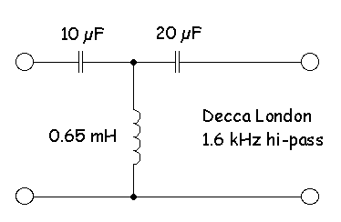

Thanks Dave - that appears to be the high pass bit of the one in the link (which connects notionally to 8 ohm drivers). Would that present a problem as the DK1 bass drivers are 15 ohm? Did you just use a high pass filter - or the low pass bit as well? Should I worry about the impedance of the London?

A 12" bass has little useful output above 2kHz in practise, so planet10's (Dave's) 1.6kHz tweeter filter looks good to me.
Only issue now is a guestimate of values for a 1.6kHz filter for the 15 ohm bass. It's going to be a biggish coil around 3mH and a shunt of around 10uF I suppose. Plus some fiddling with a tank notch around 2kHz in my estimate. I think I'd want to model that!

The XO i posted is only the HP. You have to come up with your own LP.
