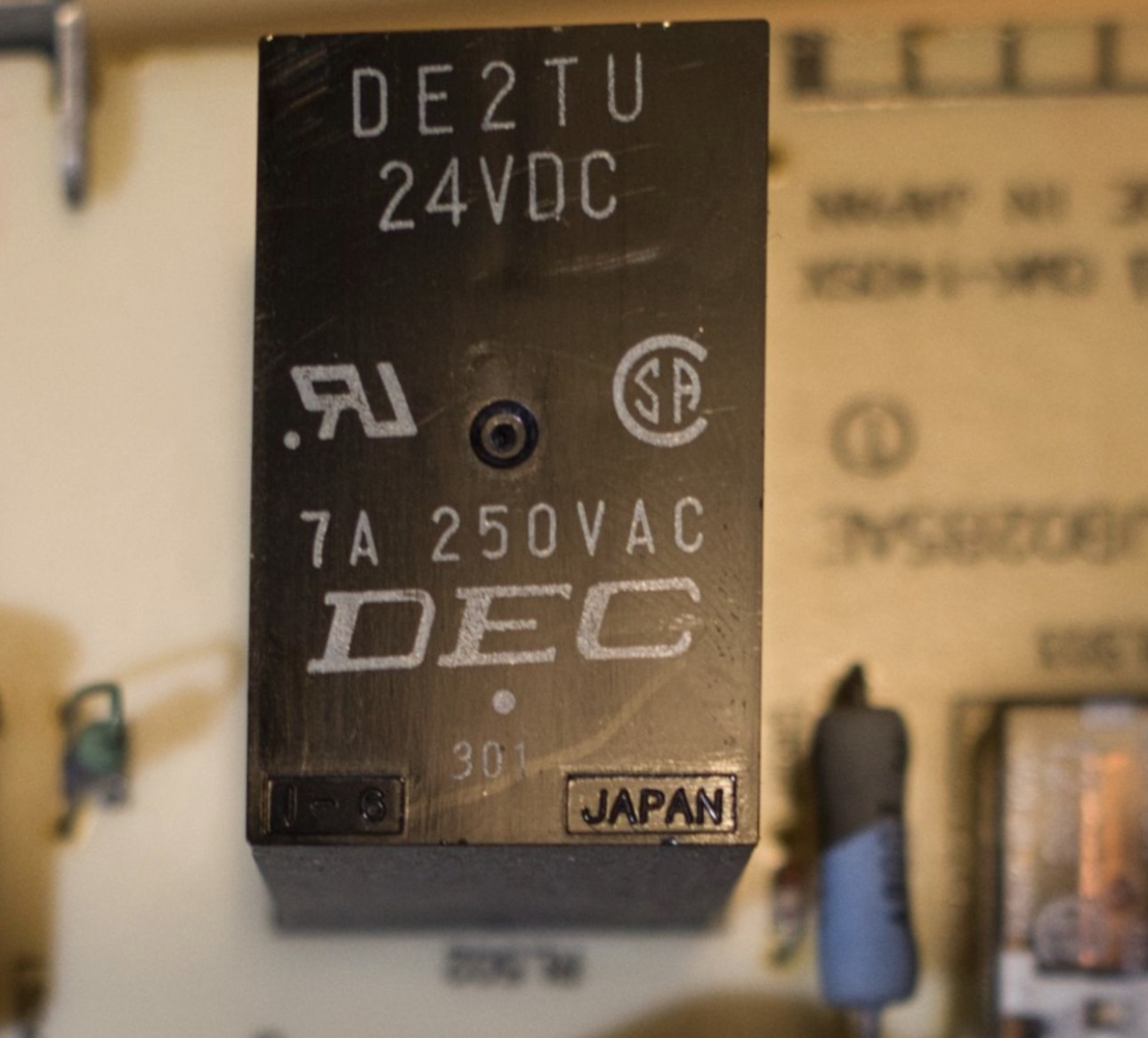

Does anyone know a replacement relay for DEC DE2TU 24VDC 7A 250VAC? DEC don't make them any more and they have removed the spec sheet from their japanese website. Has anyone done this before? Thank you.

Here is the photo, I know it has 6 pins underneath. I got nothing else unfortunately. DEC use to have the spec sheet in Japanese, but they have removed from their official website. I’m guessing it is because they don’t make it anymore. Is this enough information to find a replacement? I did some research on the web, some people suggested Omron G4W 2212P-US-TV5, but not 100% sure, what do you think? Thank you.

Looks like a 24VDC coil, with contacts rated at 7A at 250VAC. We also need to know the dimensions, the pin spacing, and maybe the diameter of the pins. It may be that Omron G4W-2212P-US-TV5-HP-DC24 would be the same in those regards.

Here (very slow page because cached) a DEC DE2TU-24VDC was replaced with a Panasonic JW2ASN-B-DC24V working flawlessly.
The vinlyengine forum references a DEC DH2U relay, not a DE2TU. The Panasonic substitute is not a drop-in replacement for the DE2TU since the pin spacings are different. I have not checked the electrical specs for differences. The DE2TU specification is attached.

Edit1: In this thread it's shown the Omron G4 W-2212P-US-TV5 as replacement.

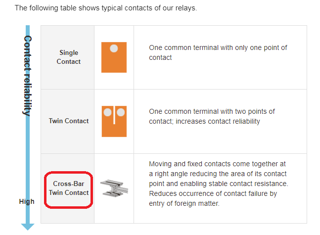

Edit2: Here the datasheet for DH2TU.
I's is described as "DH2TU is ideal for audio system protection" and 2 poles, crossbar twin contacts.
"The crossbar twin contacts have two contact points and have the advantage of a crossbar shape, making it suitable for opening and closing microloads."
So it has higher reliability compared to single or twin contact(s) and the same pin spacing.

The Omron G4W looks like a good replacement. The DH2TU is rated for 3 Amps while the DE2TU is 7 Amps. The PC board hole locations also do not match. A relay suitable for microloads is not the best for speaker output connection. I would use the G4W, not the DH2TU.
Fully agreed, I posted some infos on DH2TU in order to somehow remedy my defaillance, but now we know it's not suitable at all even for different pin spacing.
Wow!!!!!!! Thank you so much @Bill_P for the spec sheet!! Awesome!! How you find it!? This is going to help a lot! So G4W is the replacement? I will try to source it and give it a try. Thank you @ulogon for your helpful input. I was thinking about Panasonic relay initially as well, but couldn’t find anything similar.

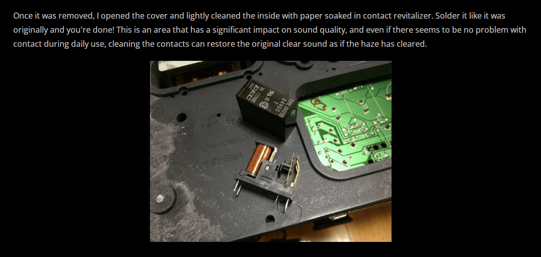

Hi @pinifinina, on second tought and deepening the subject please note that there is also the possibility that you can clean the contacts of your relays without necessarily having to replace them.
https://sputnik--dev-com.translate....l=auto&_x_tr_tl=en&_x_tr_hl=en&_x_tr_pto=wapp
The link above is from the same Japanese author and also explains how to do it (it seems that the cover of DEC relays is easily removable although the relays must be removed from PCB first).
Please note that in this second case the relays are DH2TU, but the way to clean them is the same as for your DE2TU. 🙂
