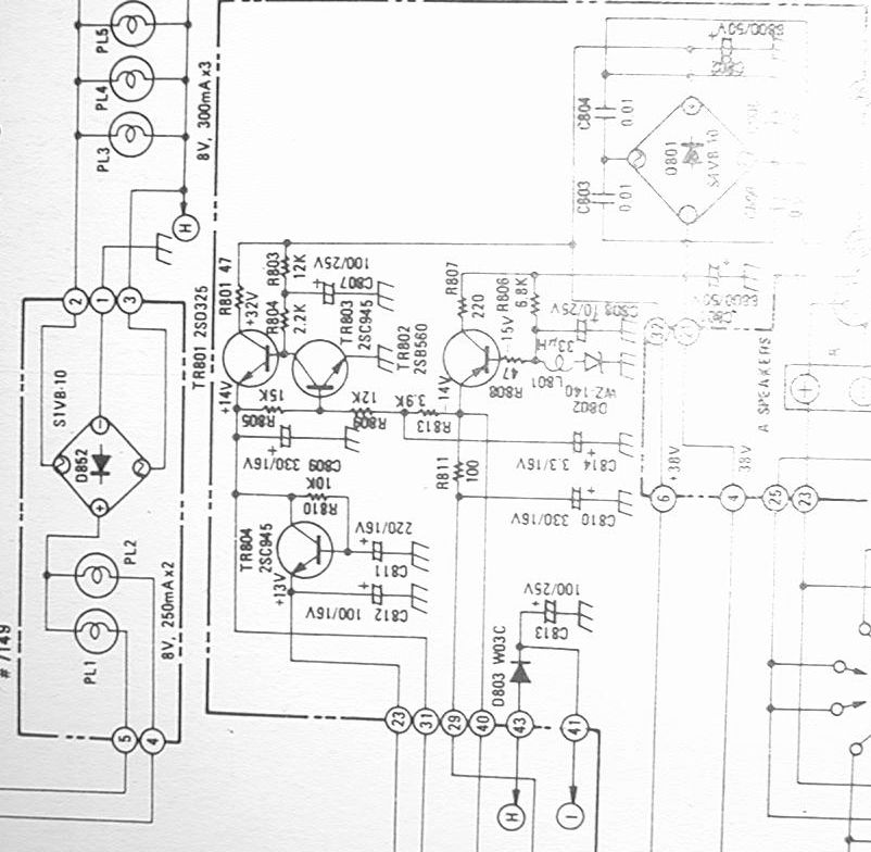

It is a Realistic STA-85. Attached is a closup of the regulator section which shown most of the values pretty clearly. To get a better overall I will have to wait until I can get to a flatbed and scan the whole schematic.
I am afraid it has been a loooonngg time since my EE classes so I am pretty clueless as to how this regulator works and I haven't yet had time to study it and figure it out. When I can devote a few hours to slogging through the circuit analysis maybe it will be clearer. In the mean time I need to disassemble a bit further so that I can gain access to all of the circuit elements and take complete voltage measurements and calculate all the currents and see what looks out of order. At that point I could probably access all the caps and at least replace the ELs.

Hi Mike,
Believe it or not, I have a very small schematic of that model! The regulated outputs should be -14VDC and +14VDC. Don't expect these voltages to be exact by any means. The 3.3uF caps can be replaced by 4.7uF, that kind of thing.
TR804 outputs +13VDC for your tone control section. This circuit runs on +13VDC only.

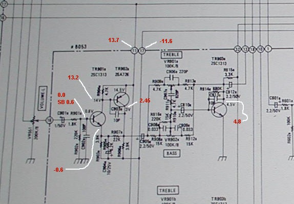

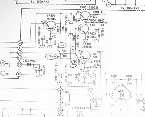

Did some more work on this
First thanks to all for your help.
It turns out that there is evidence of iced tea in this thing. 😡 I got some 91% Isopropyl and carefully cleaned the underside of the PCB getting all of the gunk off in hopes that the problem would clear up but to no avail. So I figured I might as well measure some more voltages before I start yanking out caps.
I am attaching pics of the schematic (preamp and regulator sections) with voltages noted. It does look like something is slightly amiss but they are not way out. The emitter of the input transistor should be at ground (and thus base at 0.6V) but the base is in fact at ground.
I also note that R811 in the regulator is listed at 100 ohms but is in fact a 220 ohm resistor. This resistor is dropping about 2 volts so the negative supply to the preamp section appears to be drawing about 10ma. Does that sound about right or a little high? Nothing seems to be getting hot.
mike

Hi Mike,
Your voltages appear to be okay (in the ballpark). Try to inject a signal at various points to see where things don't work.
A signal generator and 'scope would make life easier about now.

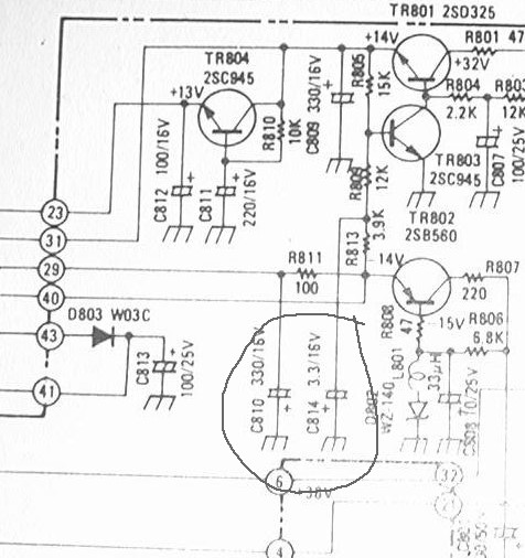

Thanks Carlos and Chris.
Carlos, do you want me to open the input to the preamp section or the power amp section?
Is one of the circled caps in the attached image the one you think might be dried out?
I was considering removeing the larger one and seeing what happened (would obviously remove some filtering but I thought that if it were leaking and causing the problem I should see a drop in hiss also). Is that the kind of check you were thinking of or something else?

C809,810,814. They are cheap. Just replace them.
You need to look at both supplies. The smaller cap is very important as well.

FIXED!
It looks like we have it fixed. I did use salvaged parts so I may have to do it again later but the hiss is gone and it appears to be working properly. I didn't have money for new parts until payday so I figured I might as well see what I could do with the stuff in my parts bin.
It is currently playing through my crappo polk computer speakers so I won't know how it really sounds until I connect to something better but I don't think that anything that I did could have caused the sound quality to be messed up.
I replaced the three caps suggested as well as C808. The new values are...
809 and 810 = 470uF
814 = 47uF
808 = 10uF
I also removed TR802 and cleaned up some gunk that was on the leads. While it was out I tested it. It checked out OK with Hfe of 117 so I put it back.
Before putting in the new (used) parts I cleaned the exposed top side of the circuit board with isopropyl since I could get in with the parts out of the way. Cleaning the entire board was out of the question.
So I don't know which part was failing (or if the cleaning did the trick) but I am gratified and grateful that we got her going.
I figure that if the problem comes back I will go in with new parts. At least I will know right where to go. 🙂

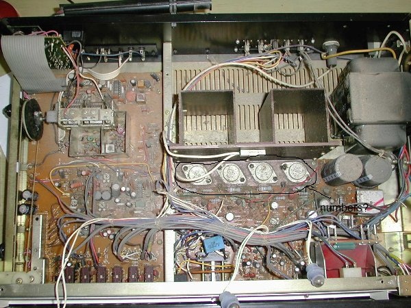

hello, a question: what are the number of the audio transistor, please i need this number.
thank´s in advance!
sorry for my poor English.

I did not see darkedge's question until Etocynned resurrected this thread. If you are still around and needing the info I can look it up but would need to know which ones you are interested in. Outputs?
