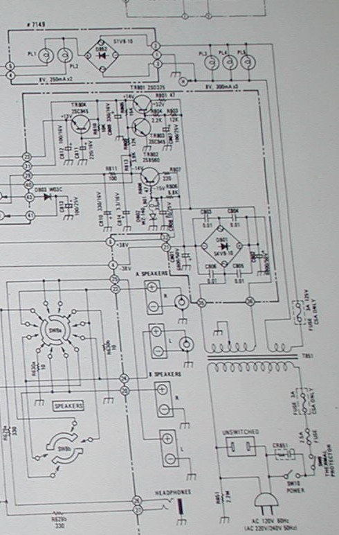

- PS is unragulated to the power amp and regulated with discrete transistor circuit for the other sections.

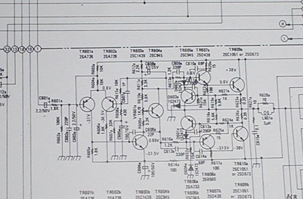

- Power amp is differential input plus one gain stage feeding what appears to be a quasicomplementary output stage with LC coupling to the speaker outputs.
- Headphone output is just a 330ohm resistor in line with the speaker output.

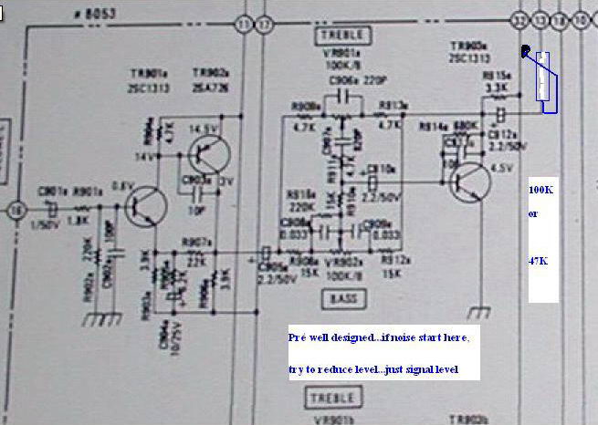

- Preamp has individual left and right volume controls (sliders). After the volume control there is an emitter follower type buffer followed by the tone controls including a CE output stage whice feeds the differentail pair of the power amp.
- Phono and tuner sections are all IC based.
The hiss occurs any time the power is on and is uneffected by volume control possition or source selected. The treble control and high filter that is located after the preamp do effect the quality of the hiss.

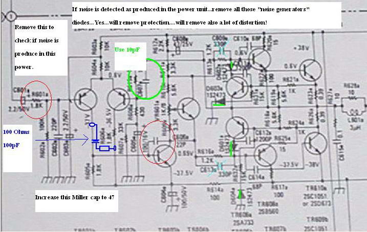

The amplifier may be oscillating supersonically. A 'scope would be really helpful here. If one channel becomes unstable, both channels may break into oscillation. Especially if the supply bypass capacitors have degraded.
Check to see if the resistors in the zobel network get warm or have been overheated. This is a sure sign the amp is or has been oscillating. I don't think there is much use in wholesale replacement of parts until you have some idea as to what is going on.

The reason that I think it is before the power amp is that the tone controls do effect the hiss. If it were in the power amp I would expect the tone controls to have no effect. The volume control is the very first thing in the preamp section (except when phono is switched in). Down stream from the volume controls (I agree here) but before the tone controls puts it right in the heart of the preamp section right? Or am I not understanding something here?

No, not at all. Given that most of the preamp is downstream from the volume controls what you say makes sense. In fact know I suspect you may want to focus on what lies between the volume controls and the tone controls, including the tone contol circuits themselves.
Tone contols usually involve capacitors. Electrolytic capacitors are a component generaly considered to have a limited life so I would put them high on the list of suspects. Resistors are probably least likley. Film capacitors are pretty durable as well. Ironicly resistors are the easiest to check (keeping in mind situations where there are parrallel resistors) in circuit while capacitors have to be removed.

We suspect something is oscillating - but what? Capacitors, as sam9 and I have pointed out, are the most likely suspect here. Resistors will generally not cause this.
Short the input feeding the amp section to ground, not on the amp side of the coupling cap!. The value of input resistance can make an amplifier unstable. Open input caps can do this. Anyhow, check if the hiss is still there. If so, the fault is in the amp section for sure. Keep in mind the tone controls may be part of the amp circuit.

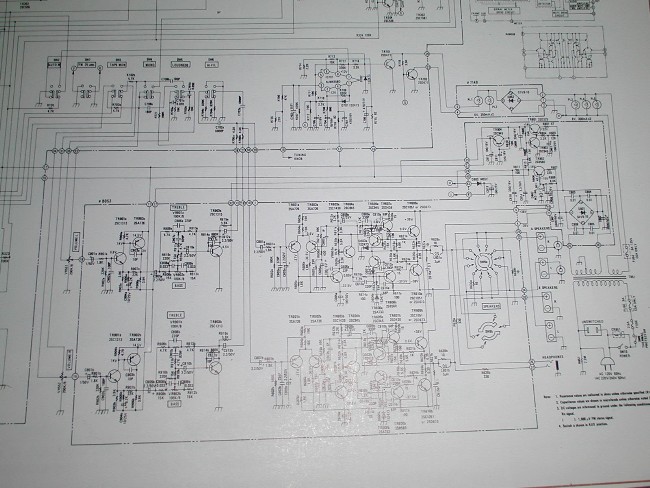

I am attaching some pictures of the schematic and the chassis for you to get an idea.

Most of the schematic

I had a few minutes today so I checked a couple of quick things. I shorted the input to the power amp (after checking for AC and DC voltage) and the hiss disappeared as expected. Shorting the input to the preamp section did nothing. So the Preamp or its power supply are still the prime suspects.
