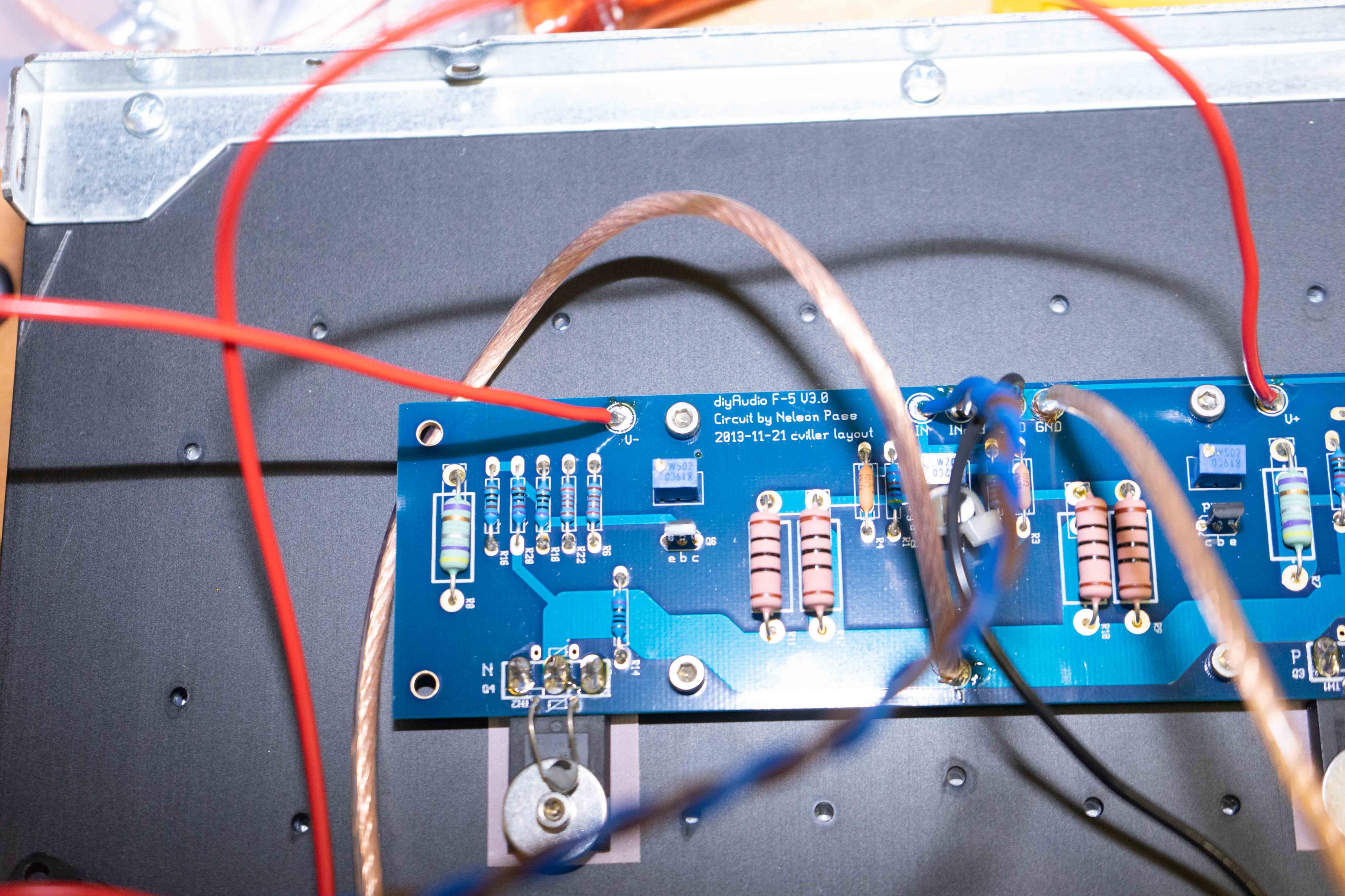

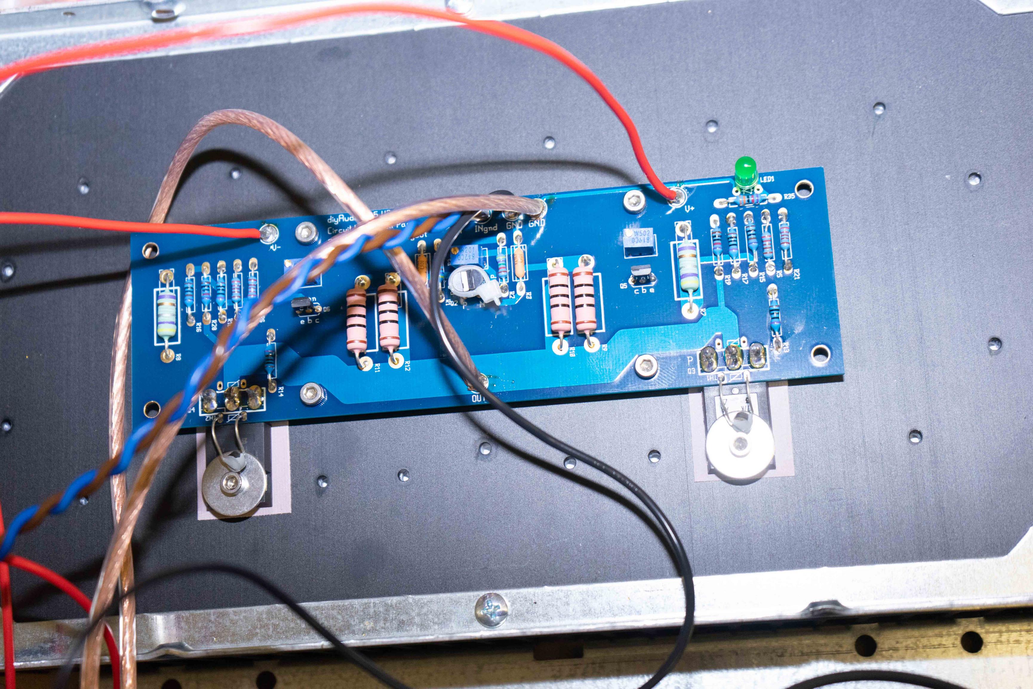

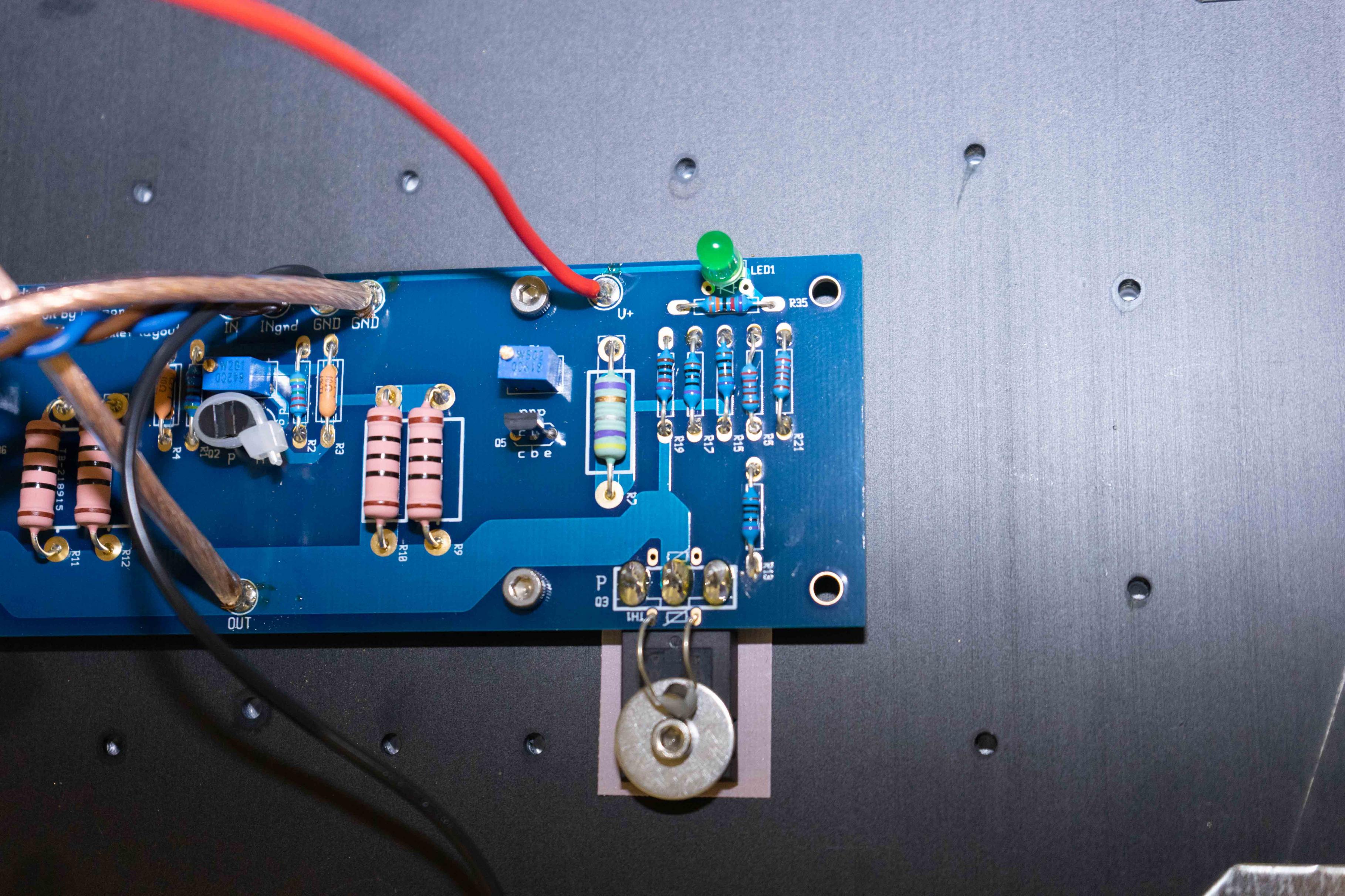

6L6, here you are. All pictures show the broken channel.
I actually tried some measurements following Zen Mod's advice. I did check for resistance between the heatsink and some components. First of all, I'm surprised that I do measure some 50 to 100 ohm of resistance almost everywhere (Mosfet pins, V+, V-) on both channels actually. But the main difference is that on the broken channel the source port of Q3 (P channel) shows almost no resistance to the heatsink (between 0.5 and 1 ohm). If I loosen the screw of Q3, resistance goes up to 100 ohm as well.
My expectation would be that there is no continuity between any component and the heatsink at all. Is this assumption wrong?
On the Mosfet's I installed one pad of Keraterm. Isn't this isolating enough?
Thanks,
Daniel

Thank you very much for all the hints. I've found the issue. It indeed turned out to be the thermistors touching the metal washers. I bent them further to touch the mosfet body instead. Couldn't find any further continuity between the heatsinks and any component.

This has happened to me, and it burned up a trimpot.
The problem is that the thermistor's coating can be easily scratched...in my case it occurred when removing and reinstalling the PCBs several times. The thermistors would just get scratched when handling.
I put heatsink over them now. Yes, they won't be able to react as quickly but that is fine.
