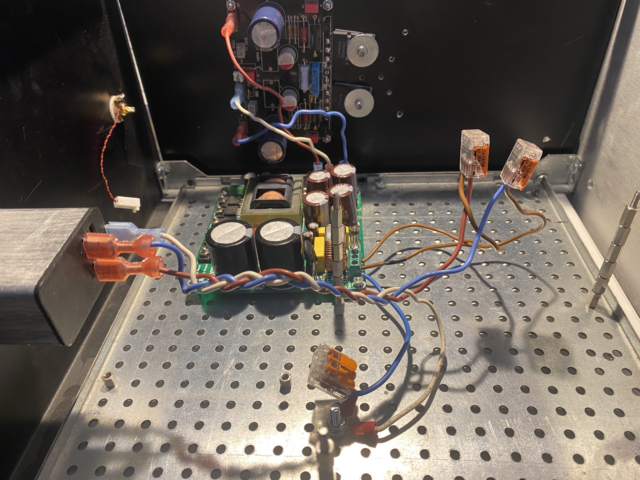

Still struggling with it. Replaced Q8 and now the board takes power alright. No hectic behaviour as previously.
Now the offset is 40mV and the pot is doing nothing to it. Same for bias – 0V and not reacting to bias adjusting.
No I do not have a voltage schematic.. Sorry.
But on gate of each mosfet you should have around 1.2V and 1.6V ... they are asymmetrical.
