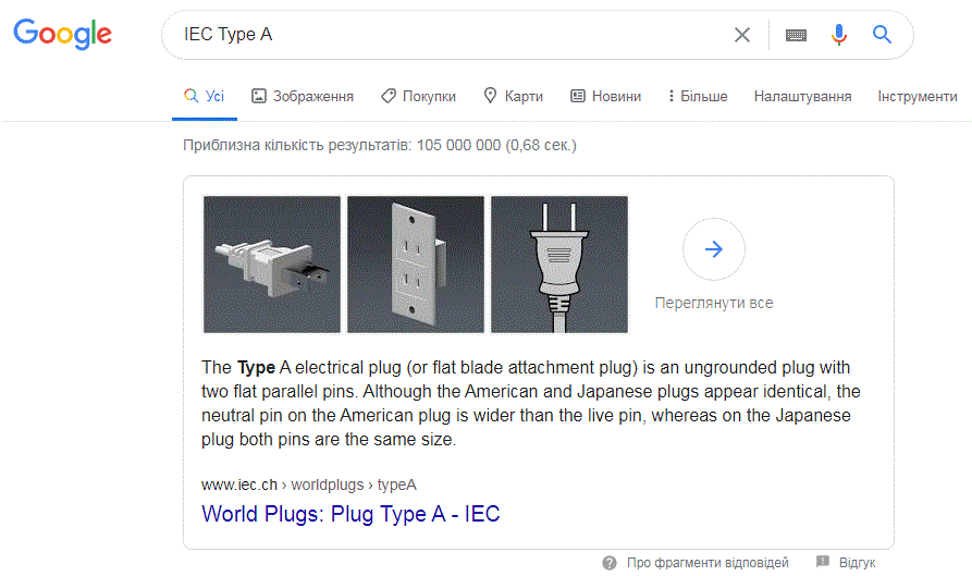

That's IEC Type A, not to be confused with 5.5/2.5 also named IEC Type A. Brilliant ******* standard.

AC power plugs and sockets - Wikipedia
Type letters are from the International Electrotechnical Commission (IEC) Web site[11] that provides classification letters similar to a United States Department of Commerce publication[12] that sees widespread but not universal use to differentiate plug and socket types based on rough mechanical compatibility. Most common household plugs have an associated letter.
Coaxial power connector - Wikipedia
IEC 60130-10:1971 defines five DC power connectors.[11]
Type A: 5.5 mm OD, 2.1 mm ID (with optional screw lock)
Type A: 5.5 mm OD, 2.5 mm ID (with optional screw lock)
