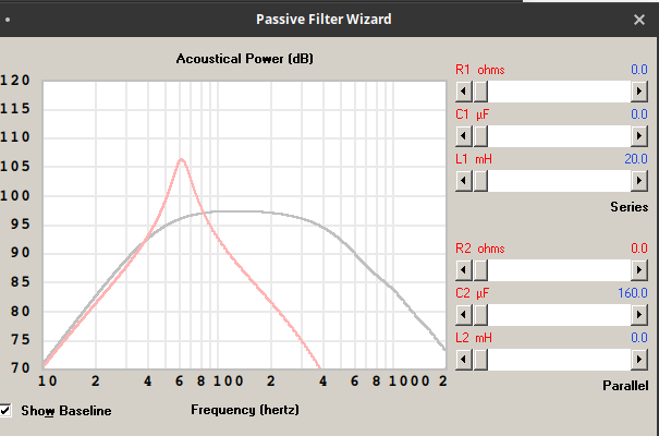

If hornresp is correct the really low crossover points needed for a 2.5 way system should lead to a pretty nasty resonant peak. I think I may have stumbled on a way to tame that. Here is a rather extreme example.
attachment.php

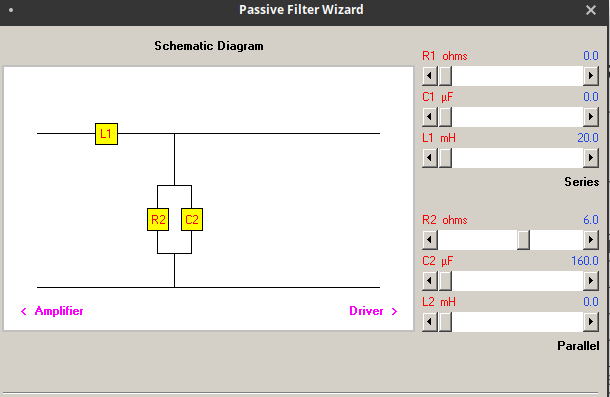

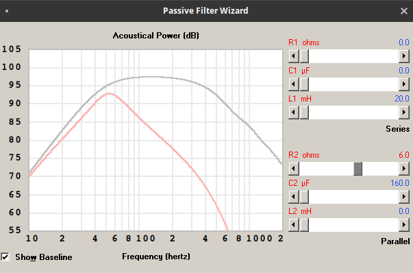

The suggested technique is a resistor in parallel with the capacitor (2nd order filter). By adjusting the value of the resistor you can get the lower part of the response curve to line up with the original pretty well at least in the simulation.

Is my barking centered around the wrong part of the forest?

The common solution is to remove the upper impedance peak (assuming its a vented enclosure). Connect a resistor, capacitor and coil in series and put that network in parallel to the bass driver. Search for 'RCL network' and 'impedance correction'.
2.5 way is usually used to offset baffle step, not to boost the lf response.
You can use it to extend the LF response downwards by rolling off your LP a bit earlier and take a slight hit in mid band efficiency, rather than fill up the lower mid bass with the .5 driver, as is done more commonly with a 2.5 way.
Many manufacturers want to build a slimmer speaker with multiple LF drivers to increase LF output capability, so instead of using the .5 to make up for baffle loss, its utilized to bump LF output capacity, which in most cases ends up being a bloated and muddy sounding speaker instead of achieving best mid bass linearity. This is something B&W tend to be guilty of as well as a few otherwise respected brands.
