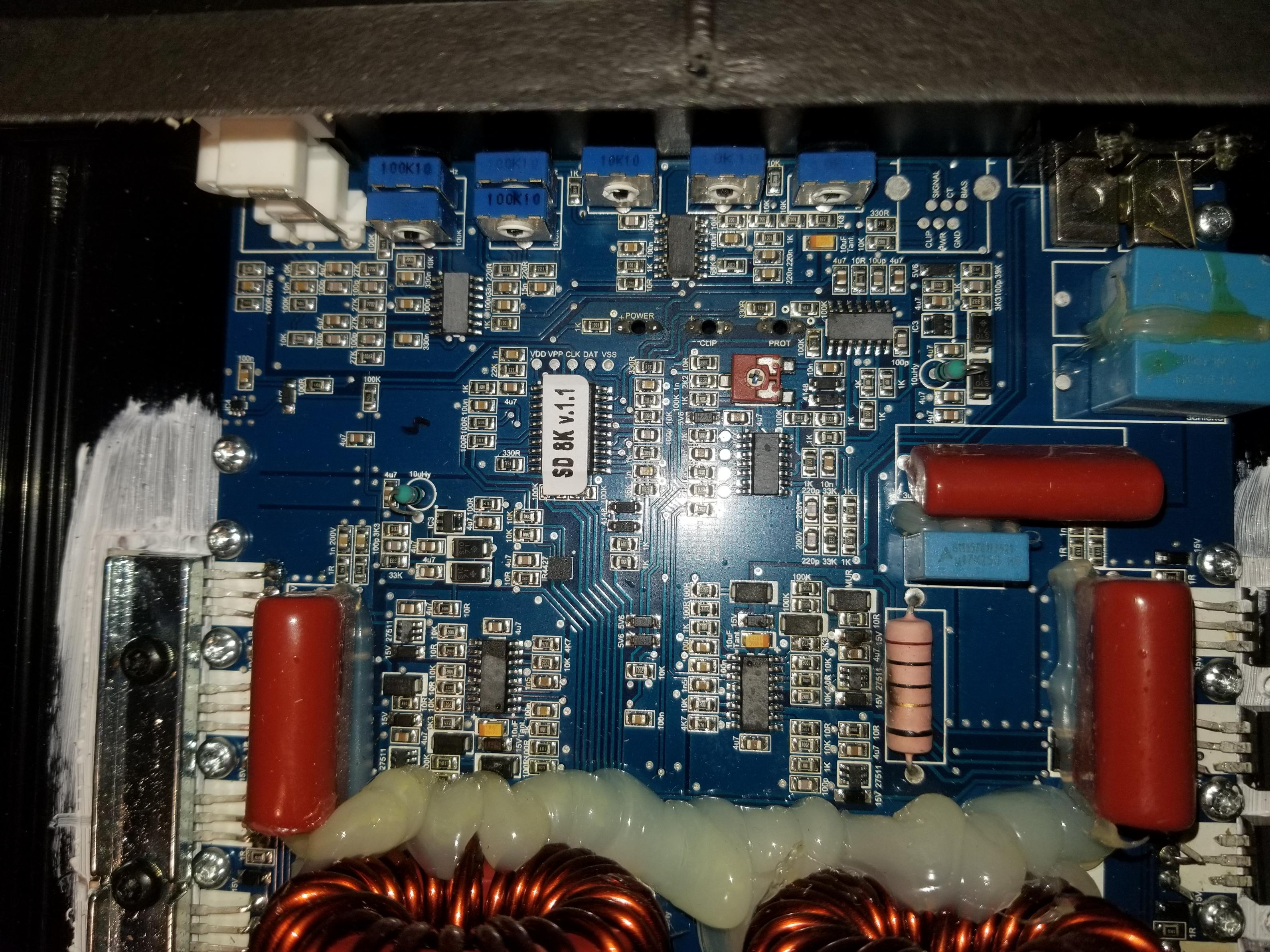

you will also need to check the drive chip and drive buffer ic. On the drive chip pins 1 you should get around 10v and pins 2 around 5v.If you do not get those voltages you will need to replace the chips
Here's a pic of the board.

I have a AAB 11800 defective here, but with replaced both driver IC's and 4 gatedrivers and mosfets, it started up with clipping led on. Railvoltage will come on after about 30 seconds, so check also the duty cycle of the gate of H3 power supply mosfets (just small peaks with the amp I have..). The systemcontroller (PIC 16F1828) is defective or see some wrong inputsignals.
All low voltage power supplies seems te be ok.
IRFB4321 should work. It's the same board as the Soundigital evo 12k , not very fine amps to work on..

Also see the pic that you posted you need to look at the components in front of it. Looks like there was a short there because if you look at the one side of the big 10 ohm you will see a black spot on it. if I was you I would first check those components in front of the resistor.
